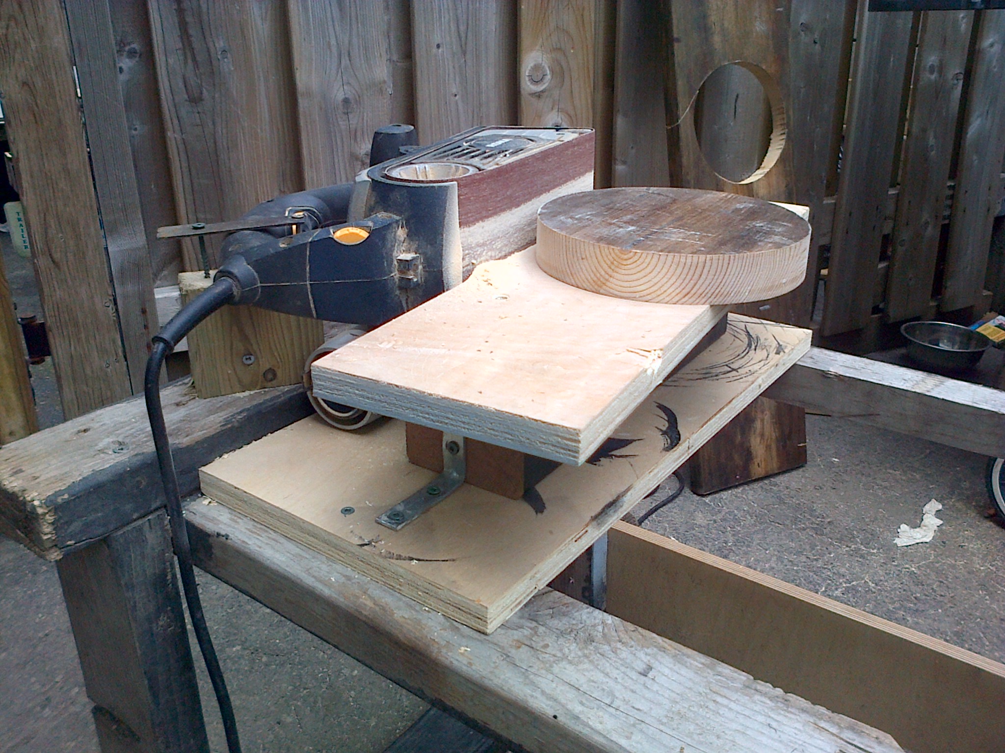

I have things ready to go Im just missing my circles at this point its putting my project on hold. If my belt sander was designed to mount on a 90 I could use my jigsaw to cut some out and true them up with that, no help there. Unless someone knows a trick way to do that?

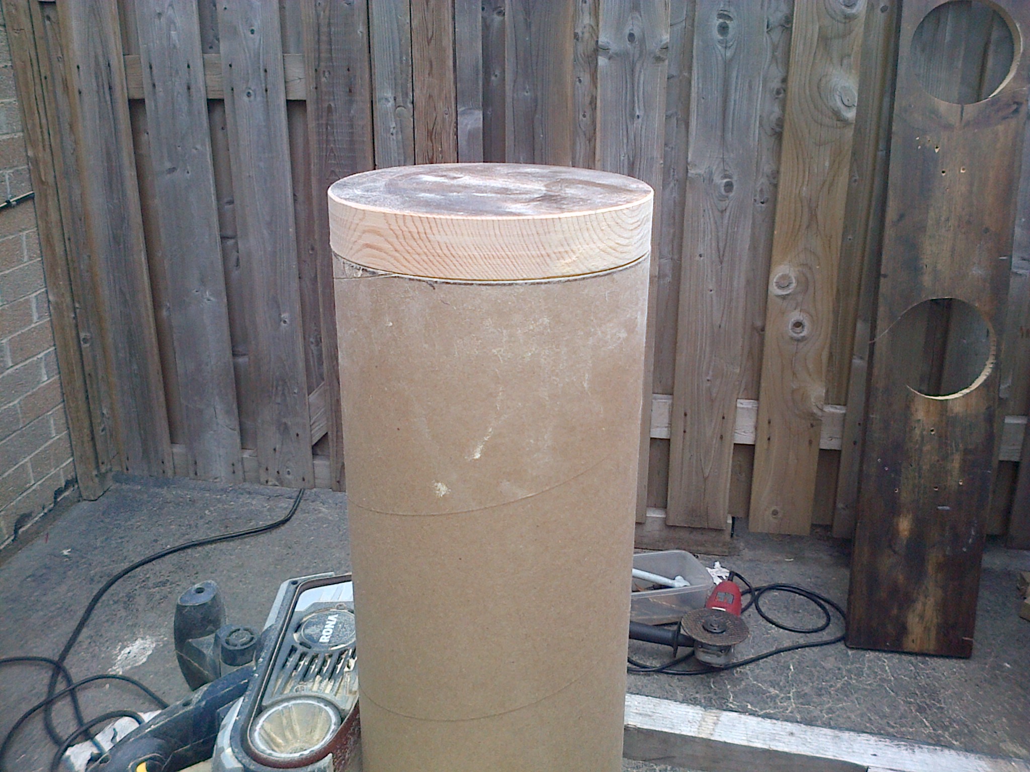

Ok back to saw talk 😀 the reciprocatiting kind that is. I thought it would be much of a pain to cut it this way due to excessive blade flex cutting this thicker material but it turned out pretty good with new decent quality blades. Thats the stuff that killed the toy router and I originally wanted to use. The blade flexed a little, but away from the stalk that Ill be using. And I left about a 16th all the way around both perimeters so I can clean them up with the belt. Im happy bout that cause a router didnt make the list this week. I think all that end grain showing will stain very well and have a nicer finished look if I dont decide to black it out.

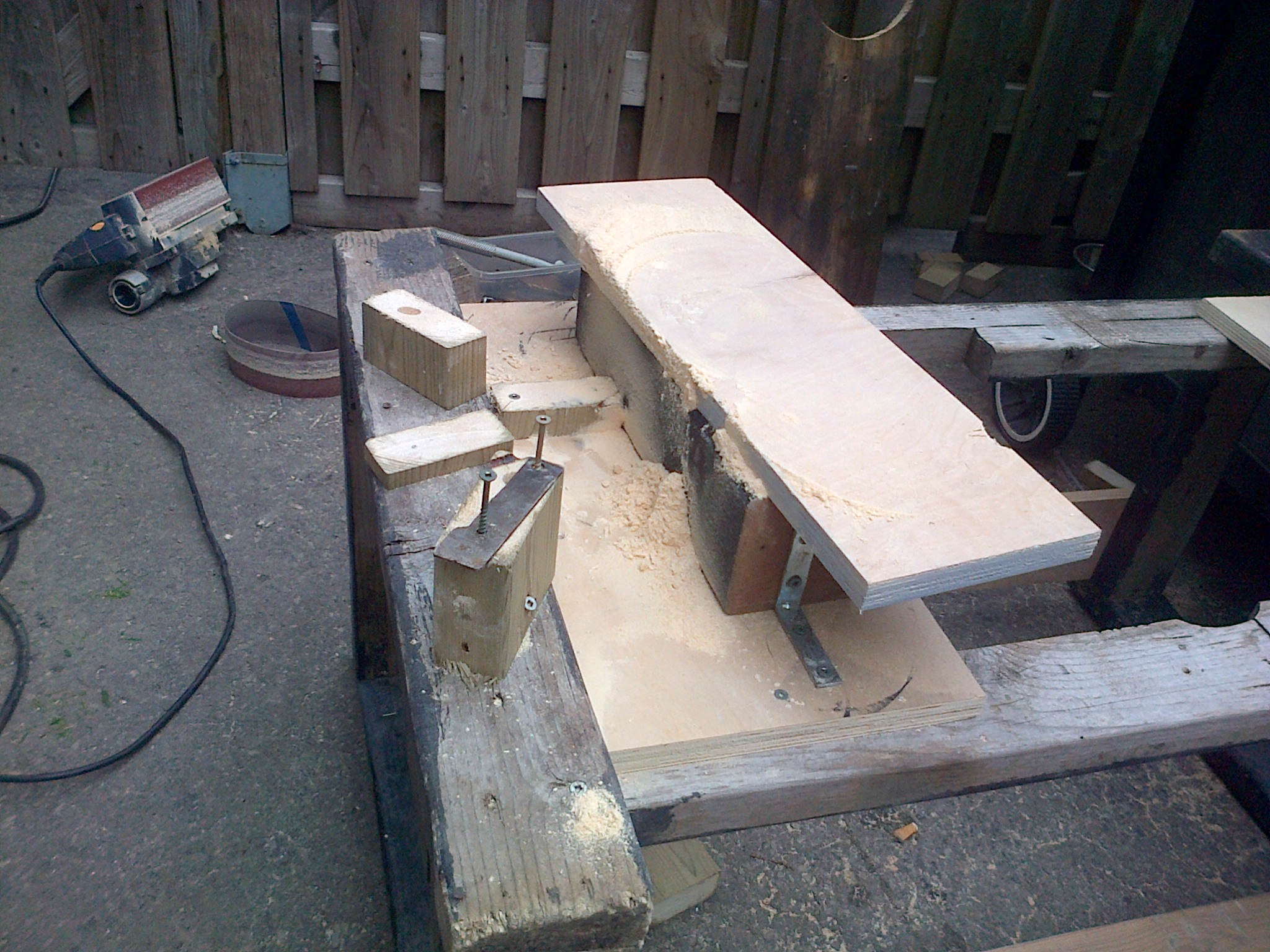

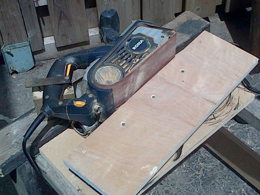

Mounting the belt sander is pretty trick, great idea in the link back there. It took me about an hour and some fense and decking scraps to mount it and I had have a 90 degree platform to finish them off.
