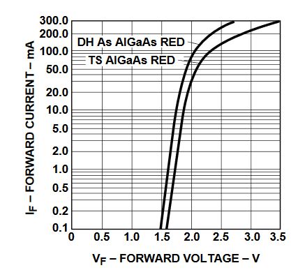

You could try an older type red LED (AlGaAs) with suitable current capacity e.g. a Broadcom HLMP-C115. These have quite low effective impedance (forward voltage / forward current curve attached). You could use 3 or 4 in series then adjust the EL84 screen voltage until you get the current you want (this is the technique SY used with his Red Light District). You'd have to make sure the peak current is acceptable for the LED you choose.

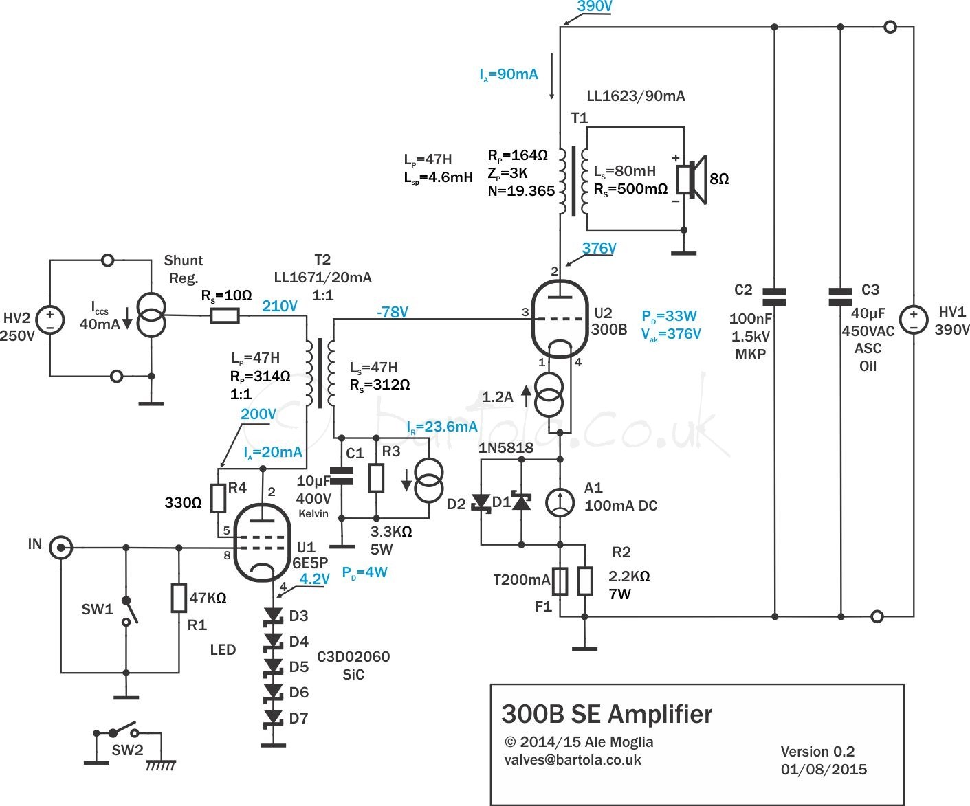

Continuing suggestions from Bass, a little custom great ideas for a pentode driver from Bartola valves.
D3A is here, but it's also very doable for EL84.
BTW, if I remember correctly, Thorsten used SV83 to drive 300B.
And yes, EL84 is superb driver. Cheked !!!
