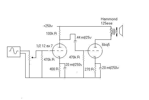

As part of the learning process, I thought it best to design and build a simple SE 6bq5 amp that may become a part of the 300b amp. I breadboarded this amp using DC power supplies for testing. It amplified the CD player.
I make no representation that I know what I am doing here. Perhaps with your review, comment and testing, I will learn a bit more. I need help with the capacitor selection, grid leak resister choice, OPT hook up, etc.
Your thoughts and guidance is greatly appreciated,
Thanks,
Rick
Thanks,
Rick
I'll try again
Let's see if this file will attach...
I have 2 Hammond OT 1627's also for my 300b when I think that I am ready. I could use them instead of the 125ese's.
I hooked something like this up on my tabletop with a pwr supply that was current limited. (I think the supply was limited to 5 ma?? Does that sound right?)
It played! But, really awful sound! I used some decade boxes for the load resistor and switched it around just for kicks...not much better.
Bought a Hammond power trans (215v, 269 ma)...hooked it up with bridge rectifier and sprague cap (200, 200v). Bad hum. Bad sound.
Just wondering and trying to learn, I truly hope this image works,
Rick
Rick

5 ma ain't close to enough if it's supplying the EL84 triode connected as you show and the 12AX7. You probably need more like 30ma or 40ma. If it indeed current limits the B+ at 5 ma, I'd expect this is why it sounds bad.
What are you doing with the EL84 screen connection? Tying it to the plate I hope.
Check and make sure your coupling cap is rated higher than 25V as shown in your schematic. More like 200V is what I would expect, the plate of your 12AX7 is going to be around 100V isn't it?
You need far more filtering than one cap coming off your bridge rectifier. That's why it's humming. Try adding a 100 ohm 20 Watt resistor in series with the B+ after the cap and then another cap after that (bigger than 200V please, more like 300V - same for the bridge rectifier.) The 215V power trans will give *way* more than 200V when hooked up full wave bridge. I'm suprised your filter cap didn't flame out.

One thing further, current limiting is not something you want in a B+ supply. You want the B+ to supply whatever current the tubes ask for.
Hope this helps!

Re: I'll try again
Hi Rick,
I pretty much agree with what Jeffs posted above.
Working from the output to the input.
Output stage: The EL84 will be pulling about 35mA at idle. What you have looks like it's straight off the datasheet. The 125ese is a 'universal' trans I think so roughly 3k5 would be a good place to start for the load impedance, as per the datasheet.
The EL84 cathode bypass needs a rating of 25V, but I'd go with a standard 35V for a bit of safety. To give a 10Hz corner frequency, the bypass needs to be about 125uF for 10Hz. Scale for other corner frequencies. With the value of 20uF you have the -3dB point will be 62Hz.
Output is good for nearly 2W at 8% THD, almost entirely second harmonic.
Interstage: The R and C form a high pass filter. With the values you have f= 0.77Hz. Quite low enough. The rating on the cap should be greater than the B+, so a minimum of 300V, and 400V versions wouldn't be a bad idea. The 470K is a satisfctory value for the grid resistor.
Driver: Just reading the datasheets, Rk should be 1k5, so Ia will be 0.68mA. Calculated gain will be about 60. Bypass cap should be 20uF/35V for the same 10Hz as before. I'm not telling you to use these values, but they will help you scale the value simply: more capacitance = lower frequency.
The EL84 needs 9.5V peak before it clips. The driver stage has a gain of 60, so the amp will clip with 0.16Vpeak at the input. This is too much gain, so you'll need that attenuator at the input. A standard CDP puts out 2Vrms (2.8Vpeak), so for full power this amp only needs a driver with a gain of 9.5/2.8 = 3.4.
I didn't include all the maths, but I can ad it in later if you'd like. Or you can read all about it here.
http://www.aikenamps.com/CommonCathode.htm
The 12AX7 example used is the same as your op points.

Hi Rick,

I checked the setup today; the filter cap was rated at 250V--as you say still too little.
Put in the pi section RC using 100 ohm at 12 watts (all I had lying around) and two caps (600 V, 10 mf and 40 mf). Changed the coupling cap to .1, 100 volts.
Still bad hum and the output at unity is very low. Perhaps bad rectifier for the hum. No idea why the low volume at the speaker.
Next step: Check/change bridge rectifier. check caps with cap meter. Troubleshoot with ocilliscope. Disassemble and start over using all new components.
Your suggestions welcome,

Hi Rick,
For two channels, I'd also prefer the 50uF you heve there now to be doubled.
Also; - replace the first PSU cap and the coupling cap. FIRST!
- check polarity on all the caps. Some cap types like electrolytics are polarised, ie they go in one way around. The +ve terminal should be at the PSU for the power supply caps with the negatives at the earth. The cathode bypass caps should have the +ve to the cathode end, -ve to earth. The coupling cap should have the +ve to the plate of the 12AX7 and the -ve to the grid of the EL84.
- tightly twist each of the heater wires together for each tube, keep them away from the signal wiring as much as possible, and if they must cross, do it at 90*.
- check all your wiring and connections to make sure there are no mistakes. Same with solder joints for bad/cold joints.
Finally, don't get too frustrated or put off at this stage. You're on a very steep part of the learning curve and problems and mistakes are inevitable. Once you ge through it sucessfully, the SE300B will be a lot easier from the lessons learned, and subsequent amps easier still.
Keep asking questions.
Cheers
I ran a quick simulation on PSUD2 and the voltage across the first cap is 308V, and the second (in the pi), about 302V. The cap you had in place, if rated at 250V will be toast. You need to replace it with something around 400V.fragman56 said:I checked the setup today; the filter cap was rated at 250V--as you say still too little.
A pi filter never hurts, but if you want 250V instead of the 302V you have now (assuming you replace the first cap in the PSU), you'll need to change the R from 100R to 1k6. If you are powering two channels from the supply, then the R should be 700R.Put in the pi section RC using 100 ohm at 12 watts (all I had lying around) and two caps (600 V, 10 mf and 40 mf).
The value of the cap is fine, but the voltage rating is too low. It needs to be the same value as the PSU voltage as a minimum. It might be toast too now.Changed the coupling cap to .1, 100 volts.
Until you have good caps in the PSU and coupler, then it's going to be hard to troubleshootStill bad hum and the output at unity is very low. Perhaps bad rectifier for the hum. No idea why the low volume at the speaker.
Good idea, but try to troubleshoot it before you go so ar as to disassemble the whole circuit.Check/change bridge rectifier. check caps with cap meter. Troubleshoot with ocilliscope. Disassemble and start over using all new components.

Rick,
Read this thread: http://www.diyaudio.com/forums/showthread.php?s=&threadid=8289
I posted a schematic and parts list for my version of the amp you're trying to build. It uses a 5755 as the driver, but a 12AX7 can be sub'd. It works, and sounds great.
