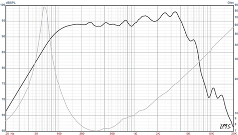

Faital Pro 8FE200
Fs: 80 Hz
Sensitivity: 95 dB (1 W/1 m)
Xmax: 4.7 mm
Nominal power handling: 130 W
Rear mountable
Cheap

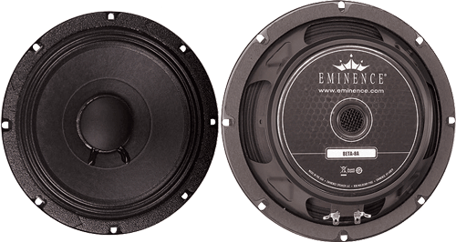

Eminence BETA-8A
Fs: 65 Hz
Xmax: 3 mm
Nominal power handling: 225 W
Rear mountable
Slightly expensive
Used by Jeff Bagby in the Fusion-8

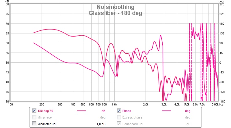

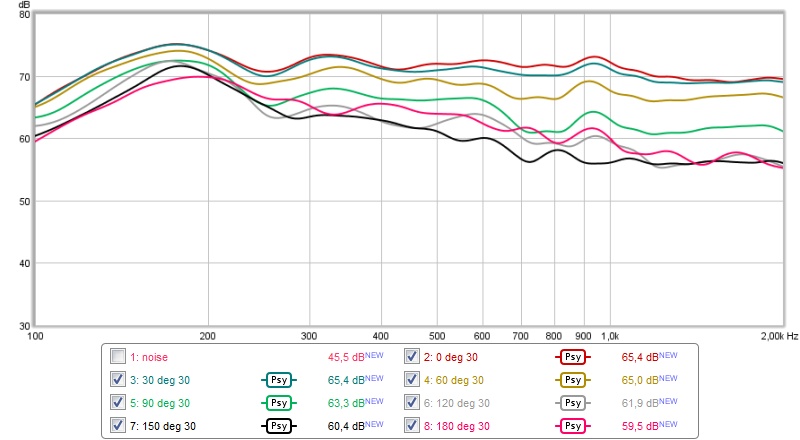

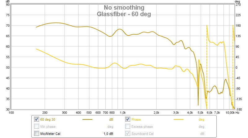

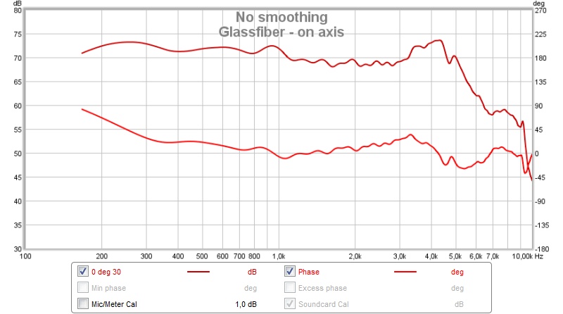

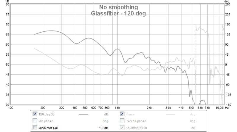

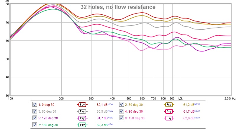

Measurements of speaker with glassfiber as flow resistance
Now I've done some measurements of this:
Response at 1.5 m distance, 1.5 m height (as before), 0-180° with 30 degree increments:
Compared to the earlier measurement (without flow resistance):
Verdict: Smoother response, separation down to 100 Hz, less of a hump at 180 Hz.
Here is phase response (gated 5 ms) for 0-180° with 60 degree increments:
Nothing strange as far as I can see (except maybe the phase at 180°).

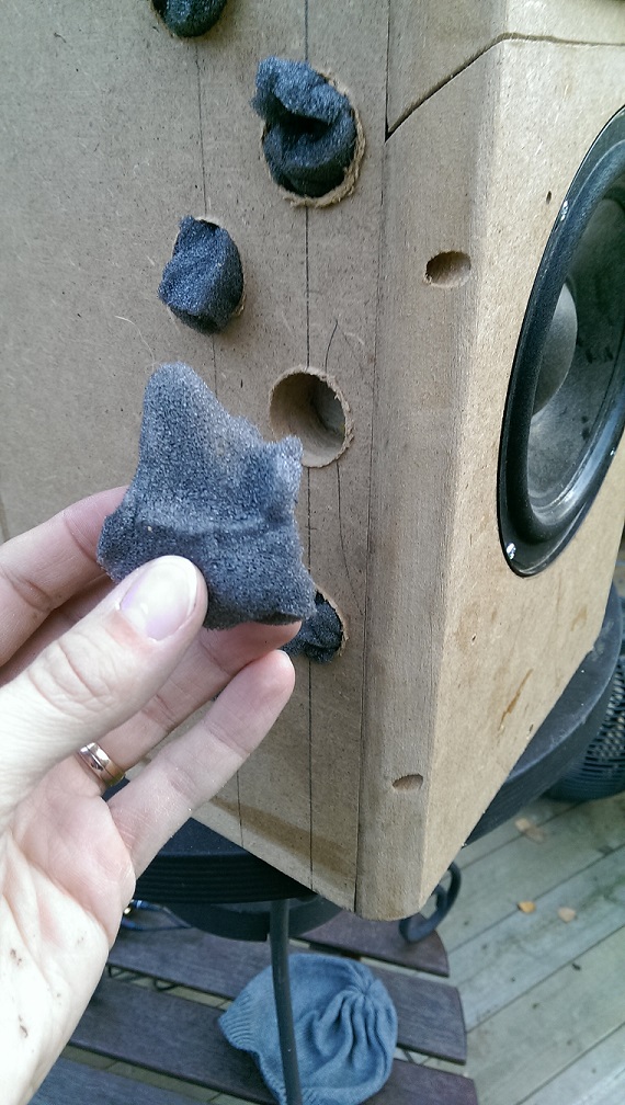

As the response was better with flow resistance I decided to add some more by putting tufts of this:
into the holes:
Resulting response:
Not better, too much resistance? The material has a very high flow resistance compared to the glass fiber.

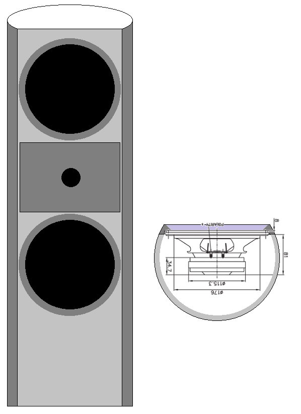

Sketch of rear mounted 8" (8FE200) in the enclosure I'm planning:
~175 mm ctc for woofer-tweeter. I think I'm going for a 2.5 way to avoid the narrow lobe an MTM configuration gives.
No holes in the sketch, but I don't think I want them visible in the end anyway. Maybe cover the speaker with felt, form and function:

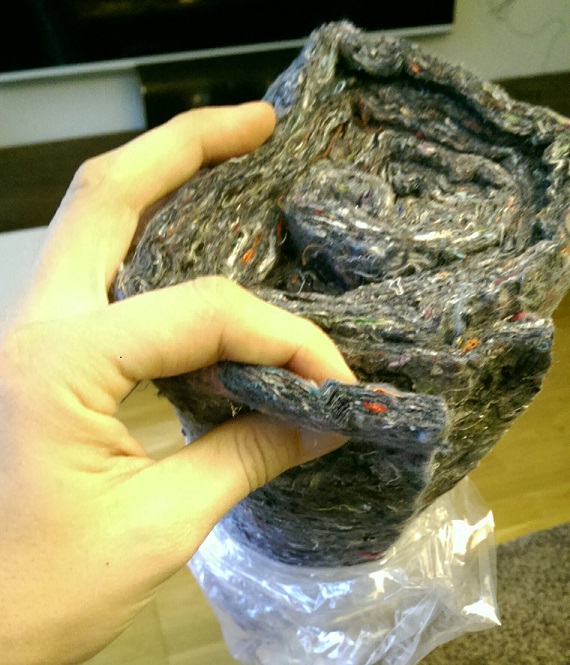

I bought this today:
It's 2x1 m and 7 mm thick and supposed to be used for soundproofing vehicles. Cost: ~20 USD (169 SEK).
I'll try this soon, first idea is to create flow resistance by attaching one layer covering the holes and a large wad in the back of the box to dampen the reflection.

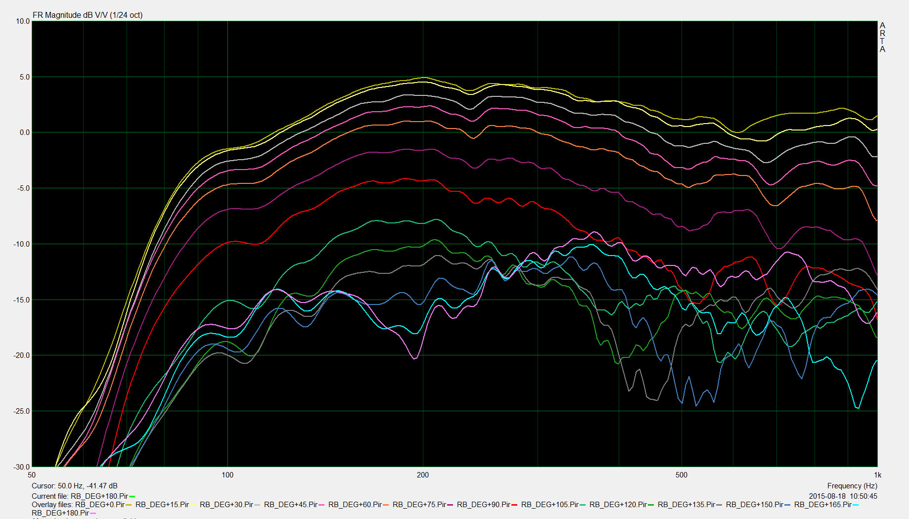

For an idea of what you should aim for, I've added measurements taken during the optimization of one of my most recent passive cardioids. Please note, that for these measurements the microphone was at 3 meters distance and the speaker was rotated around the baffle axis. The directivity therefore looks less high than it does when you move closer to the speaker and you rotate the speaker around an axis closer to the rear of the speaker.
From behind my computer it's very difficult to say what you should do. As I explained before, the end result is always the complex sum of the front-wave and the back-wave. If results are sub-optimal, it is difficult to say which is too loud relative to the other, or which is delayed more.
In your earlier measurements there seems to be a standing wave inside the enclosure, which causes a peak in the response of the back-wave at around 180 hertz. If I understand correctly, the later measurements are with more damping material in the enclosure. Assuming the measurements can be compared one-on-one, the addition of more damping material reduces the standing wave, but it seems to still be there. I'd try more damping material inside the enclosure to further decrease the resonance, but probably you shouldn't restrict air-flow too much. You might be decreasing the level of the back-wave as a whole too much, so I suspect removing the damping material from the holes would improve things.
By the way, with this kind of speaker the measurements at 180 degrees tend to look somewhat less good because the diffraction of the front wave around the baffle is all in-phase there. While optimizing it's probably better to focus on other angles, perhaps 165 degrees.
That is really impressive! Do you have a pic to go with that?For an idea of what you should aim for, I've added measurements taken during the optimization of one of my most recent passive cardioids. Please note, that for these measurements the microphone was at 3 meters distance and the speaker was rotated around the baffle axis. The directivity therefore looks less high than it does when you move closer to the speaker and you rotate the speaker around an axis closer to the rear of the speaker.

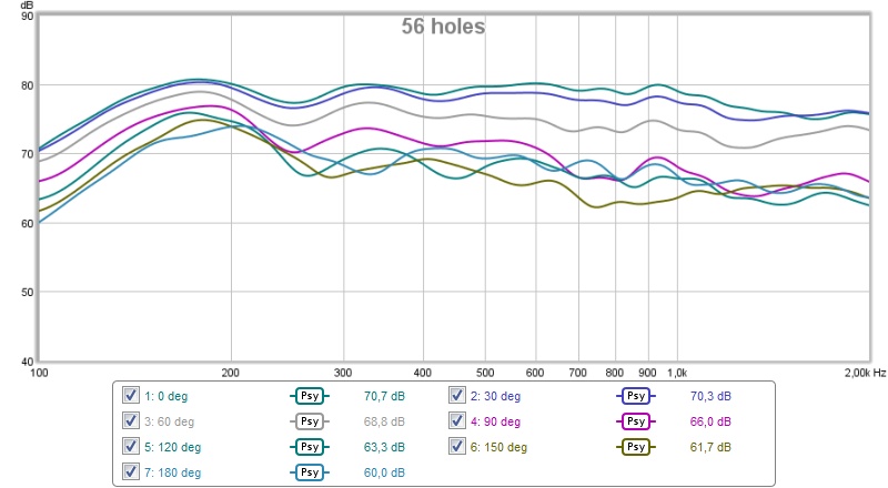

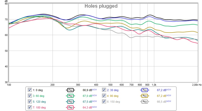

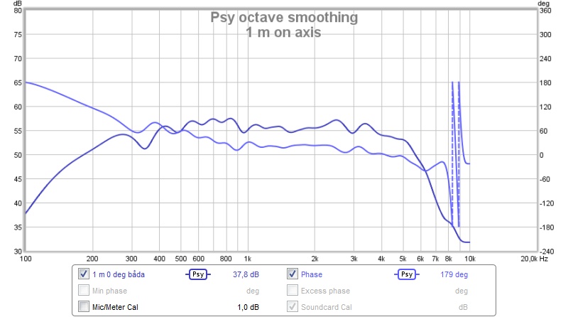

I'm not sure about the standing wave theory...
No holes:
8 holes/side (16*(1.27cm)^2*3.14 = 81 cm^2 ~ 54 % of 2x5" Sd):
16 holes/side (32*(1.27cm)^2*3.14 = 162 cm^2 ~ 108 % of 2x5" Sd):
All of these where measured with ~1.5 layer of this (6 cm thick):
against the back of the speaker. None of it covering the holes.
Then I exchanged for the fiberglass like this:
It's 5 cm thick.
Resulting response:
The hump increases in height and frequency when adding more holes (16->32) which indicates that it behaves like a tuned box (not standing wave). Adding restriction takes the hump down and adds separation between the lines below 200 Hz, but reduces the separation slightly above 300 Hz.
/Anton

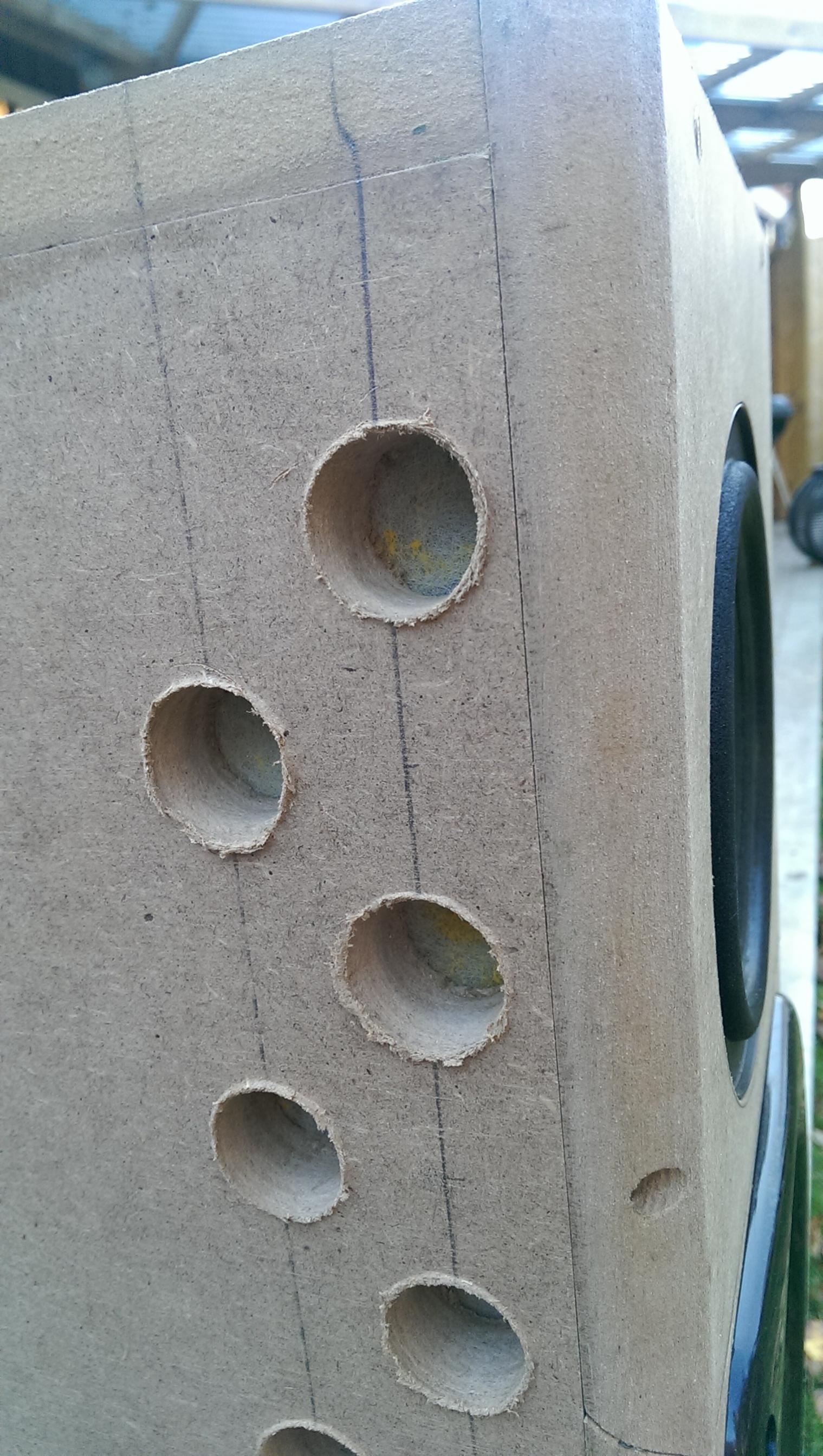

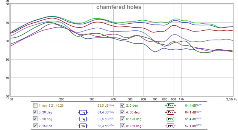

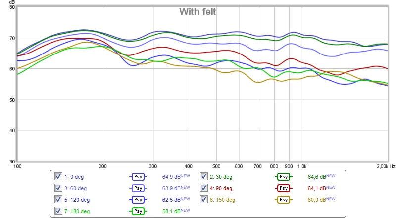

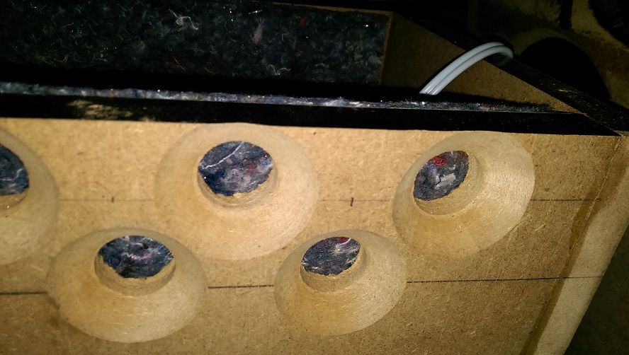

Experimenting with the holes
I've done two new experiments:
1. Chamfering the holes (12 mm) to reduce the air mass that can vibrate acting as a port (tuned system).
2. Replacing the glass fiber with felt as flow restriction (left the back covered with glass fiber).
3. Added more holes (108 % Sd -> 190 % Sd).
For comparison, here is the response before making any of these changes:
I chamfered the holes with a 12 mm router bit:
(Image taken when glass fiber was replaced.)
Resulting response:
No real difference as far as I can tell.
2. Felt as flow restriction
Resulting response:
I chose to add the new holes only close to the midbass drivers (not behind the compression driver):
Resulting response:
Some improvement in the low frequency area, now there is about 10 dB of difference (0-180) compared to 6 dB earlier.

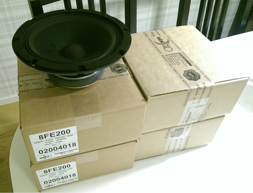

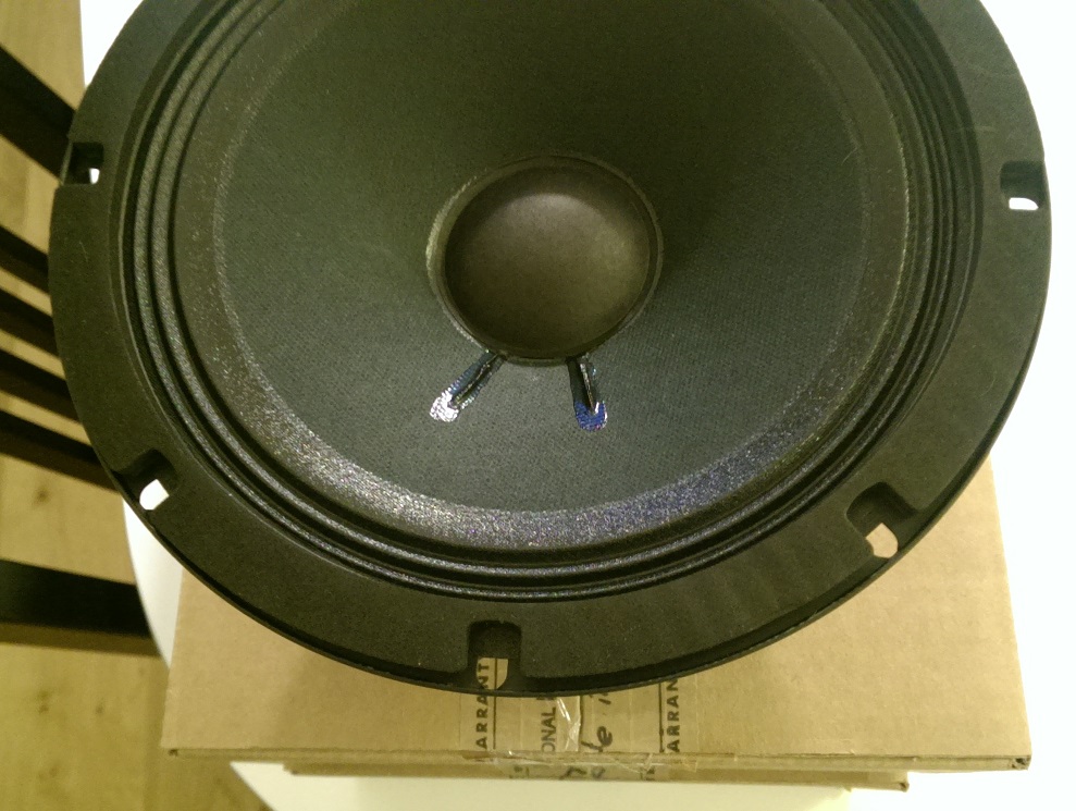

Time to decide what 8" to order. The candidates as of now:
Celestion TF-0818
Fs: 95 Hz.
Monacor SP-8/150PRO
Fs: 56 Hz
Sensitivity: 93 dB (1 W/1 m)
A little to jagged above 2 kHz.
Faital Pro 8Fe200
Fs: 80 Hz
/Anton

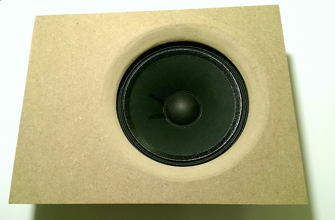

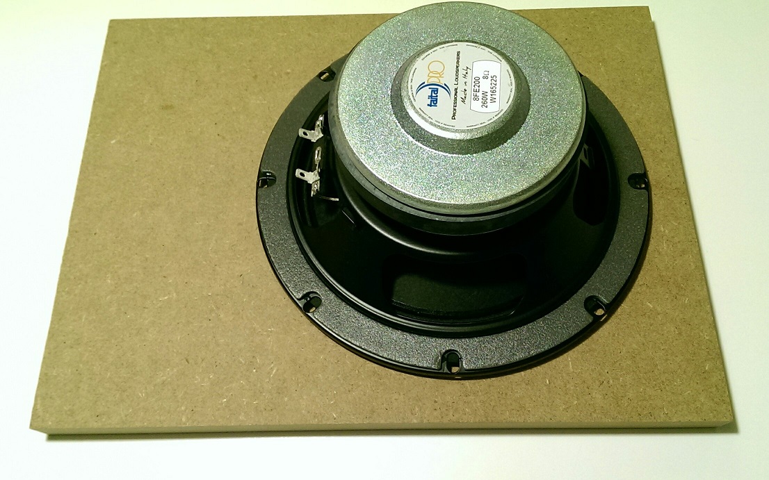

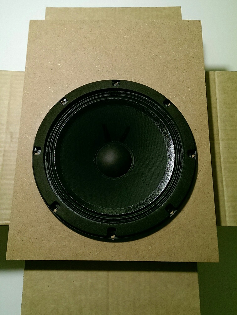

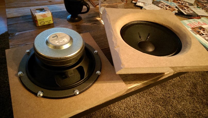

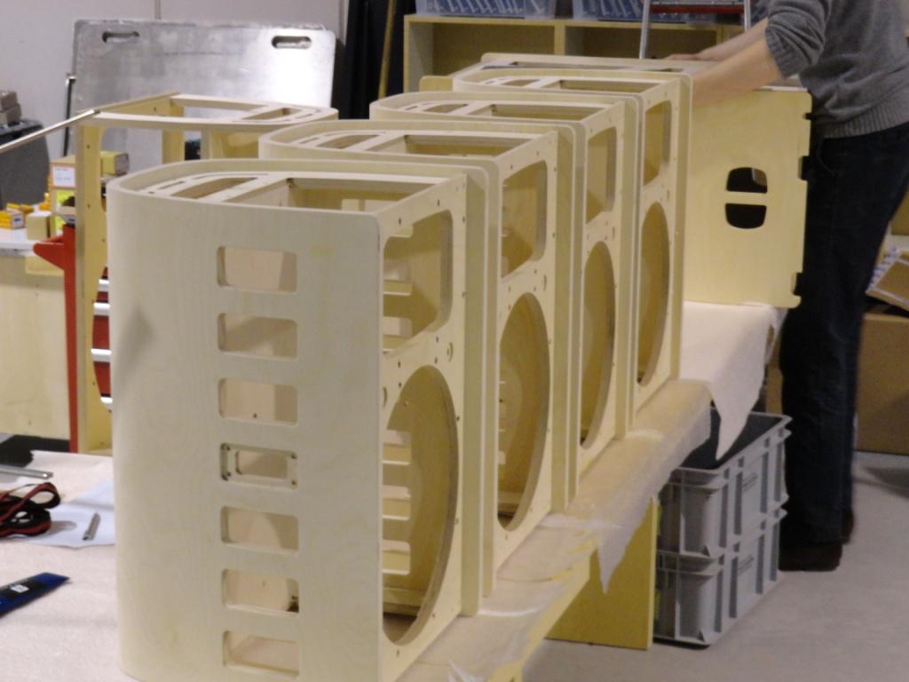

Baffles made for the 8FE200
Today I started working on baffles for the 8FE200 so I can use them in my test box.
Rear mounted:
Compared to front mounted:
The rear mounting makes them look a lot smaller, which I find is good for WAF.

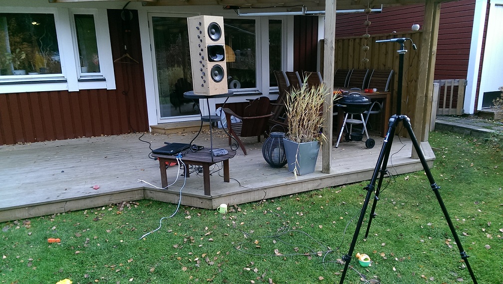

I'll see if it's possible to make outdoor measurements some day, it's below freezing here and I'm just waiting for the first snow.
/Anton

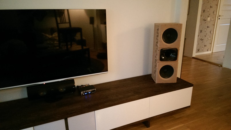

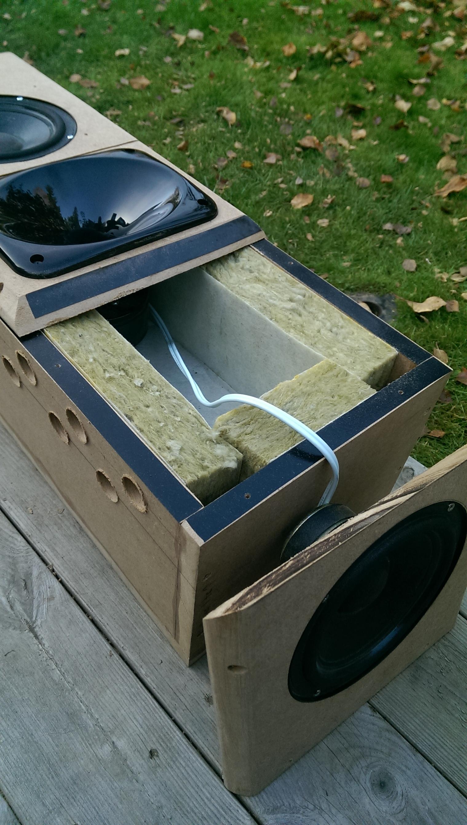

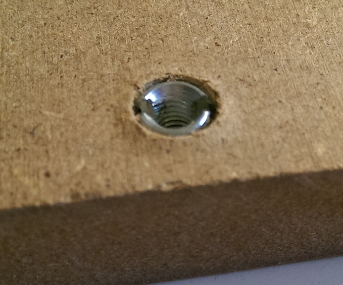

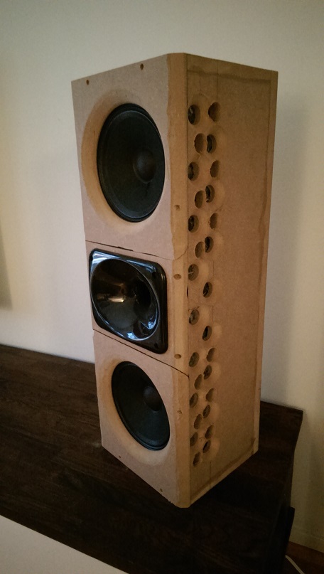

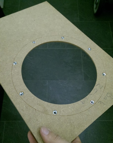

A little more work done!
I used these little fellas:
Called "rampamuff" here, best translation I could find is "threaded insert".
8 inserts.
Both drivers mounted. It was no problem compressing the packer so that the steel basket is in contact with the MDF.
Cables soldered and box closed.
On the media console.
A first measurement:
Indoors, on-axis, at 1 m distance, 1.2 m above the floor, 10 ms gating and psychoacoustic smoothing. Mainly to test the high end of the drivers, no serious peaks or dips 🙂
Next step is to make more holes as the holes are currently at 74 % of Sd (56 x 1" holes = 284 cm^2, Sd = 191*2 = 382).
/Anton
8 inserts.
/Anton
Hi onni, nice project! I'm currently experimenting with gradient type enclosures and believe they have merit too. Sadly I don't have any meaningful/comprehensive measurements (and am far from an expert) but nonetheless have a few questions and thoughts about your project.
What is it about a Supercardiod that you like? Is it the rear nulls that you can aim at the front walls when speakers are toed-in and close to the wall?
I'm not sure if a cardiod/supercardiod woofer and CD waveguide would outperform a monopole woofer and CD waveguide when it comes to having a wider sweet spot. Would be great if they do and am keen to see your results.
From memory, for vent area Kimmo Saunisto recommends 2 x SD but as has been pointed out balancing all the relevant 'cardiod' parameters seems critical to passive cardiod success.
The 'hump' that appears in the lower frequency range of your plots looks like a typical dipole curve (ie first dipole peak). I believe it is pretty common for these type of speakers to transition from cardiod to dipole as they go lower in frequency.
Thank you for sharing your project.
Mark
Mark
Looking good, onni!
Hi Mark,
A speaker such as this does not necessarily transition to a dipole at low frequencies. See the example below:
Hi Mark,
- Leaky supercardioid mids
