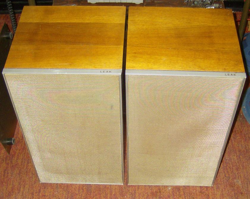

I recently got around to fixing up a pair of Leak 600 speakers from the early ‘70’s. They had been sitting in storage for about 5 years, since I bought them, basically for the 12” sandwich woofers, which were ahead of their time. My brother had a pair in the 70’s and I was always impressed by the way they reproduced bass. Very tight and punchy for a moderate sized box (estimated 60 liters = 2 cu ft). My brother was a semi-pro drummer at the time, so he liked realistic bass. The mid-range and treble were nothing special and the way they were mounted side-by-side, stereo imaging was never their strong point. My plan was to replace the mid-range and tweeter with good modern equivalents and reconfigure the baffle to have mid-range and tweeter in a vertical line. I found that the 5” Peerless HDS P830860 drivers are a perfect fit for the existing cardboard tube mid enclosure. The old treble cut-out was blocked up flush and a new cut-out above the mid opening was made for a Vifa DT27TG-35-06. I know these drivers well and like their performance. The caps in the crossover were replaced just in case (they were over 40 years old!) and I tested the level matching with my Behringer RTA. The frequency response was flatter than with the original drivers, so no padding down of levels was necessary. Now I got a bit creative. The mid and tweeter sharing the same baffle as a 12” woofer is not an attractive idea. Usually this requires a really solid and braced baffle. In the original 2-way Leak sandwich speaker, the tweeter was mounted to the grille to isolate it from the woofer vibrations. Also the woofer magnet was tensioned up against the rear of the speaker by a treaded rod. Taken with the bituminous damped ½” plywood box, and the sandwich woofer, Leak were ahead of their time in many regards. However for the Leak 600 the threaded brace is dropped but a solid hardwood 2”x2” brace connects the baffle to the rear. In the spirit of the original idea, I wanted to partially isolate the mid and tweeter from the woofer by not mounting them to the same baffle. So glued a super-baffle with an enlarged woofer cut-out to the original chipboard baffle. The woofer mounts to the original (inside) baffle with the same mounting holes and the mid and tweeter mount to the super (outside) baffle. The two baffles are glued together by a 3 mm thick layer of adhesive damping compound (Bostik V60 glazing silicone). This is my attempt at a constrained layer damped baffle. The mounting screws for mid and tweeter do not penetrate into the inner baffle as this would provide a transmission path for unwanted woofer vibrations to affect the other drivers. The 3mm layer of silicone can be seen between the ply box and aluminium trim. New grille cloth and Velcro fixing complete the project. The level of vibration on the mid-tweeter baffle is noticeably less than on the rest of the box. I am ecstatic over the results. I consider that I have improved a flawed classic, while preserving the still excellent external cosmetic condition. The cheapo stands are modified IKEA Bekvam stools.

They are a perfect height but not they last word in rigidity. These speakers must be listened to on axis.

Nice job...you have to be a bit of a vintage nut to spend this kind of time, effort and money on speakers like this (I speak from experience)
Sterling move to replace the original HF and Mid unit...typical mediocre Rank-Wharfedale quality from the 70s.

Leak used a variety of mids and tweeters, none of which did the speaker any favours.As I recall the HF and MF drivers were slightly different than yours but the sandwich LF unit was definitely the same driver.
Maybe that's because you never managed to remove the grilles!! They are incredibly tight fitting. My fingernails won't do it. I needed a sharp pry tool and still managed to leave slight marks on the metal trim. I've seen lots of questions on how to remove the grilles. My advice is use a stiff pick and start at the bottom to minimise visibility of marks (inevitable)....for some reason I can't find any pics of mine sans grills...

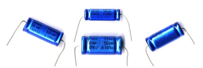

I just came across this thread whilst looking up Leak 600 Speakers of which I own a pair. I was hoping for some of your advice as I am a complete beginner at fixing speakers. Bon, it looks like you did a great job on your Leaks!
The problem I am having is that one cabinet is putting out less signal than the other. My right speaker cabinet sounds great unfortunately the left cabinet is quieter. I have checked it on two different amps and swapped channels on both so I know it is the speakers. I have opened it up and taken some pictures to show you. Not that one could probably tell just by looking but I was hoping for some advice as to what to potentially check or replace. Unfortunately, I'm not as skilled as you Bon so I'm going to have to keep the speakers that came with it for now. Thou that would be a great project.

The white wadding is an essential feature to absorb box resonance and avoid a hollow sound, just keep it away from the drivers. The cabinet panels are damped by the stick-on absorbtion sheets which is quite high end. Adding extra hardwood battens actually makes the sound worse, and is not recommended.
A speaker of this vintage will have Elcap 50V non-polar electrolytics, which will dry out with age and cause the loss of level which you are experiencing. Not expensive to replace with the ALCAP equivalents pictured below. Keep a note of wiring polarity if you have to disassemble, but a soldering iron and a solder sucker and modern lead-free solder is required. Get in and out quickly, suck out the old lead solder and redo, say 5 seconds to avoid cooking the new capacitors.
You could replace the (3-4uF?) tweeter capacitors with modern polypropylenes, but the rest are voiced for the original electrolytic type and perhaps best left as such. Happy listening.

I just got back to this page and can see that you have been given good advice in my absence. The first thing I did was replace the Elcaps in the crossover. I can go into more detail on how I replaced the mid and tweeter. I just happened to have a bunch of nice drivers sitting around and they fitted like a glove (with some persuasion). If your drivers are all ok, then happy listening.Thanks so much for your replies guys. I really appreciate it!!

I don't have access to the speakers anymore, having passed them on.Do you know the exact values and type of capacitors I need to order? Is the crossover ALCAP 50V? I'm just not sure which cap is for which.
I used the non-polar electrolytics from Jaycar. The values are printed on the original elcaps. I had to use the closest available value in a couple of cases. They were a lime green colour.So I just want to find out the right type and order them online.
I clipped out the elcaps and soldered the replacements with the board in place. It is tight but do-able without burning yourself.I was also wondering if the board with the caps and crossover etc should be easy to take out, I tried pulling it out but didn't want to break it?
