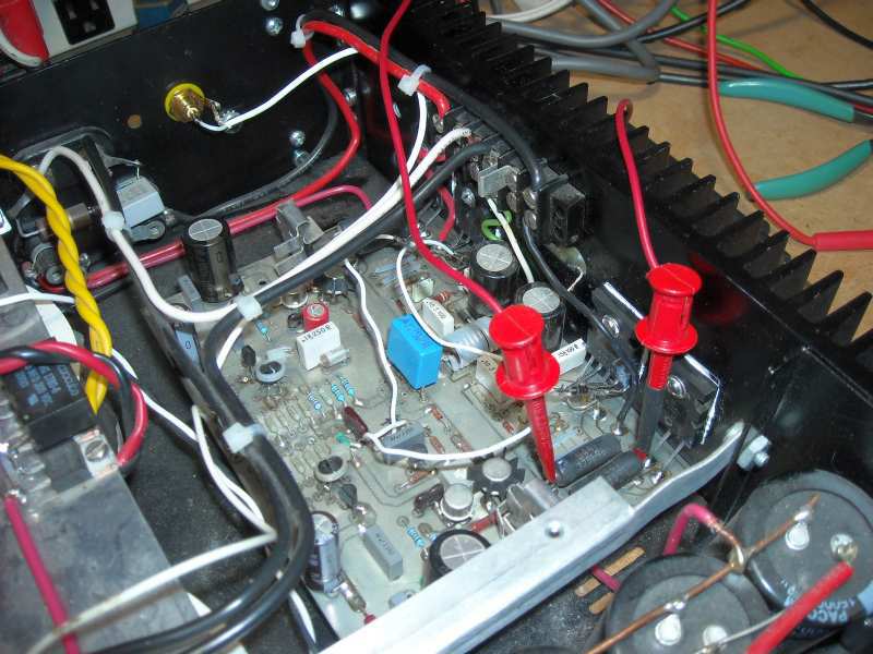

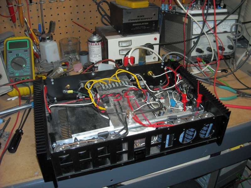

Well, here's the beast I put together for a test bed, both bench and listening:
It uses the single Brian Bell-designed Leach amplifier board, laid out for use with plastic-cased output transistors--simplified wiring very neatly compared to TO-3 socket devices. Similar in appearance to a Hafler SE-series small amplifier that I've long admired and the first amplifier I've built that doesn't look industrial-ugly.
A closeup of the NJL1302/3281 Thermal Trak and MJL1302/3281 transistors with current monitor clip leads. Note charge suckout capacitor between the driver emitters for improved high frequency distortion. This may be working better with these high speed transistors than did the MJL21193/4 transistors I installed initially. A 10uF capacitor worked a bit better and seems to reduce high-order distortion products on the oscilloscope display, a result I was hoping for with these devices.
Depending on bias settings, my Fluke digital thermometer reads heat sink temps up to 150F, a lot hotter than I'd prefer to run for other than test purposes.

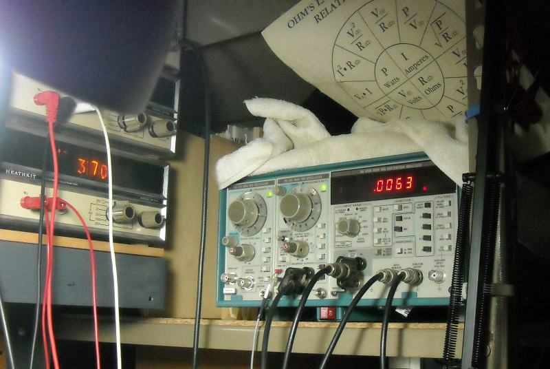

My Tektronix AA-501A based distortion test set, showing a 1 kHz signal at about 3 watts.

Back to working on my Leach amplifier prototype with ThermalTrak transistors. Of course, there are issues.
Rumors that ONSemi is canceling the ThermalTrak line notwithstanding, I have only two sets of the devices to make a stereo amplifier. So, using another set of 'regular' MJL outputs, I epoxied 1N4004 diodes to the cases above the silicon dies to make a hybrid set for both channels to get things rolling.
On testing the first channel, I immediately found a considerable rise in distortion and bias current with frequency, especially starting at 10kHz. At 20 kHz, the crossover distortion notch is plainly visible unless I considerably increase bias and that leads to a very hot heatsink. 20kHz distortion is almost two orders of magnitude higher than 1 kHz at full power and a couple of times I popped a 5 amp rail fuse (no damage to the amplifier) with audible stress from the power transformer. Rail voltages fall to 50 volts or a little lower.
Obviously, something's not right. I'm going to experiment with base stopper resistors and base to collector snubbers to see if there's oscillation at some extremely high frequency that's not showing on the 'scope.
Distortion at lower frequencies and modest power levels is .007% or thereabouts, though I feel the noise floor is a little high. The circuit board is a unique design by BrianGT, who doesn't seem to be active lately; the other channel will have to be kludged from my main Leach amplifier's 4.5 board with (short) jumpers.

Might have already done some of this last weekend, but the current Seattle heat wave has made it too bloody hot in my workroom during the afternoon and evenings.
I haven't tried running IM tests with my Tektronix AA501A analyzer; this test set can run both SMPTE and CCIF tests, but I need to dig into the docs to be sure I'm seeting it up correctly. THD testing is very easy to do, and I monitor the distortion products on an oscilloscope.

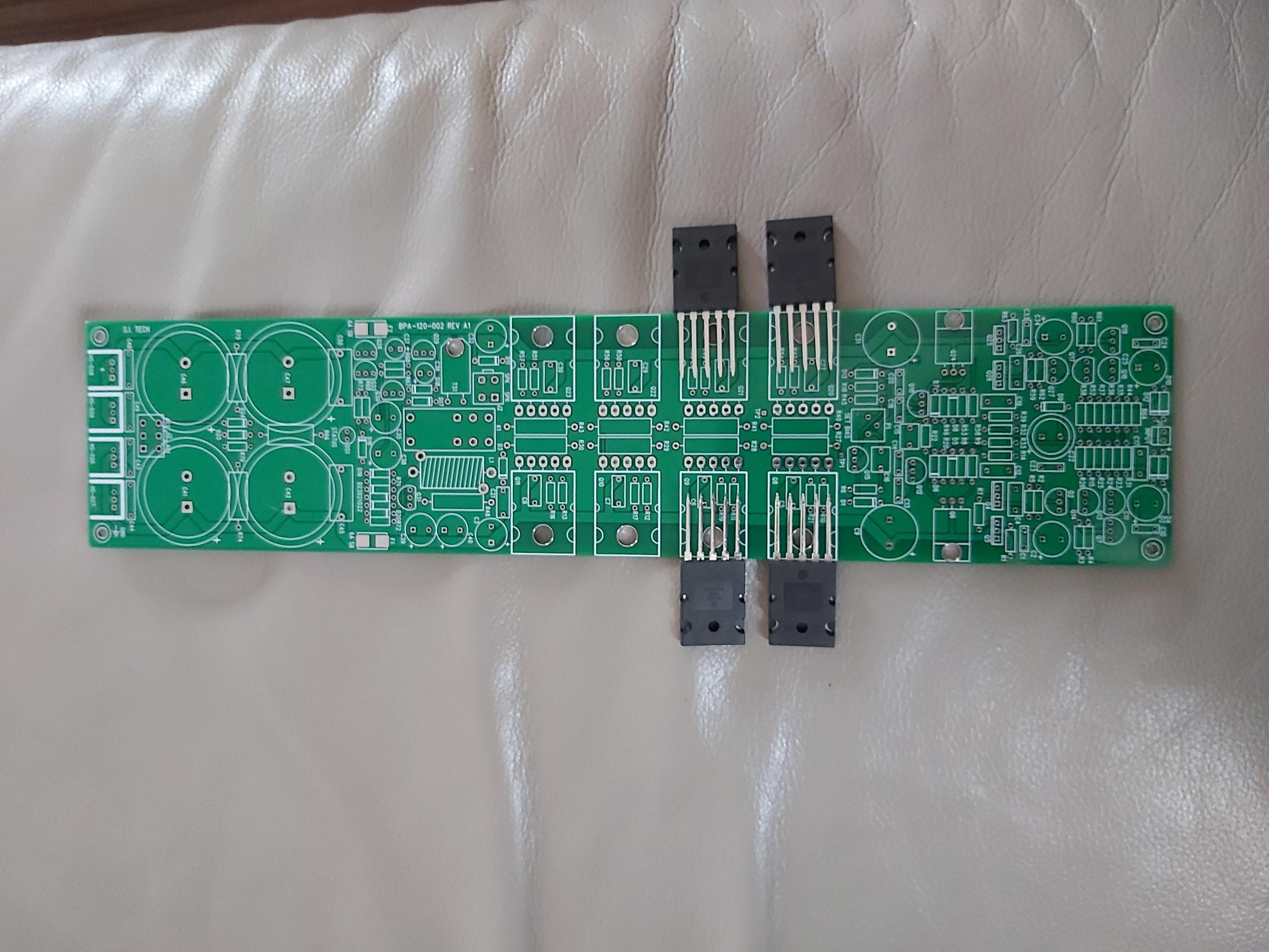

After much difficulty and procrastination, I finally have a stereo chassis using two not-quite-identical Leach amplifier boards running with high Ft Thermaltrak transistors. There are a couple of issues with the measured performance; one channel appears to exhibit cross-conduction above 10 kHz and high power, and somewhat 'dirty' distortion residuals; the other channel, much less so.
It's taken over five years for me to get to this point: actually listening to the thing.
The real point of the exercise of course, is to take advantage of the high Ft and linearity of the perforated emitter transistors and the close thermal tracking of the internal bias diodes. I'm open to thoughts on how to modify the Leach design to exploit that higher speed; simply changing the Miller capacitors on the VAS stage is not without perils.

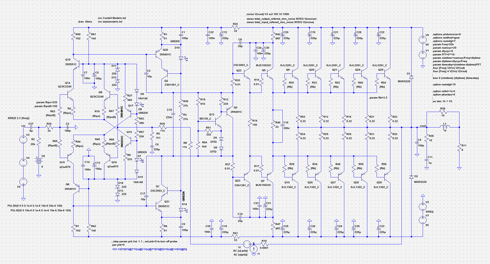

This is my ThermalTrak-ed Leach with Hawksford Cascode VAS. I ditched the cross-over feedback loops and replaced them with simple global feedback. Simulation shows adequate stability margins, and a better than 0.002% distortion at 20KHz full power. and I have never detected instability with the actual build. This is my daily amp driving a pair of 4-ohm PSB Stratus Gold-i floor standers in the living room. The build was done on a gutted Citation 16 chassis. I have a thread "pimped Citation" for that, but it was plain Leach Low TIM plus ThermalTrak at that moment. VAS and feedback mod was done later when I learned a bit in using LTspice.
It did take me some effort in getting the bias control stability right. I ended up pulling it off by using Bob Cordell's Figure 14.19(a) combined with a constant current control.
If you are new to Ltspice, I do suggest that you buy/read Bob Cordell's Power Amp book. Also I just discovered yesterday that user "mooly" has started a Ltspice thread, so that should help you get up to speed as well.
