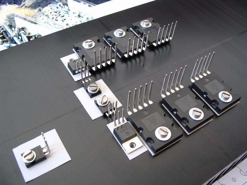

Is this thread dead? I have been waiting for someone to demonstrate using ThermalTrak devices in a Leach amplifier.
I was hoping to do just that experiment myself using BrianGT's Leach amp board, but I only got the one prototype board to build up. I used regular NJL21193/94s in the chassis just to verify stable operation, but lacking a second channel and any response from Brian about more boards, I've left the project to gather dust for now.
At some point I will reinstall with the ThermalTrak devices (some creative lead-bending and rewiring required) and see how the bias behaves--and whether these faster transistors are stable in the circuit! This chassis doesn't have as much heatsinking as I'd like--and I like to push the bias for minimum possible distortion--so reliable thermal tracking is of more importance now.
And if I could just interest Brian in building more of those boards...
Keep prodding me, eh?
Mod done, now puzzling over the results. Two diode drops weren't enough to bias the amplifier correctly, as expected, so a couple of 1N4004s were added to make up the difference (and base stopper resistors were removed as an afterthought). I can get distortion down under .005% by overbiasing but the heat dissipation is excessive on this chassis. Any thoughts? Too much reading to do on Vbe multipliers...
Distortion goes up rapidly with frequency, so I'm going to have to look at that aspect of the design, too.

Damon,
Do you have access to Bob Cordell's book? He has some excellent advice and observations on the subject in there. I need to set aside some time to digest it myself.
Indeed, that book has been my 'bible', but it's tough to absorb. At a start, I may have to hack the Vbe multiplier.
