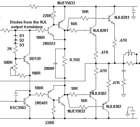

Hello
I only founded four NJL0281 and four NJL0302 , so the thermal track Leach's VBE would have less diodes.
I'm making my own amp, using a CFP driver output, can a single transistor vas would work good with a CFP driver output ?
Here is the cfp drivers output schematic, it's not tweaked but it's near final, is my CFP driver thermal track output are ok ?
Thank

Hi Gaet,
the 0r15 is far too low. It will overheat the MJE drivers.
I would still use 4diodes (1 from each output) but you may want to experiment with adding a small resistor value to the emitter of the BD139. Someone symmed this recently and reported good results.
Have you looked at the interview threads - fets includes a section on using diode compensation?
Hi Gaetan,
With only 4 diodes output stage will be undercompensated and on a verge of runaway:
4*(-1.66) = -6.64 mV/K Total TC for NJL diodes.
4*(-2.1m) = -8.4mV/K Total TC for drivers (CFP) and output BJTs BE junctions.
The output stage will have a total TC = -2.24mV/K !!!!!
You need five NJL diodes with total TC = 8.3mV/K
Mihai
Mihai

Hello Andrew
I want to keep the drivers allway ON in class A, to minimize switching noise, so what would be the minimum value to replace the 0r15 resistor ?
How about 50 ohm for small resistor value to the emitter of the BD139 ?
You mean to look at the "Bob Cordell Interview: BJT vs. MOSFET" ?

roender said:Hi Gaetan,
Mihai
Hello Mihai
Can I ad a 1N4148 for the fifth diode ?
Thank
Gaetan

15ohm will bias drivers at 75mA

No, use a MUR120. Put all output stage junctions on the same heatsink ... take a look at RMI-FC100 thread. Or use three NJL pairs
