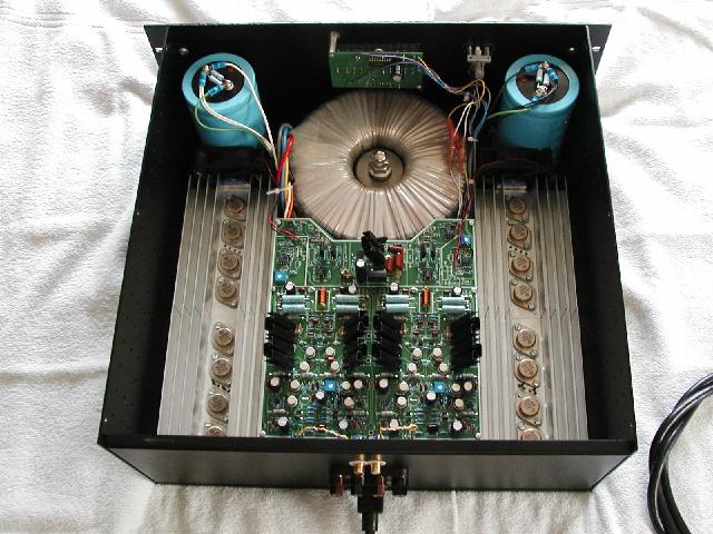

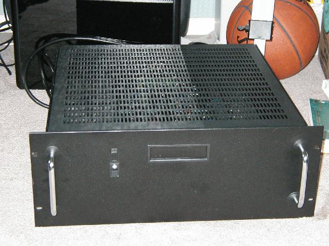

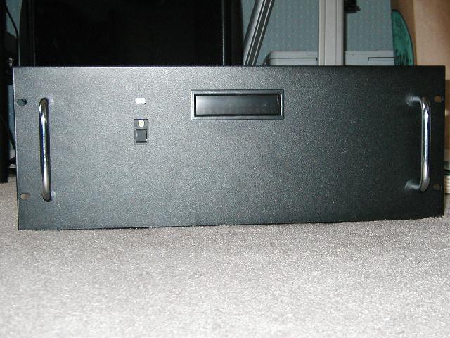

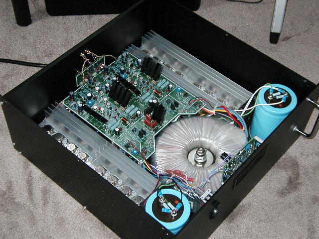

Here are pictures of a Leach SuperAmp that I finished last year. The circuit boards I designed myself with two channels per board. The design also features an LED VU meter for each channel that consist of ten blue LEDs for each channel. They light up behind the smoke tinted bezel on the from panel. Each channel does just about 270RMS per channel into an 8 ohm load. I have run the amp into as low as a 3 ohm dummy load and was able to achieve just about 1100WRMS per channel (not simultaneously). It runs hot it you do this. There are two fans which blow across each heatsink to cool them. The Transformer is a 1500VA ordered from Plitron in Canada somewhere. The caps are 55,000uF / 100V for each rail. The power supply generates plus and minus 90V rails which are shared by the two channels. Most of the wiring is neatly tucked, bound, and routed under the board and to the BJTs under the heatsink so that there is no eyesore inside. All of the wiring is teflon so there should be little concern about melting. Though it only gets hot if it is run into low test loads. There is also a clipping indicator on the board and a smaller supply to deliver power to the LED meter, the LEDs, the startup circuit, and the clipping indicator. And that is all I have to say....thought it would be nice to add.

The Leach is not overdesigned at all. It is a fairly straight forward design. Let me know if anyone is interested in purchasing the second set of boards. The boards were made from ExpressPCB. I did all hand routing without a schematic capture package. However I do have one now. I have had several people in the past ask about the Express PCB file for these boards and I thought that I did. It turns out that the only thing that I do still have is an intermediary version where it is the two channels on a single board side by side without any further of the "extras" that I included. Just two amplifiers. So if anyone who asked about it so many months ago are intersted in this, I can email it out soon.

I do not have a gerber file for these particular boards. ExpressPCB uses their own program which does not allow the export of a gerber file. However, once you order boards you can purchase the gerber file for an extra cost which I did not do. The transformer is a 1500VA Plitron model which results in +/-90V rails. I am not familiar with the transistors you mentioned but if the specs are similar to the M15003/4 then they will operate.

It is a very accurate amplifier. Fast response with a smooth frequency response. Tons of power at the low end delicate at the high end. That makes all the difference. No matter what kind of music you are listening to it is a good performer. I have done side by side comparisons against high-end, brand name amplifiers and this one was a hands down winner by third party listeners. It wasn't too complicated or expensive to build (relatively speaking). You will find when you listen to music through this amp that you will notice all new nuances that you probably never noticed in the soundtracks before. It puts a whole new dimension on the music. I also use it for the front stage amplifier for watching movies as well. I run the DVD player into it with a fashioned volume control in between. I am using Polk RT55i with a PSW250 which gets its signal hot right from the output of the amplifier. Some will scoff at running a powered sub with high-level inputs but as long as your amplifier is not allowed to clip, the signal will be strong with a high signal to noise ratio. I still have most enough parts left to build a second one....any buyers?
