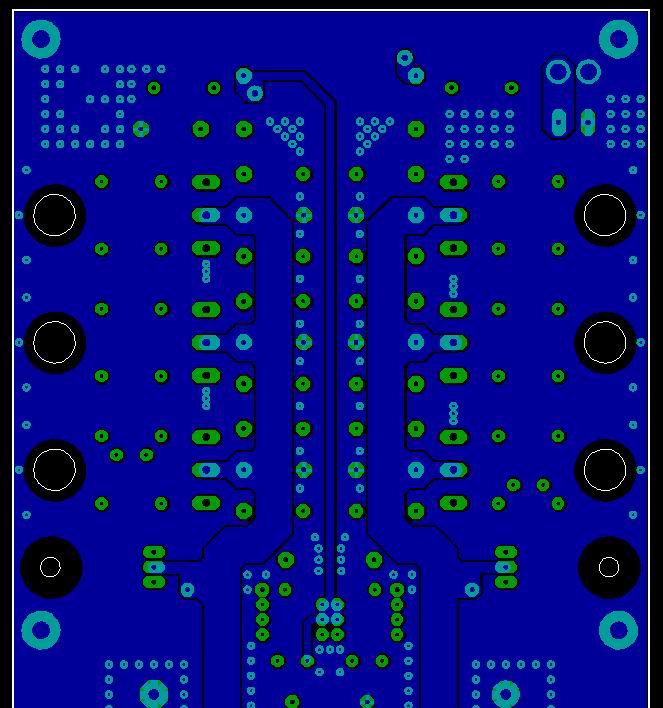

The Boards are about 108 x 325 mm
I have suggested a heatsink from conrad.
I would still like some more input about footprints for the different parts, I have explained that I will not work on the layout untill somebody steps up and help me deside what parts to make room for.
Im thinking of redoing the whole board design right now, with the parts I already have on board. This board will not be a GB board as my componets are hopeless compared to audiophile stuff and the PBC will have 4 layers.
Btw, why does nobody come forward and help to get this thing running???
\Jens

the conrad heatsink 105mm x 400mm looks good, however, my choice is 2 x 105mm x 250mm though.
any chance providing around 2mm more separation between T13/T13A, T9/T9A, T8/T8A, T12/T12A? this is to have more choices in using plastic transistors.
thanks
a 105mm high heatsink puts the power transistors right at the edges of the sink. This is poor for heat transfer efficiency. The heat is effectively flowing in one direction i.e. towrds the middle of the sink. Both the BJT data and the sink data will over estimate the dissipation ability of this ill advised combination. I cannot advise how much error will result but I would not be surprised at a figure approaching -30%.
I would recommend the sink extend at least 10mm above and below the top and bottom edges of the power BJTs, giving a minimum height of 120mm if the 100mm wide PCB is finalised.
Personally I would use 140mm to 150mm high sinks for a 100mm PCB.
I agree the heatsink should be the 150 mm high type MF35-151.5.
\Jens

Regarding your further design with the PCB: could be beneficial to design the PCB with an option that makes it possible to cut the long main board in two parts (driver board + output devices). Reason for that is the long PCB will not fit in all the chassis (old chassis as well as new ones) that could be used by the DIYs
This option could be done by designing the main board in such a way that it contains a cutting zone, a space between the driver board area and the output device area where you can make a cut. This small space/zone could also be fitted with pre-drilled solder eyes for cable/conector connections between the two boards. This gives the DIYs the possibility to use different power device boards (e.g. their own design for other type of output devices). Just an idea.

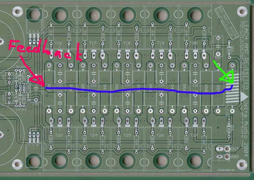

My little remark is that you have forgotten to include _all_ transistors in the feedback. It's possible that this is of minor importance but possibly you could reduce distortion and the output impedance. My patch is easy to test if it means anything. A basic rule I think everyone can agree on is to include _everything_ in side the feedback loop. I know the copper was thick but the resistance isn't zero.
My patch is to move the point of feedback. See the blue line. It's possible that it's needed to shunt this blue line with 100 pF - 1 nF at the original feedback point.

That is not a super amp PCB...
This is my first factory made PCB for the extended Leach amp the layout is more than two years old and the discussion about take off point for the NFB is about the same age.
The PCB in GB for the redesigned Leach amp PCB was changed so that the FB was taken directly at the output inductor.....
