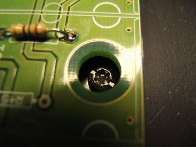

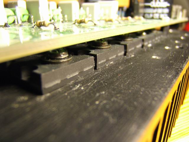

sek has raised an interesting point and one I have overlooked. Would it not have been better to have the transistors mounted outside the perimeter of the board? I can see an advantage of a smaller board and shorter trace lengths as well as lower cost?
Mikett said:Would it not have been better to have the transistors mounted outside the perimeter of the board?
Maybe you should take a look at the size of the traces from and to emitters and collectors of the outputs.
Jens,
what kind of screws are that, are that washers underneith ?
JensRasmussen said:Here is how the transistor is mounted:
Thanks for clarifying, Jens. 🙂
Mikett said:Would it not have been better to have the transistors mounted outside the perimeter of the board? I can see an advantage of a smaller board and shorter trace lengths as well as lower cost?
I don't think so. The trace lengths don't really get shorter (as the distance to "travel" is from the driver stage to the last output transistor, not between the output transistors), but the trace widths would have to be reduced considerably.
I am currently in the process to design a board for a different amplifier, and I found out why it is very difficult to have the output devices on the perimeter of a slim board: How do you route positive and negative supply, power and signal ground, positive and negative base/gate drive, negative feedback and output on a slim strip without letting them interfere with each other? Next to impossible without compromising the amplifier's distortion performance through (too) thin traces and capacitive coupling ...
Just my thoughts,
Sebastian. 🙂
