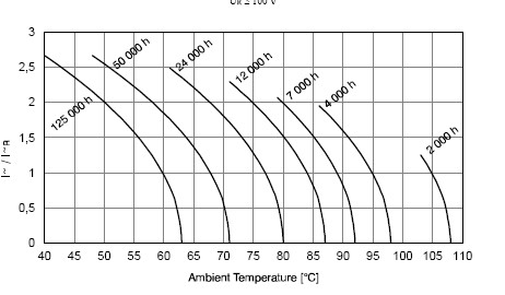

here is a capacitor lifespan graph.
The graph shows too that lowering ripple current increases capacitor life dramatically.
Seems to advocate very large powersupplies, funny that i havent seen someone mention that on a thread yet.
A general rule of thumb states that the life is doubled every time the temperature falls 10 degrees.
An example: 5.000 hours at 105 degrees. = 10.000 hours at 95 degrees = 20.000 hours at 85 degrees and so on.
That is pretty much what the life time multiplier graph that Jacco posted also shows.
It’s less of a problem in class AB amps. Class A is another matter because of heating from output stage and heating from the ripple currents in the caps.
