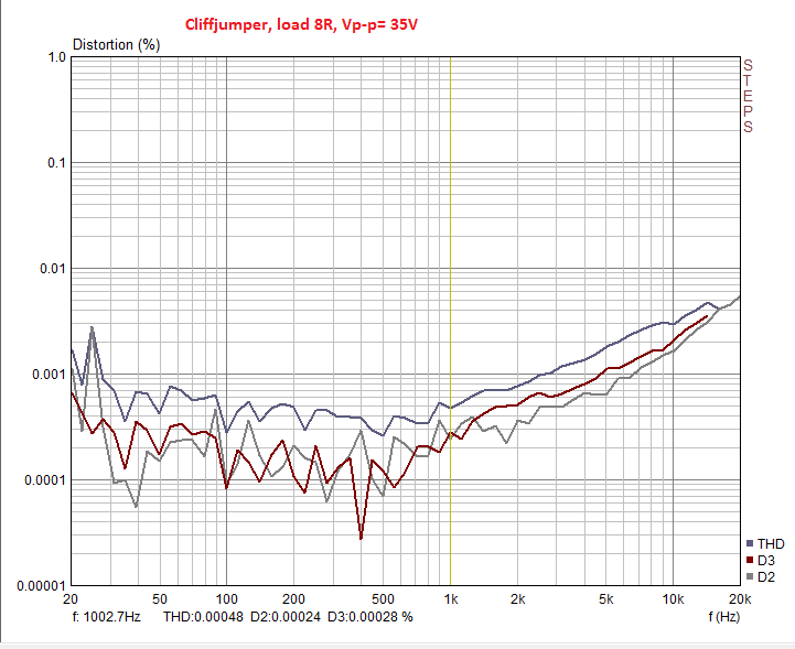

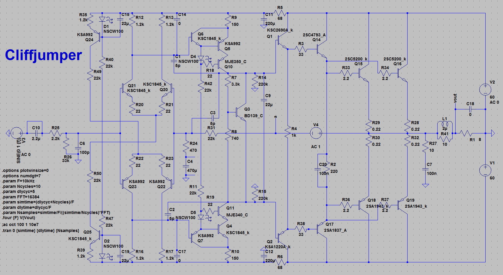

I think OS is right, try the EF3 and some more fancy VAS. I was wondering how does the new VAS from OS and Valery's projects perform and I have made very basic and simple board (just for a fun) and the resaults are stunning.
Or You can try some CFP or yamaha style VAS, only two transistors and nice cliping + very high input impedance (and prapobly ower output impedance so it would be easier to use it with EF2 output stage)
Please take a closer look, You have used 3 transistors per one side of active VAS, 3 transystors can be used in a bit better way.

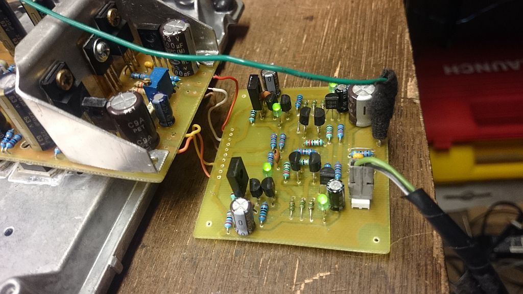

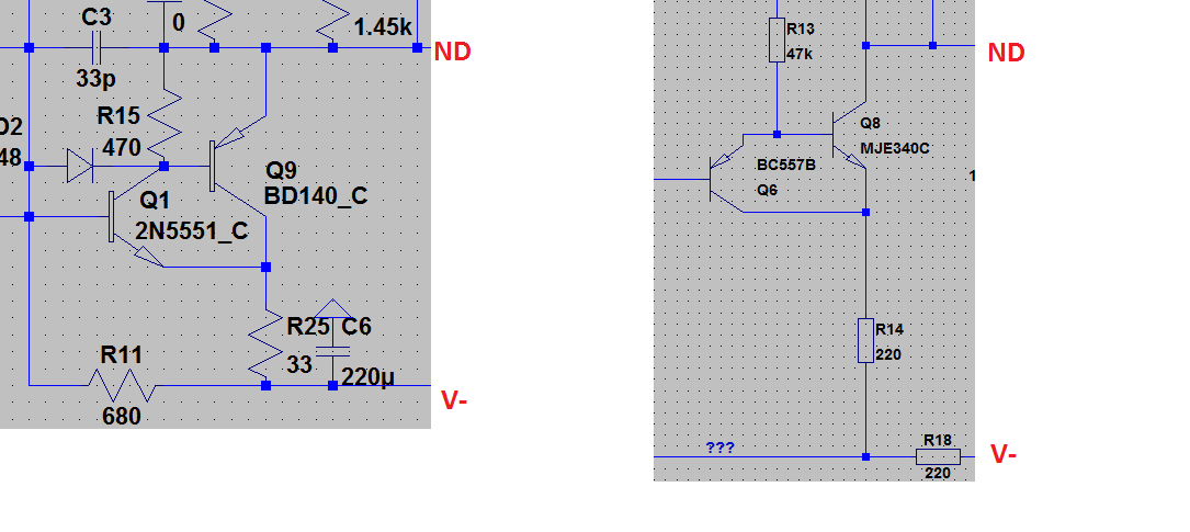

I took a look at your Spooky and the HK990 and one thing that jumped out is that they both use a cascoded VAS instead of the more common (and usually better performing EF VAS) as I have also done here. As I understand it, there is little or no benefit to cascoding a "good" VAS device such as the KSA1381/KSC3503 that already has low Cob and high Early Voltage and can actually make performance worse. You have used the "slow" MJE340/350 in your Spooky and a cascode makes sense there, but in my case with the KSA1381/KSC3503 I'm not convinced that it will improve performance. Or am I missing something here?
Have you tried an EF VAS as shown here?
The other question I have is regarding the VAS Re's. Here I have used 33R (vs. 150R in spooky, Leach, HK990) to help push up the loop gain, but I'm worried that this low value will make the VAS Iq overly sensitive.

Nice schematic and board - WOW a VAS cascoded with a CFP. Is it stable?? 😀
Unfortunately I'm absolutely hopeless in Sim and have no easy way to test my theory that cascoding KSA138/KSC3503 devices brings no real improvement - and may even reduce performance. That's why I went with the EF VAS to try and increase loop gain a little. But I'm nervous, because every Leach style amp I've seen (apart from yours) uses either a simple VAS or cascode!
Thanks borys. The 3rd NPN and PNP in my VAS are current limiting transistors, so they don't do anything in normal operation.

I took a look at your Spooky and the HK990 and one thing that jumped out is that they both use a cascoded VAS instead of the more common (and usually better performing EF VAS) as I have also done here. As I understand it, there is little or no benefit to cascoding a "good" VAS device such as the KSA1381/KSC3503 that already has low Cob and high Early Voltage and can actually make performance worse. ..............
The cascode has an inherent, high output impedance.
The cascode must be loaded in such a way that the high output impedance does not deteriorate the performance. That usually requires a very high receiver impedance.
A normal VAS has a much lower output impedance and the circuit loading that happens to suit this plain VAS (or EF+VAS) does not necessarily suit throwing in a cascode.
