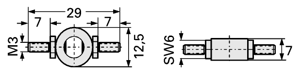

How have the rest of you secured the PCB to the heatsink so that the output device leads do not carry the weight of the board?
I'm an aficinado of flexible spring/mass mounted pcb's for the microphonic influence thingy, in line with manufacturers such as Goldmund and DartZ.
Rubber damping and insulating ring incorporating pcb mounting studs can be ordered from several electronic stores.
The calculated damping can be obtained by making incisions in the rings or adding damping material in the core, depending on the weight of pcb and components.

Unfortunately they take up too much distance. The PCB sandwiches the output devices to the heatsink with just a tiny gap from PCB to the face of the package. The gap that needs screwing is 8.5mm.
I think I'll just repeat my existing steel screw fixing with nylon. Achieves the insulation required and goes a little way towards your compliant suspension system.
