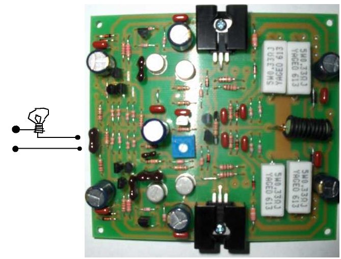

Thanks for the replies. I have checked most of the items you all mentioned. P1 was turned counter-clockwise for maximum resistance. I am using 2N5415 and 2N439 transistors from STMicroelectronics. They passed the NPN /PNP test from Prof. Leach’s web site. AndrewT – for a light bulb tester do you mean a light bulb in series with the hot wire before the power cord? If so I can make one easy enough. What wattage bulb do you use?

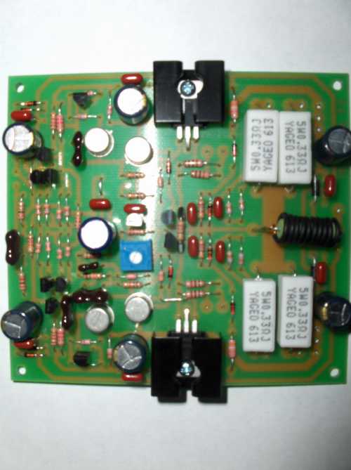

I have removed the circuit board from the amp and removed all the wires. I have replaced the blown resistor. Here is a pic if anyone wants to look and see if anything jumps out as wrong.
Once again, any help and assistance is greatly appreciated.

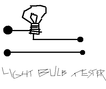

lineup
mains light bulb tester
wire up a plug top with socket outlet to supply your new equipment. Wire in a bulb holder with both terminals in series with the live wire.
The neutral and earth go straight from plug top to socket outlet.
Use a lower wattage bulb to start with. It does no harm if it is too low and if there is a wiring fault less curent flows and so damage is less. Amps with a voltage detector on a soft start circuit may burn out the soft start resistor, for these you must temporarily short out the soft start resistor (in a safe manner) to allow the bulb tester to get the amp up to voltage. A correctly sized bulb will allow about 90 to 95% of mains voltage through to the equipment.
An amplifier set up with zero output stage bias draws very little current once started. It draws a lot of current at start up. Initially to magnetise the transformer core and once this is established then to charge up the smoothing to near final voltage.
You will see this initial current requirment as a brief bright flash becoming a dimming as the current falls over a period of between half a second to 4 or 5 seconds for a big PSU. If the bulb continues to glow or stays bright, then investigate BEFORE changing to a higher wattage bulb. Remember the amp is live, so take care while measuring.

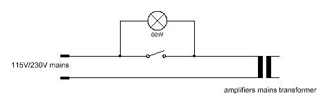

Once you have proved there are no wiring or serious component faults then disconnect the bulb tester, and make sure you have a close rated fuse in the primary side of the transformer. A switch in parallel to the bulb would allow full mains through. A disadvantage of this tweak is leaving the switch in the wrong position and losing the protection you need for first switch on.
Light bulb tester
The light bulb is actually a current dependent resistor in this application. The higher the current the brighter the lamp. If the amp was a short then the most it could draw is the wattage of the bulb. The cold resistance of a tungsten bulb is about 10X less when cold than when the bulb is hot.

Howdy folks,
The light bulb test device is an old useful idea. It's implementation has been described in numerous ways here on the forum. Could one of you experts present a simple schematic for the noobies to follow? I admit to being unable to construct one and use it from the various descriptions even tho I have used this method in the past. This one is real hard to google.

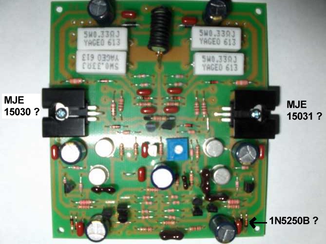

Double check all the resistor values with a multimeter on the board...also test between B-C-E all the on board transistors for continuity...the only ones you should get continuity on are Q8 and Q9 because or R22 and R21...usually continuity between pins on a transistor means its dead...check Q18-Q21 also..did you have the Bias diodes D1-D4 installed and connected to the board at the time of testing?

Since this is your first project, check to make sure the output transistor cases (Collectors) are not in electrical contact with the heatsink. Also make sure the bias diodes are not in electrical contact with the heatsink. The black anodizing can sometimes give the appearance of being non-conductive. They should be in thermal contact only.
Thanks to everyone who has replied. I have learned more form this problem then the entire assembly so far. Sooooo…
Here is what I found. R13 and R14 where 2.2 ohm instead of 2.2Kohm. (On both boards) Duh!
Anyway, I will correct these and try again. (Yes I checked all the other resistors as well).
