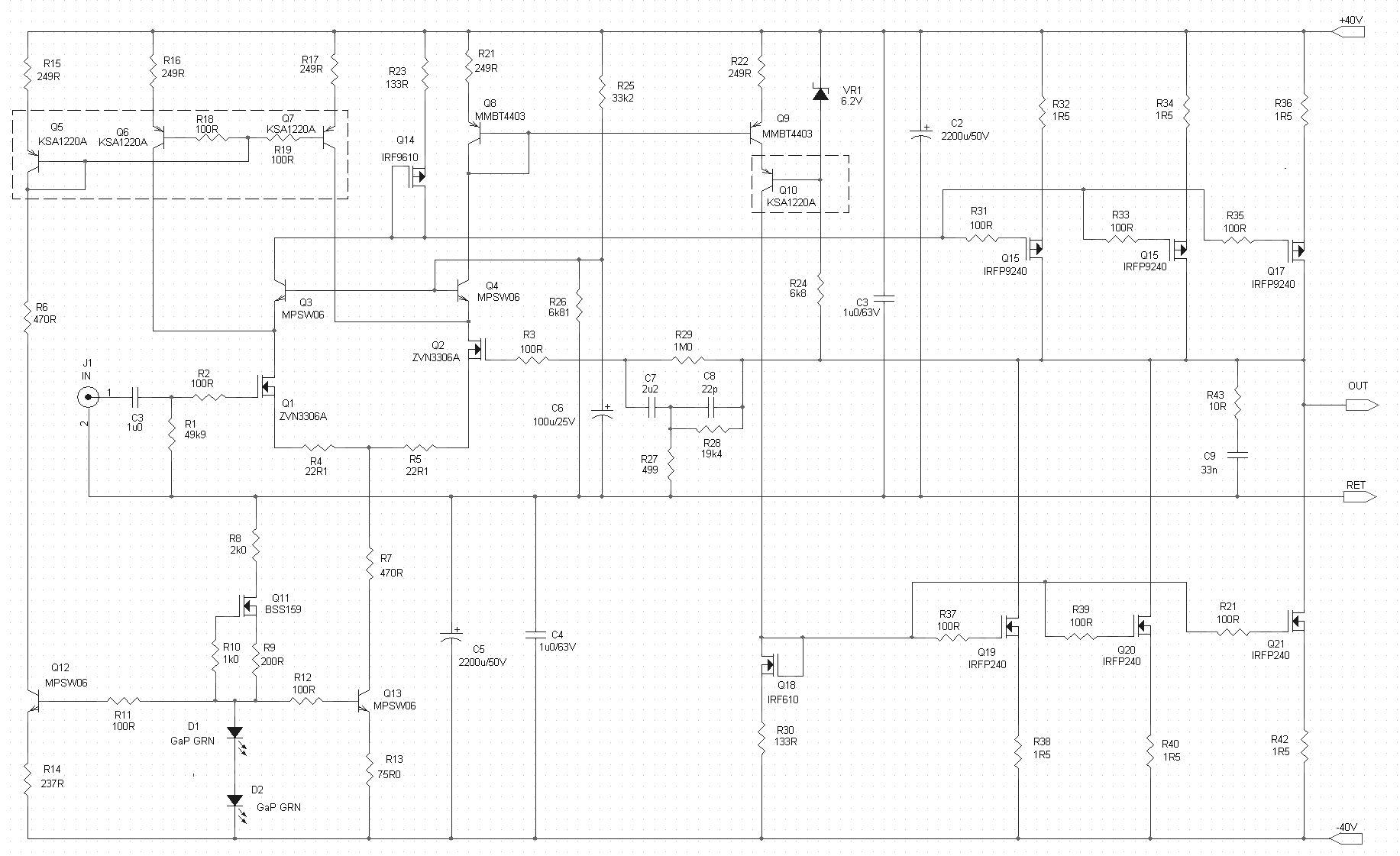

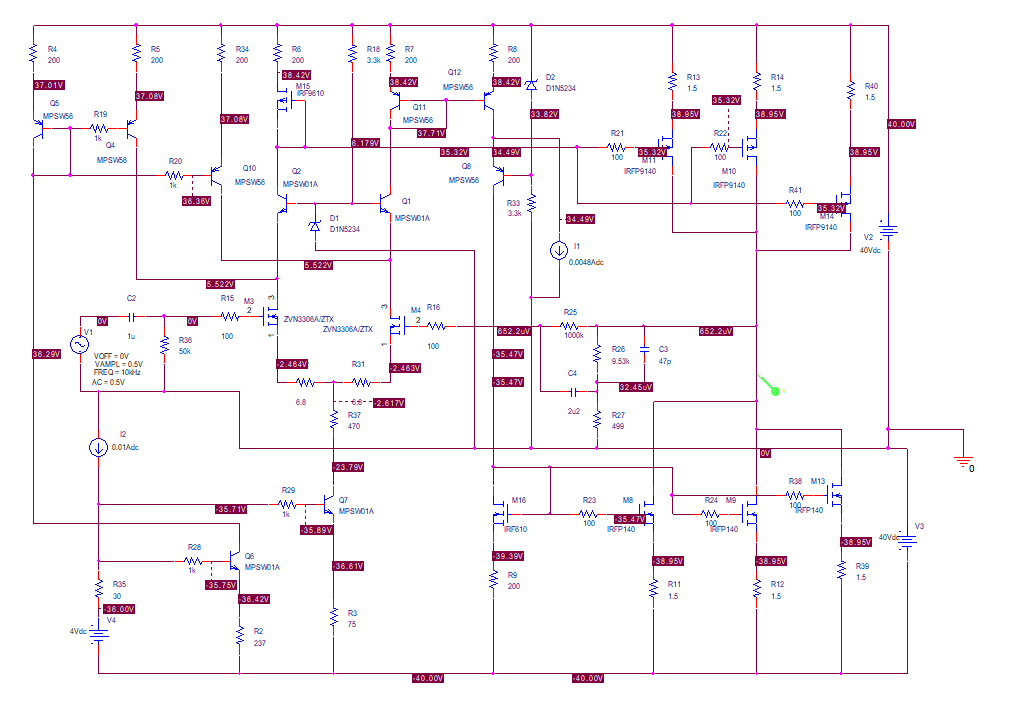

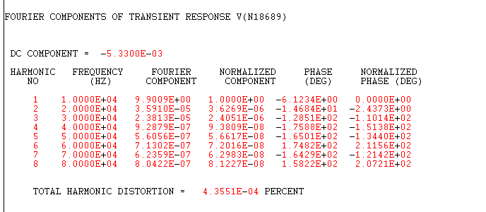

Back around post #40 of this thread, I shared a circuit that included some supplemental current sources to add bias to the input differential amplifier, making the required current swing for full output a smaller percentage of the tail current, lowering distortion by quite a bit. The amp will also require a servo to trim the output offset. I finally got off my behind and laid out boards for both the amp and servo, and they're in process at PCBWAY. As a foretaste of things to come, attached is a sim of the current version of the amp and simmed distortion plot.

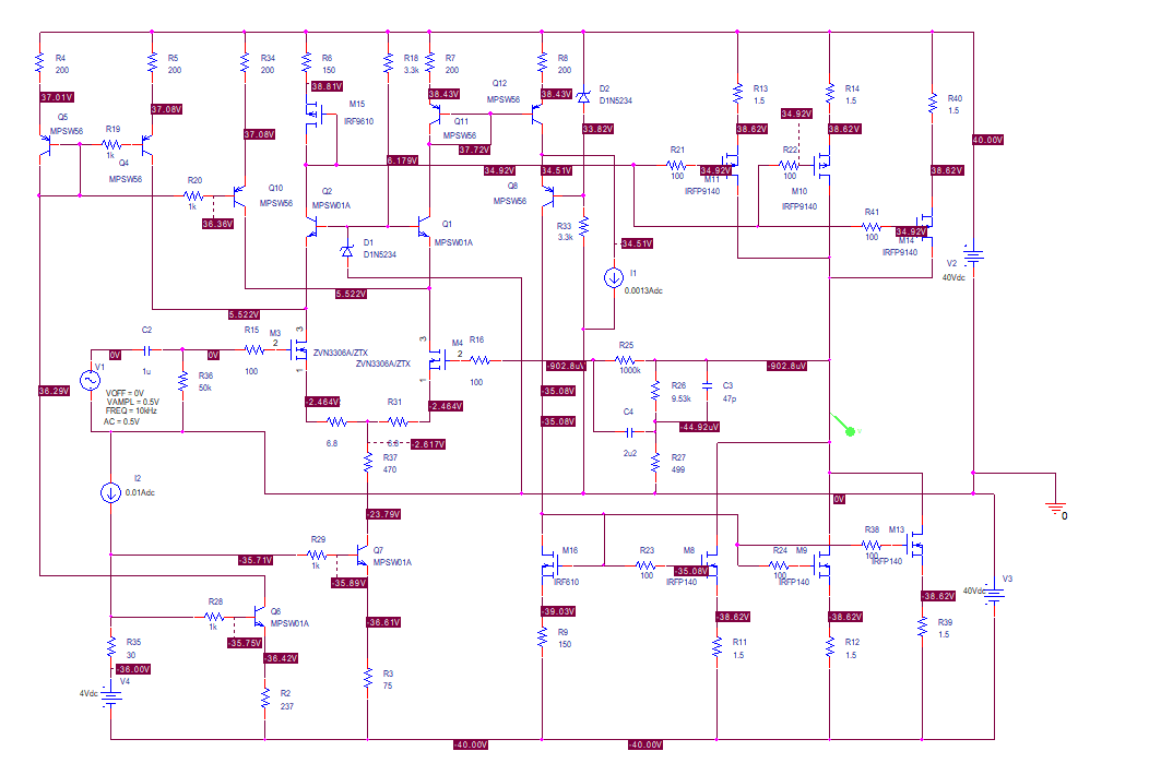

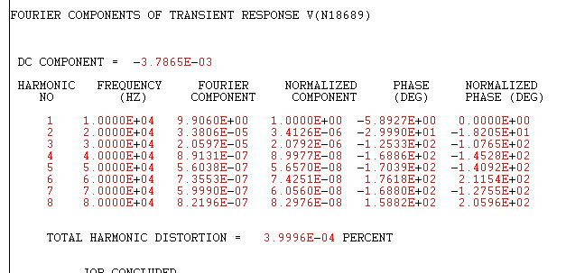

Good catch - I don't know how the sim worked as well as it did with M15 backwards. I re-ran the sim with M15 right side up, and the amount of current for servo correction went way down. I also had to change the value of source resistor on both mirror fets. Rest assured that the corresponding fet on my layout is wired in correctly...

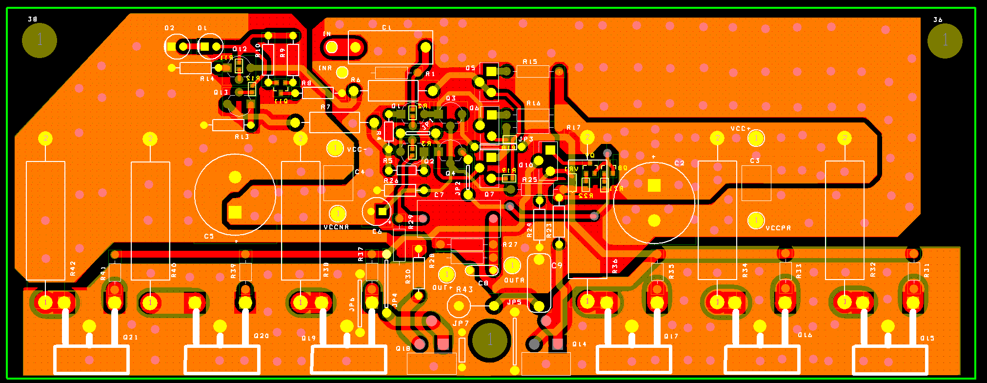

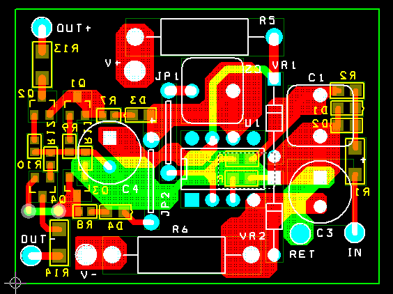

Here's the main and servo boards for the current version of this project. I dropped in a lot of vias to stitch together the power, ground and output top and bottom areas.The servo wil be bodged in place on top of the main board with a number of flying leads.
Boards are in - populating them will take a while, as there are a lot of devices to select. (outputs AAAAAND inputs).
Selected input diff pair and N-channel outputs. I had to re-order IRFP9240 because I couldn't find the ones I supposedly have...
I Got my IRFP9240s today, as well as a healthy population of IRF9610. I will be matching both mirror fets (Q14 and Q18), and hopefully will be able to match a set of the IRFP9240s close to the Vf of the IRFP240s I've already matched. The should mean less work for the servo to attain minimum output offset.
I also have the option of using IRFP9140. for the topside outputs, as they may match up better with their n-channel siblings on the bottom side.
