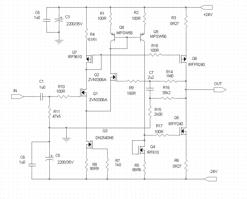

"Le Mutant" Class A
Attached is a pic of a new Class A amp prototype inspired by my work with the "Half Nelson" amp described elsewhere in the Pass Labs forum, and also as a result of a little email back-and-forth between me and Papa after last year's Burning Amp. It solves a few of the problems I encountered with the Half Nelson, at the cost of a tiny bit of extra complexity (actually, the parts count is probably very similar between the two - I'd have to open up both schematics and do a head count).The new design also eliminated a lot of nasty coupling caps.Schematic will follow when I get the thing powered up and nail down the bias values. I'm also working on a version of the Half Nelson using the Semisouth R085 jfet, but that one is on hold for a while, as this amp may be easier to spit out. I'm also working on a tube-type design using an R085, but that will be the subject of another thread. Burning Amp should be interesting this year...

Attached is a tentative schematic for the Le Mutant. I have both channels running thermally stable (one at a time) with a bias current of ~1.5A. Even with such a large heat sink, it gets real hot, so there will most likely be a toned down DC fan to augment cooling. I've made no attempt to pre-select or match output/bias FETs, so each channel needs individual tweaking for both the bias current and so that the input differential stage is in balance with no signal. Right now, I'm getting about 18mV of output offset for each channel, not too bad for the first attempt. The resistors to tweak are R4 and R5. A 2.2K resistor was added in series with the collector of Q9 to reduce its power dissipation. It still runs considerably hotter than Q8, unbalancing the mirror somewhat. A subsequent version of this amp will use some nice Fairchild TO-126 devices coupled to a common heat sink. I will also investigate what can be accomplished by selecting/matching Q4-Q7. I may also add a pot to help tweak in the bias.
The 2200uF capacitors on each rail are only the local bypassing. The main filter caps will be much more massive.
I still have some work to do before I unleash this thing on some speakers, but it won't be too long.

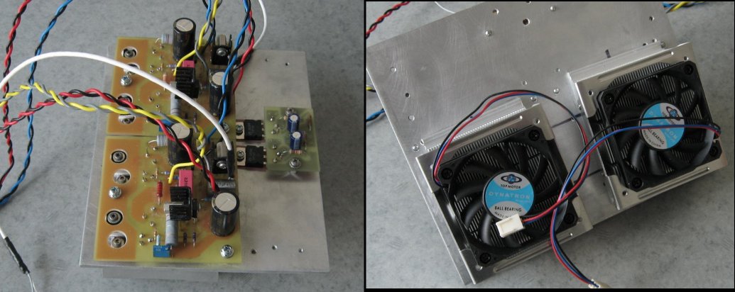

I took the mutie off the big heat sink. As of tonight, both channels are on an aluminum heat spreader plate with a pair of microprocessor coolers on the back side to pull heat out. It's a much more compact setup. Next is to complete the new amp modules incorporating the changes I mentioned in the last post, as well as matching up some output devices. I should be powering this baby up in the next week or so.

Q4 and Q7 are indeed mounted right next to their respective output devices on the heat sink. Bias was stable when I fired up the first revision of this circuit. In the next revision, I have added a pot to tweak in the bias/balance, and have changed the mirror transistors to TO-126 devices on a common heat sink, in addition to a resistor to help equalize power dissipation. I need to sit down and sort some mosfets before I can finish populating the next revision boards. I'm expecting that the better matching will improve DC offset a bit. The next schematic will follow when I have the boards populated and tested.

Here's a picture of the new modules for the mutant bolted to a common heat spreader, with CPU coolers attached on the other side directly over the output devices. One channel biases up ok, the other has a problem which is likely to be a cold solder joint or a solder splash, as there's not a whole lot to go wrong with the circuit. I have to take the whole thing apart anyway to put some thermal grease on the CPU coolers, so its not a biggie to get the bad module sorted out at the same time. I'd say I'm close to getting some tunes out of this thing, even if it's just using a bench supply. I suspect that this amp will likely show up at Burning Amp with the same sort of impromptu setup I'm using for the "Half Nelson" (well, maybe a little prettier, but not by much).

I found the problem in the bad channel (open solder joint), and now both channels bias up the same. The CPU coolers definitely do their bit in reducing the temperature of the heat spreader.They're not really all that loud, even at full blast. The bias current is a little over my optimum (1.6A-1.7A vs. 1.5A). As soon as I get that tweaked to my satisfaction, it's tune time, even if I have to use a bench supply. This amp will get the 2 X 20V Antek toroid from my "Half-Nelson", which will in turn get one of the toroids I scored from Papa at the first Burning Amp in 2007.

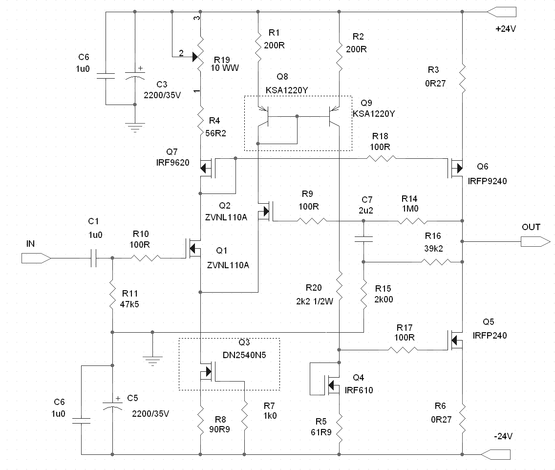

Attached is the mutant that will be slouching its way over to this year's Burning Amp. I ended up with selected IRFP9240s instead of the IXYS P-channel guys I wanted to try, as I was able to select a pair of the IRFs that were a closer to the IRFP240s I had on hand than any of the IXYS fets. I ran both channels of the amp using my bench supply at work, and the sound was OK, but there were some issues with asymmetric supply rails, as the amps were really taking more current than the bench supply could handle without going into limiting on one side. I'll expect better results with a solid DC supply - in the works.

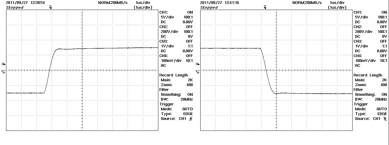

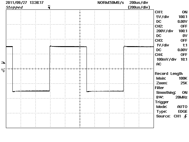

I'm very happy with the square wave response - attached is a photo of the overall square wave response.
