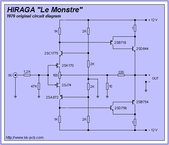

I'm still in the parts collection stage, but still up in the air regarding which of these designs to build. Can anyone offer subjective opinion on these designs? The JLH looks nice and uses 4 output devices so I would assume it dissipates heat a bit better. Plus it uses TO-3 devices which my sinks are already tapped for.
Le Monstre looks simpler, and I can alter my sinks to use the 2SC5200s. It claims 58w into 8 ohms rms while the JLH is only 28w into 8 ohms, but will double into 4 ohms at 56w.
What design would you guys reccommend? What are your impressions of the sound quality of these designs?
Thanks for any information on these! Also, what size transformer is reccommended for these?

I wonder what your needs are for power - what kind of speakers (impedance, sensitivity) and how loud you want to go. I suspect that 28W is plenty of power for your needs and shouldn't be a factor in choosing between these options. Power dissipation might be a factor, the lower power of the JLH means less heat-sinking. I haven't heard either amplifier, but I have read many consistent good reports on the JLH and it would be my choice if I had to make it.

... the JLH is only 28w into 8 ohms, but will double into 4 ohms at 56w.
Blair
This is not true! 😱
It says in the JLH article that this is the case on 22v rails. Is the article mistaken?
Would you care to elaborate?
Blair
Blair
Hi deicde67, I do believe you are mistaken about the le monster it's output is ~7 watts
per channel.

There is a version using more modern transistors 2SC5200/1934 IIRC that put out over 50w.
The original circuit only put out ~7w.
I'll try to find the link.

The only issue with that board is that it is not the higher power version I'm looking for. The link provided to me earlier in this thread:
http://skycoral.com/1/?p=23
seems to be my best option as Geoff, the gentleman referenced on JLH's site supposidly assisted in the design process.

Yes Woody,
The amplifier circuit I'm referencing is a variation on a variation of that circuit using higher power transistors. I believe it has an additional driver stage, but I'm no SS guy so I may be mistaken.
While the original Le Monstre and JLH look like simple and easy circuits to build, I'm looking for something with a little more power.
