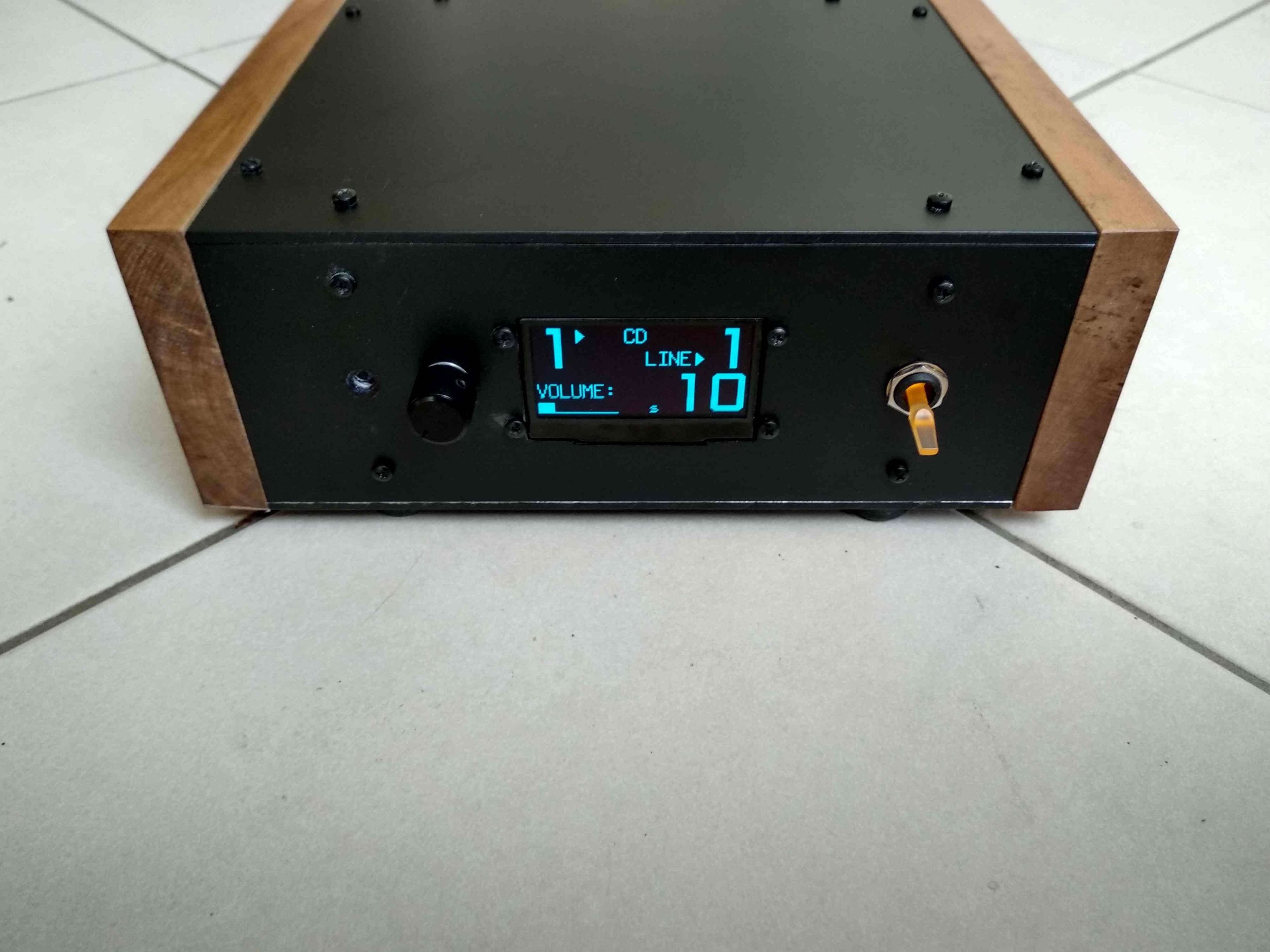

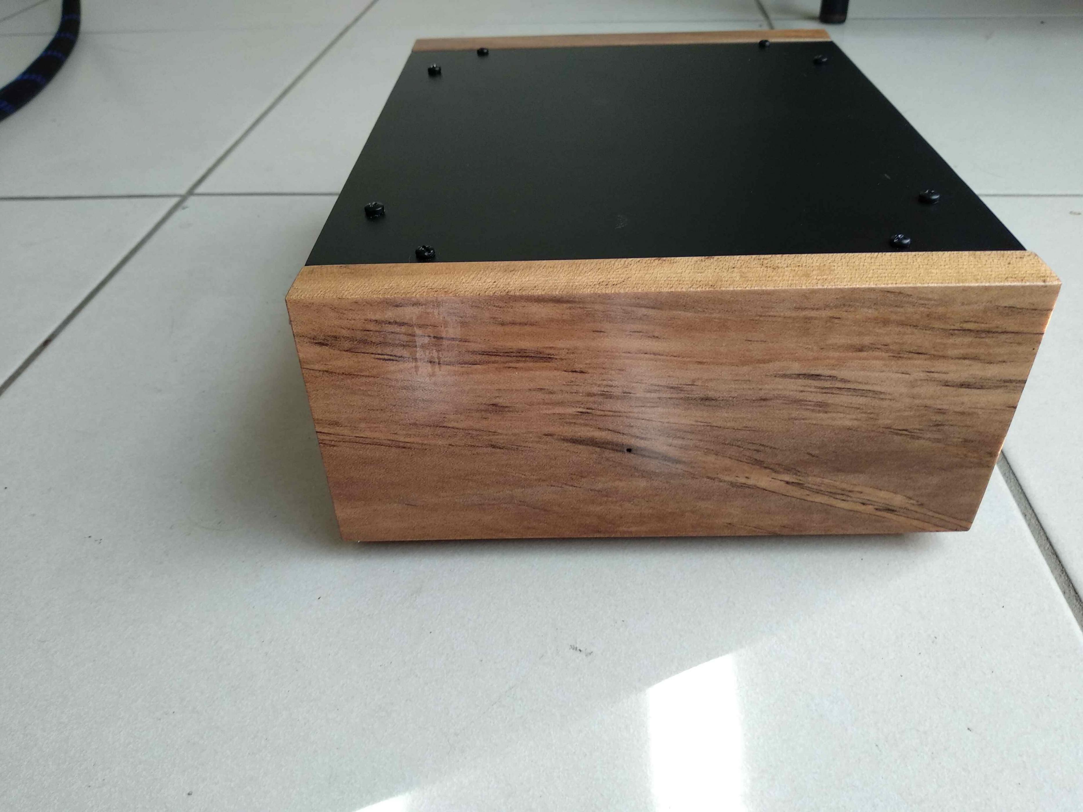

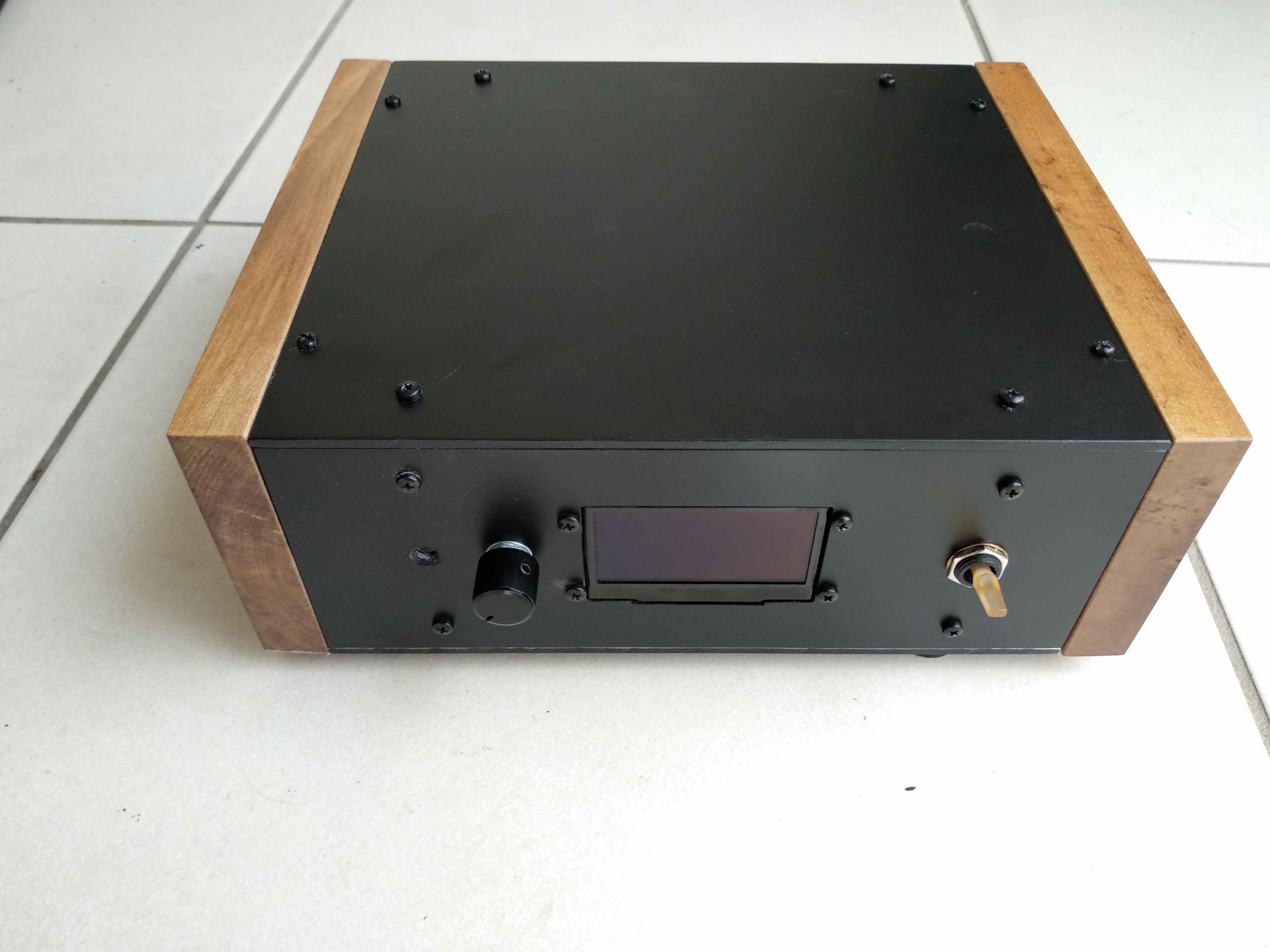

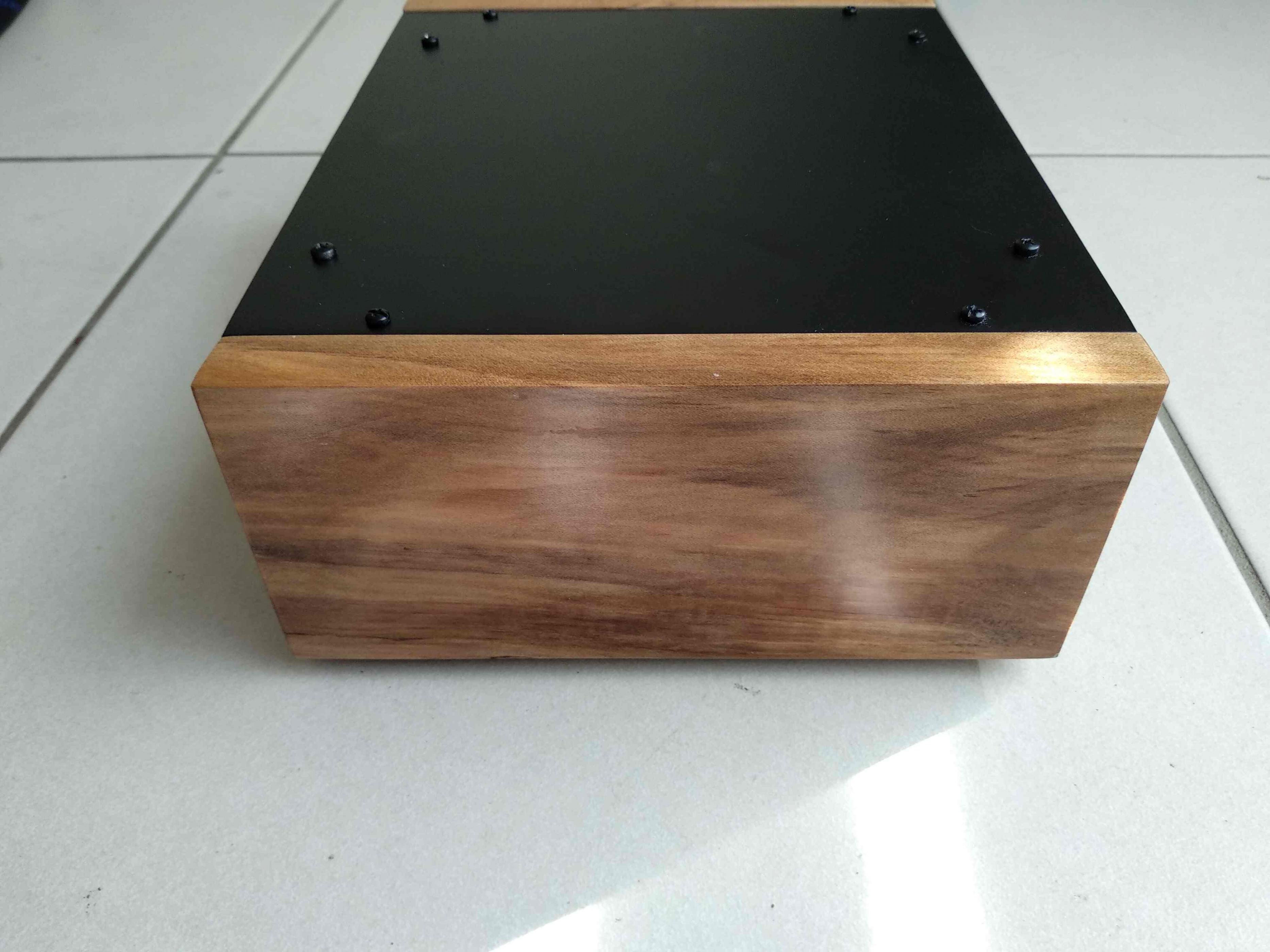

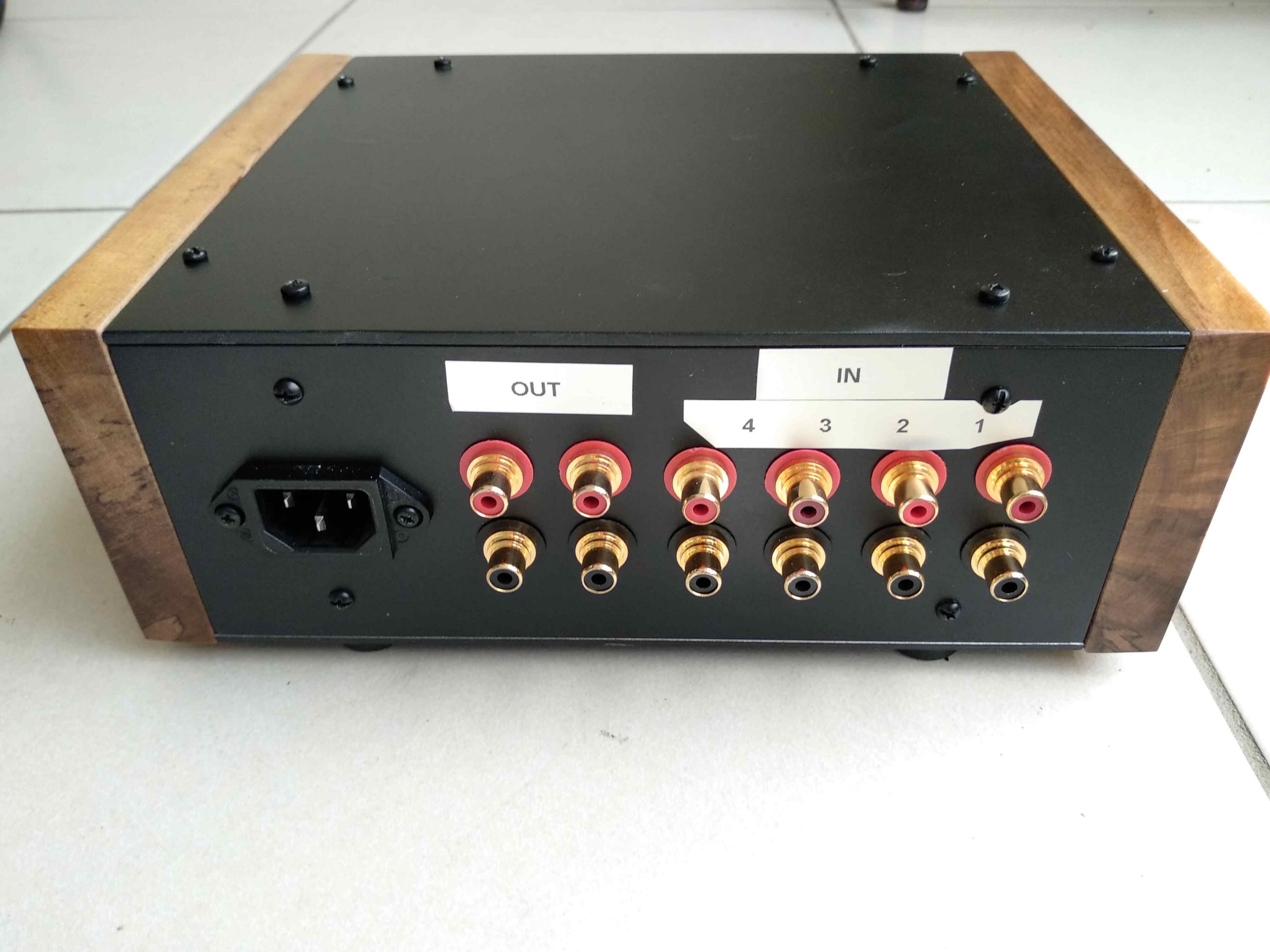

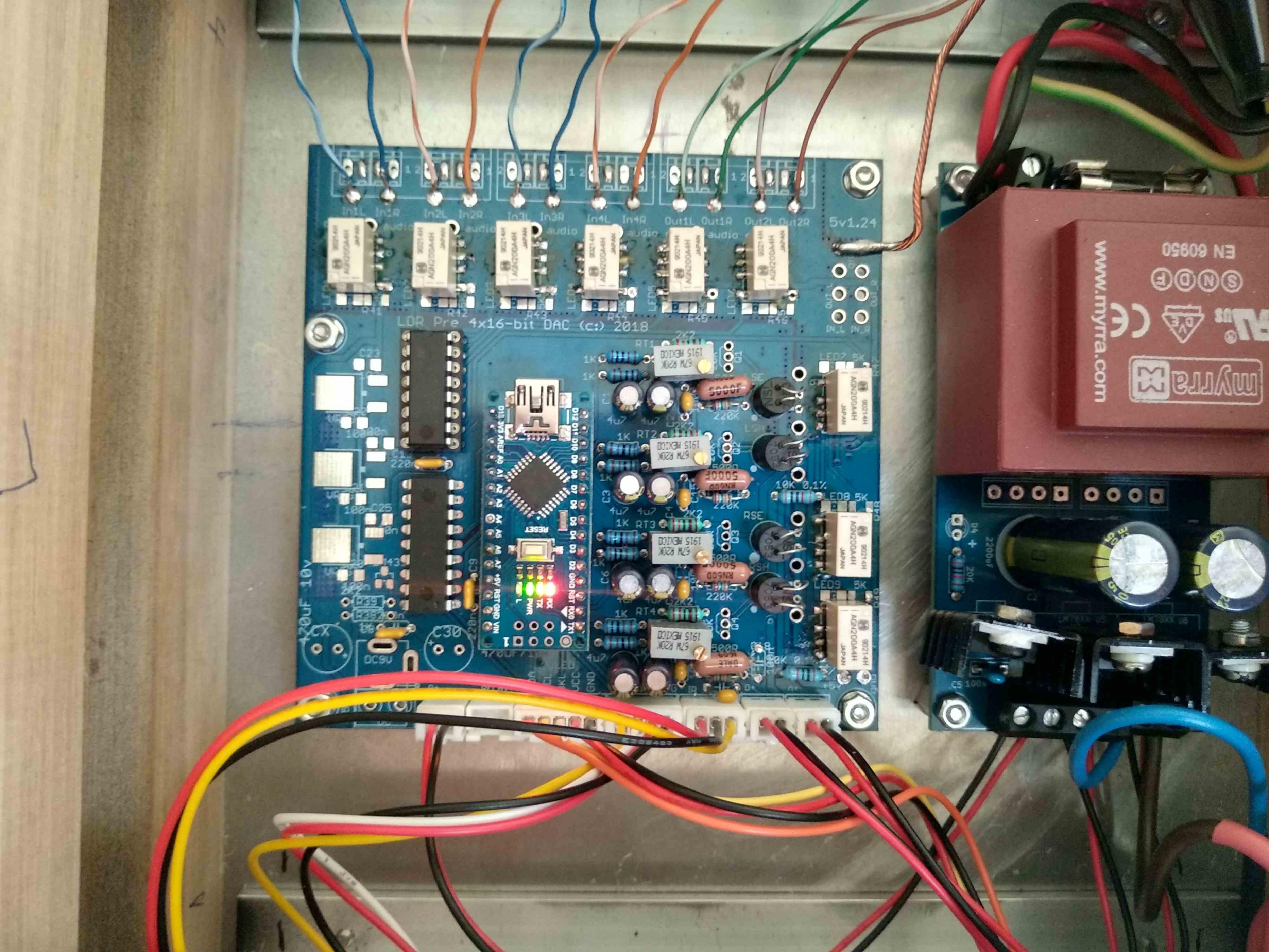

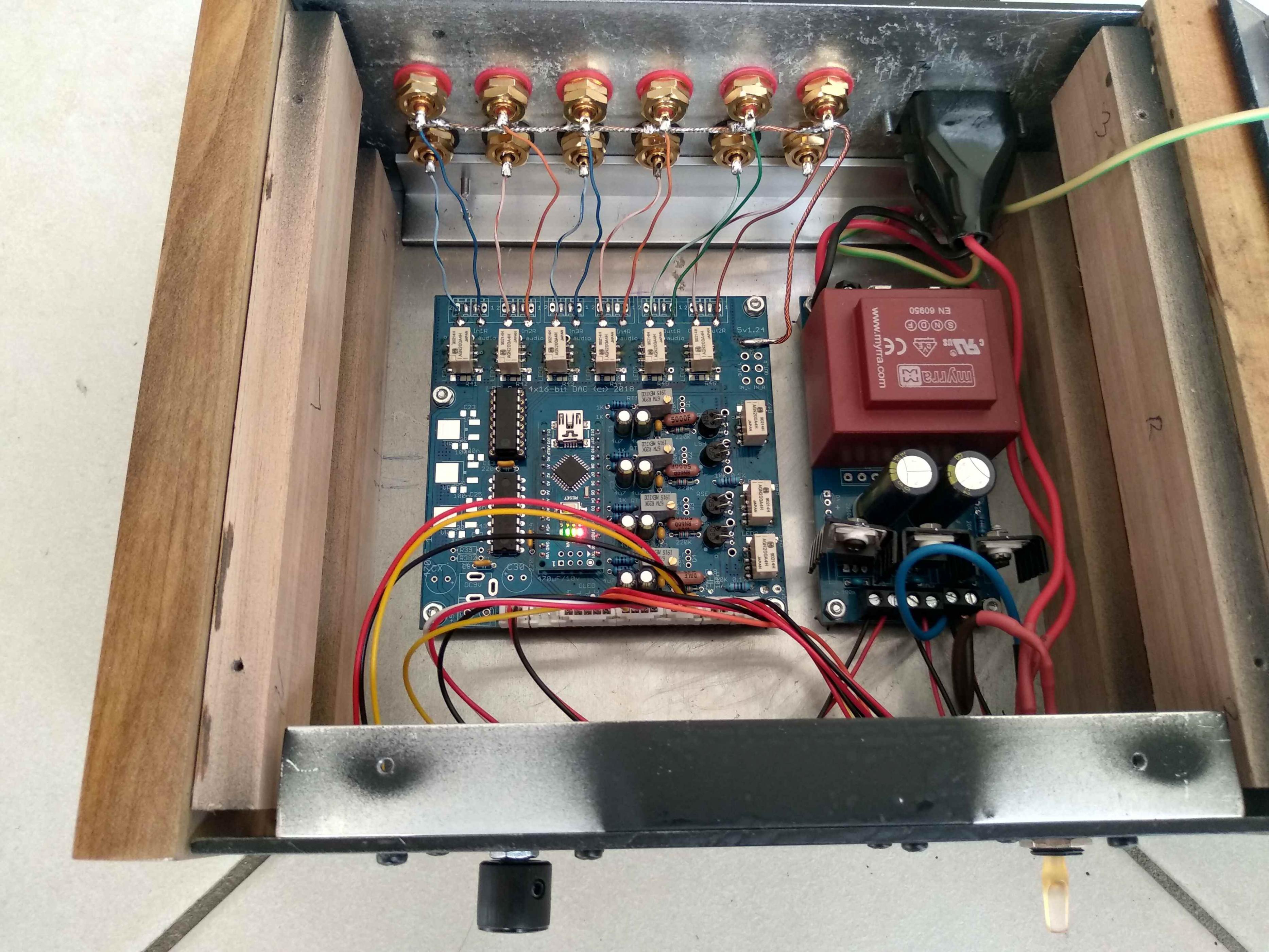

Here are some pics of the finished product. I have found that on previous LDR attenuators I have built that the centre balance can move over time. Since this has calibration smarts, it will be able to be recalibrated if needed again at a later stage. Thanks for providing this project ZDR.

I have continuity between sda and sdl from the arduino and the header. I tried to put 5vdc to red and black and still nothing. Should the BKL wire be hooked up somewhere?
Honestly I think the LCD is faulty I fully expect something to happen on the screen whether good or bad. I think I may just order the wide.hk one.
Also I notice if I power up the unit without the screen attached the lights on the arduino all light up for a few seconds then only the green stays on. With the screen attached only the green comes on.
Ok a little troubleshooting on the oled
vcc to gnd 5.02 vdc
SDA to gnd 5.02 vdc -------sda pin to pin out 2.2k
SCL to gnd 5.02 vdc -------scl pin to pin out 2.2k
shouldn't the scl and sda be around 3.3 vdc?
I do notice that if the yellow and orange are hooked up to the oled no relays click and only the green light come on the arduino
without yellow and green TX and RX come on for a few seconds then go to green only and i hear a relay(s) click
Shorting the yellow and orange also produces a green arduino light only(no oled hooked up) hence my assumption that the oled is faulty.
I have taken the arduino reflashed and resoldered it back in and have also reflowed all other connections, still no good results.
I have ordered the wide.hk oleds with hopes that it is the OLED.
