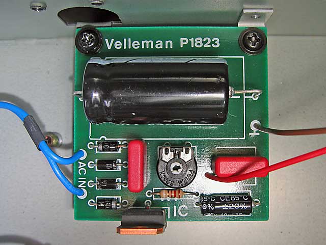

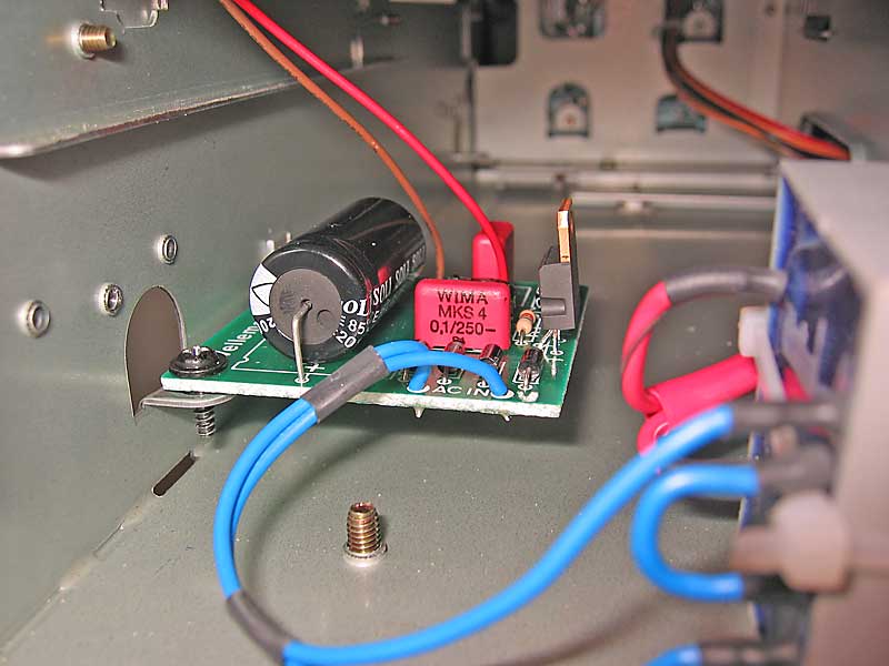

After a lot of test, here is my last contribution to this topic :
The best solution for me is to use the Cuno's PSU with a pre-regulation and a new transformator (i use a Velleman KIT ref : K1823). I think the problem was due to find a good alimentation line on the board of the VRDS. His PSU is very complex and there is a lot of trap to recuperate a goog line, specialy with the Cuno's PSU.
Concerning the most important : THE SOUND !
I don't notice a large improvement. Maybe high frequencies are more bright, but i think i'm too old to ear a significant difference.

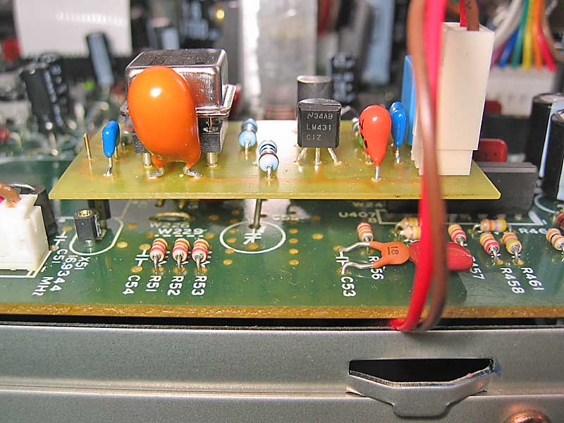

Leave it on for some days as the module needs some time to break in. It definitely performs sub-standard the first few hours of operation.
Stupid question: you did remove the orange trimmer, did you ?
OPA -- you must have a nice "macro" lens on your camera -- the pictures are quite informative.
If you have to "trim" consider using a twisted-pair (CAT-5 wire is OK) a few centimeters will give you enough picorarads to shift the frequency a few hundred Hz.
Just from my ham radio days -- the next step would be to take the XO, box it up (with some spare PCB material) and temperature stabilize it -- you can use a resistor as the heating element and a diode as the temperature sensor, or a centigrade sensor from Nat Semi.

Ah yes, that's my findings too, and also what I posted some pages before on this thread.
Anyway, when I first ordered my Tent clocks and used them them for the first time, I knew this was going to happen.
My Philips CD650 played horrible sounds on the first power-on.
I left it playing, and an hour later...😱
I have a good "vice" of reading the docs, so I knew this was going to happen.
This is on a doc Guido kindly sent me. At the end of the doc, "Customer satisfaction":😎
"Hi Guido,
Last Saturday I managed to squeeze that crystal oscillator inside my PhilipsCD471 ………………. It sounded terrible !!!!
Until an hour later ……now it is perfect J
I never realised that crystals need to break-in, I do not know, but now I got the result. Overall performance is cleaner, tight !"

The crystal is actually stabilizing its frequency with temperature -- that's why "ovenizing" the XO is a good idea.
Stabilizing it's frequency with temperature?😕
