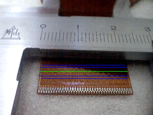

At first glance that cable looks like a double row, 0.3mm FPC connector (as has been said before), however 75 way isn't a common number of connections.
Has anyone had any joy coming up with a solution yet? It may be possible to extend it using a 90 way cable but it would need to be cut incredibly accurately to fit in the connector.

ywh - What is the other end of the cable like? I take it that it's directly soldered / fixed to the other board? From your pictures it's a lot wider and therefore maybe easier to work with however there's not enough res to see what's going on properly.

I'm currently under the impression that the university that I'm doing my doctorate at has the capability to manufacture custom FFC/FPC cables although I haven't confirmed how easy it is to get them to do this or how much it will cost. I'm also not sure if they could do double row or not.

OK a thought to just throw out there...........Attached is a masterpiece of an Artists rendition of what IM thinking 🙂 OK why not cut the flex cable ( Yikes) find the pitch of each of the "2" sets of contacts. Then use the appropriate FFC's(assuming some will work) and Clamp them Onto Edges of the FFC that have been sanded off........one above the other one on both sides of the FFC. Still sounds like a SOB to do But perhaps less work then hand soldering...........Any thoughts?????

With an extraordinarily small-tipped soldering iron and a steady hand, extending this cable should not be so very difficult. Is quality soldering such a rare skill that this is an insurmountable challenge?
Don't tell me that this is the only reason nobody much is using these screens. Sure it's really fine work, but if there's solder at both ends, a good tech can do it.
I've never seen soldering iron tips quite that fine, and my hands definitely aren't steady enough to solder those wires. Remember the wires are 0.3mm spacing, that's over 3 wires in every mm, I think I'd struggle to see them! Using surface mount soldering might be an option...
Digitalview.com has several controller boards that would support this monitor, some with S-video, and component connections as well. I had a hard time trying to get a price, but they have a prescence in the states and I could give them a call during the day. If the FFC is the only other problem, I think we are all capable enough to do a few solders here and there, and looking at that allinbox site I know I could do a better job than that guy! all you need is one of those magnifying glass dealies with the aliigator clips that hold things for you while you work.

Careful with the broad brush! 0.3mm pitch is doable but Very Fine Work. The pictures on the links are about what a pretty-good solder tech can do with small lands to solder to. A really top-notch pretty job would be several skill levels higher and probably take a much longer time.
