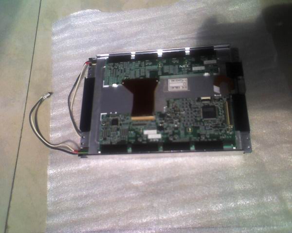

i have seen it
i have seen the lcd,
i can not extend the filmy cable, too hard!!
the cable is double row lattice,
The FFC of NEC 6.3
I have contacted a local shop that speciallized in extending FFC cables.
They can cut the cable and then solder thin wires to extend FFC. It's
tidious and labor intensive. good thing is labor is inexpensive here.
On chinese DIY market, a whole set of DIY parts for EZpro serie LCD
projectors is available, including lens, fresnels, mirrors, even steel
cases. EZpro projectors use 6.4" LCD. It is very easy to use those
parts on the 6.3" NEC LCD. and best of all, all optics are matched.
Once FFC extension problem solved I will make one base on this XGA
LCD.

the pic
why don't you buy something like that; a ffc extension; costs about 25$...
I don’t think that a FCC of that pitch and orientation is easily available.
DJ
it is double row ,
not single row.
i have never seen a double row FFC
I have found 0.3mm pitch FFC connectors. They accept double row FFC like ywh posted. Now, could someone find 0.3mm pitch cables?
The ones on above pic by YWH is not a FFC cable as far as i know.
They are called FPC.Not?
and to 18wheeler.... is it confirmed that the cable shown here
has the 0.3mm pitch or is it referring to the connectors?
http://www.newproduct.molex.com/FeatureHelp.aspx?lang=fr-fr&featureid=108&fam=ffcpn . Here you'll find
a similar cable type but with 0.625mm pitch.Perhaps this is the one?
This must be the thread my friend was telling me to find... it too seems to have died with no definitive information though. Anyone know whether this NEC is workable or not?
I have a lot of interest from several people @ LumenLab when I stumbled upon this panel the other day and posted the specs.
Perhaps the two forums could do a larger group buy and save even more money -- assuming of course that the panel can be used.
