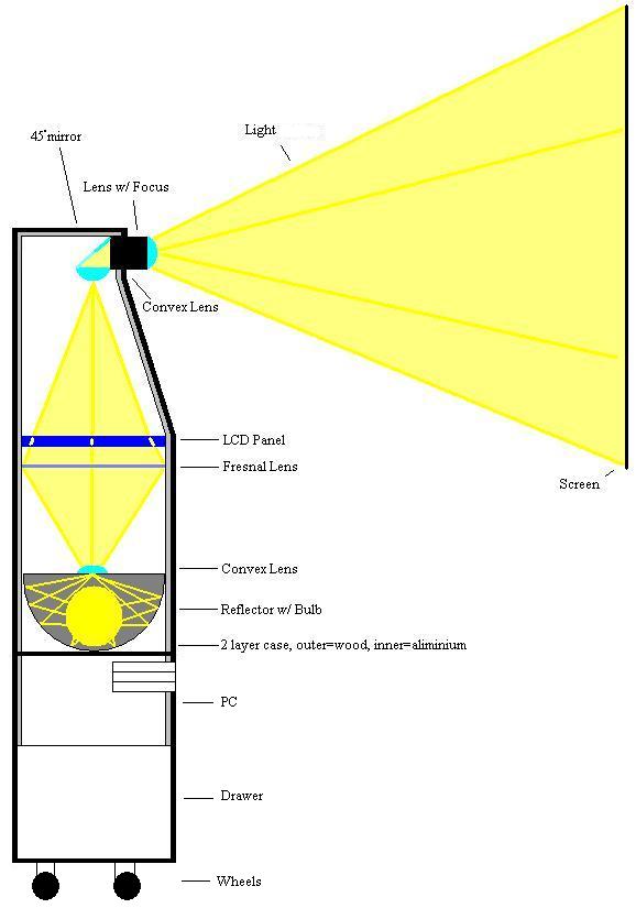

I'm not really knowledgable with this, but with that information in account, will it be possible to plug an LCD panel from a Laptop into a Desktop PC and use it as a panel for projection? What will I need specifically for this? Distance between LCD and PC isn't really an issue as I can get them as close as possible. Also, I will only really be using one LCD panel (recomendations?) and sticking with it, so it doesn't really matter about the compatibility of LCDs.
My design (been modified since my last if any of you remember seeing it) is attached, sorry for the crudeness of it.
As you can see I'm making a self-contained projector-htpc (home theatre personal computer) unit, which is even more bulky I know, but still easily mobile. The reason for it's height is so that I can just have it floor-standing at the wanted height to project the image.
Is my design doable? If the distance between LCD and PC is still too great, I can attach a side unit which will hold the PC in line with the LCD requiring only 5" of wire along with the subwoofer, reciever, etc.

I was also thinking of adding a second lcd to it, just a display controlled by the computer for dvd, and stuff. Also thinking of having it display the current temperatures inside the computer part and projector part. I can find out easily how to do the computer part, but not too sure about the projector part. Also trying to find if i can control the power to the light (make it go on or off) via the computer.

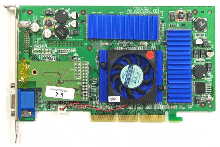

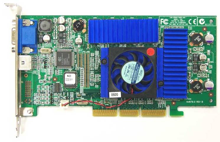

can anybody post here some diagrams/pinouts for those video cards with connector for external dvi doughter board?
i think that is the simplest and the cheapest way to do it!
and there wouldn`t be any A/D or D/A conversion, which means the best possible quality of the picture!
