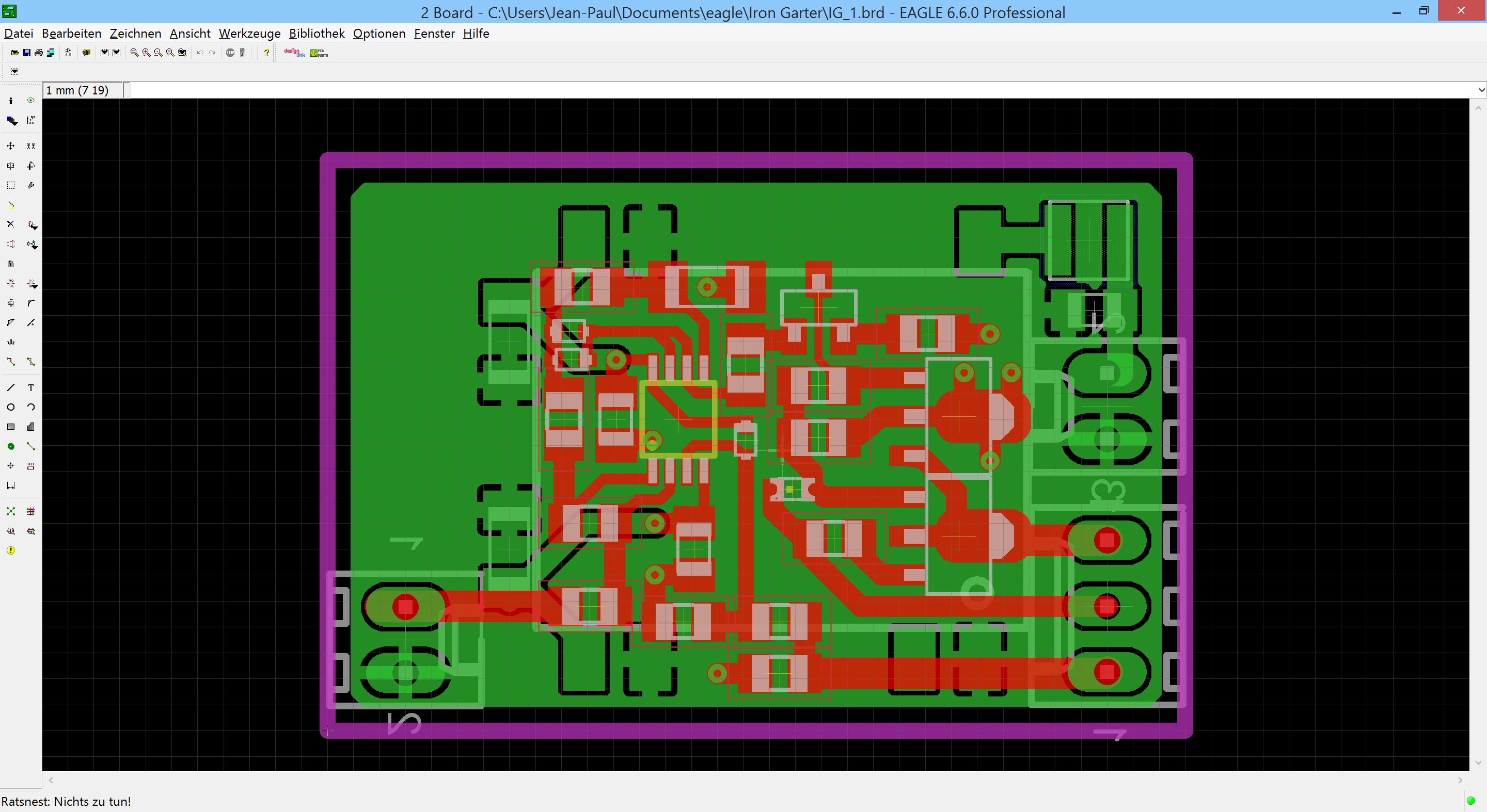

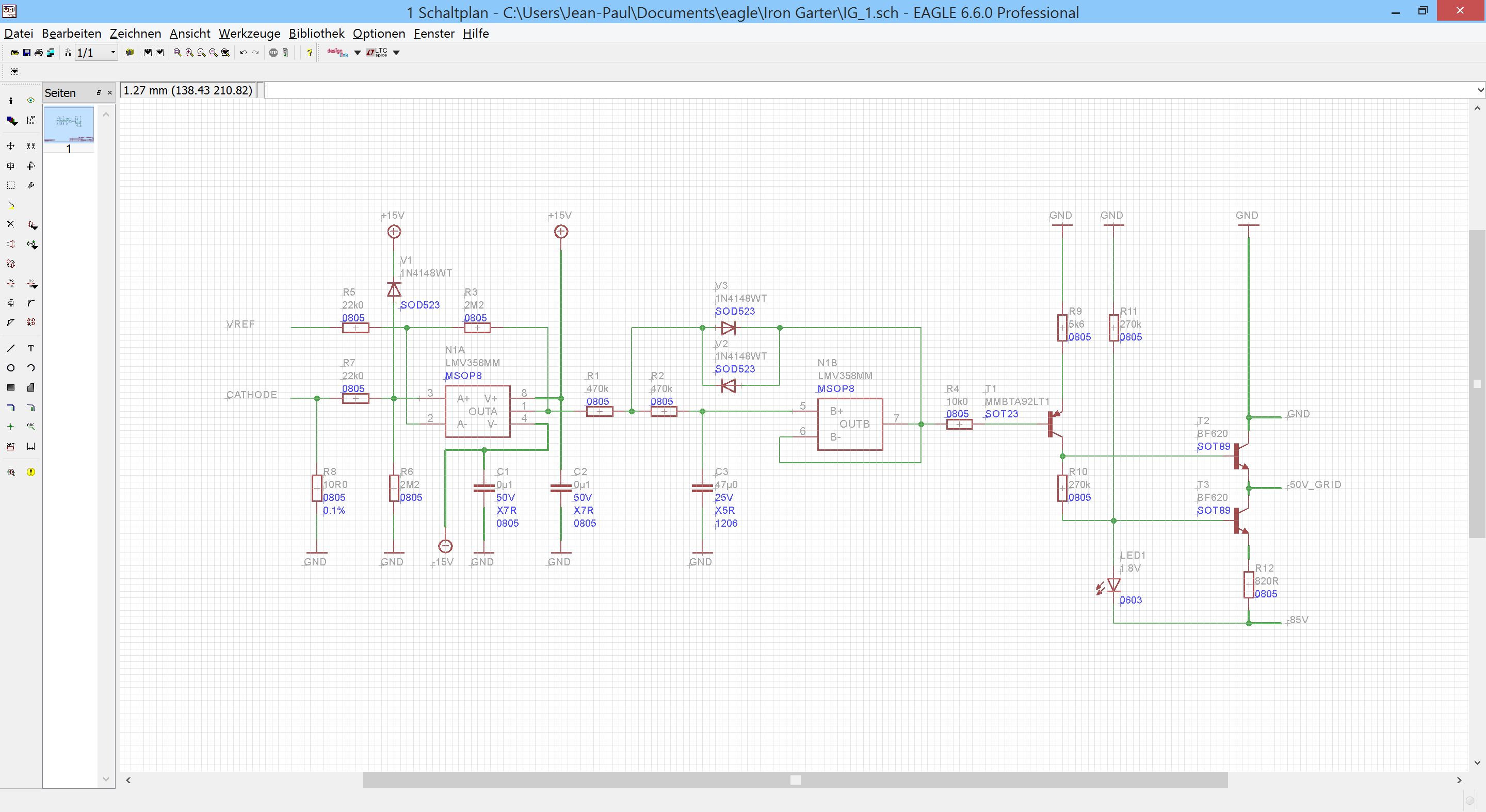

Hi JPS,
very nice offer, thank you!

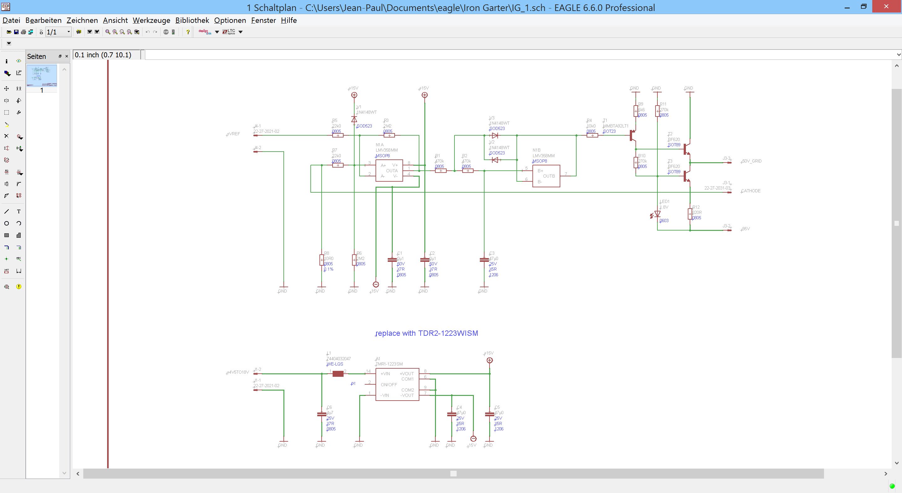

What I would like is a PCB for this bias servo circuit (I think the drawing is by Gingertube).
http://www.diyaudio.com/forums/tube...garter-push-pull-amplifier-2.html#post4460486
Each tube needs one of these servos; for stereo push pull one will therefore needs 4 of these circuits, and I think that putting everything on the same board would be good.
Maybe add a simple regulated (LM317 / LM337) power supply for the Opamps?
Cheers, Erik
Cheers, Erik
Hello Erik,
here some questions:
1) I/O: Vref (or onboard?), Cathode, Grid; -Ub (here -85V), 0V and +/-15V?
2) one board for one tube?
3) SMD possible?
4) preferences for connectors?
Jean-Paul

Hi Jean Paul,
many thanks for the first version! I have been thinking about some nice additional futures, working it out now and hope to post it soon.
Cheers! Erik
Cheers! Erik

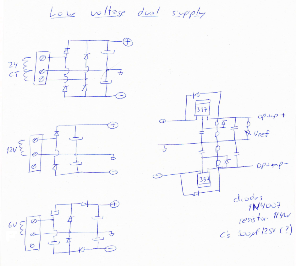

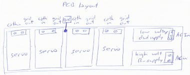

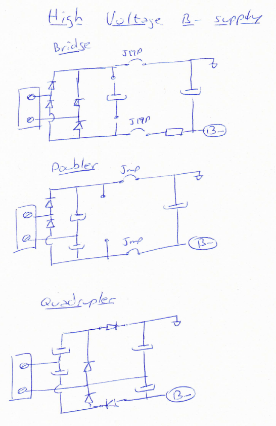

Hi Jean Paul,
I finished the schematics, all hand drawn. I hope that besides your generous offer of layouting, you are also willing to be a bit creative? 🙂 I saw your work on the 4P1L amplifier, so I reckon you have experience and interest in tube circuits as well.
For both the low voltage dual supply and the B- supply I think it would be nice to be as flexible as possible, so I draw schematics for supplies based on diode bridge, doubler and quadrupler circuit. With the quadrupler circuit one can power the opamps with +/-12V DC using a (spare) 6,3V winding.
Optional: Sometimes it is good to use DC on the input tubes of an amp, and by using a more powerful PS and by putting the LM317 / LM337 on some heatsinks one can use the Opamp supply to feed the filaments.
In the bridge, doubler or quadrupler circuit one will have to use either electrolytics or diodes, and probably some jumpers depending on which circuit one wants to use. I do think that leaving a 15mm diameter circle for every component will be enough to accomodate either the electrolytic cap or the diode?

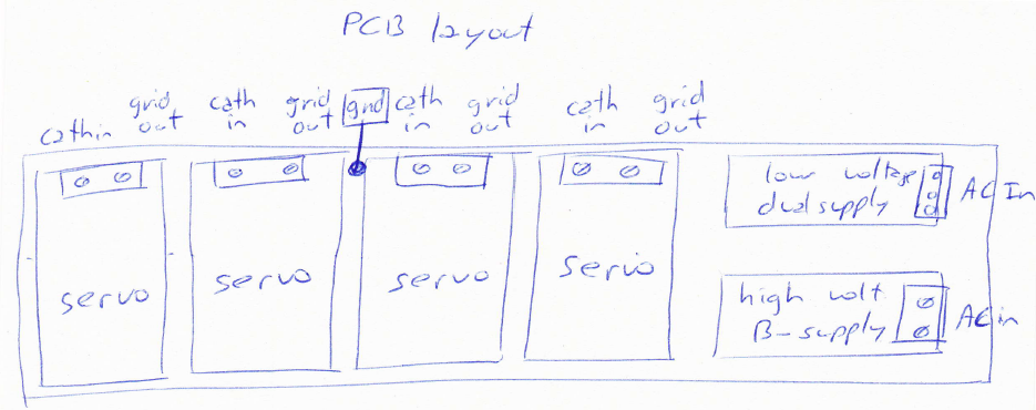

Finally, the layout for the PCB. I do think that a long and narrow board is easiest to place in a traditional tube amplifier, as the 4 output tubes (stereo push pull) are generally in one row.
For connectors I am a big fan of the 5.08mm MKDS series by Phoenix
https://www.phoenixcontact.com/onli...21&library=usen&pdfmode=direct&pdflanguage=en
and, as you see, I am quite oldfashioned: tubes, handdrawn schematics - so a throughhole board would be great!
Many thanks und freundliche Grüsse!
Erik
