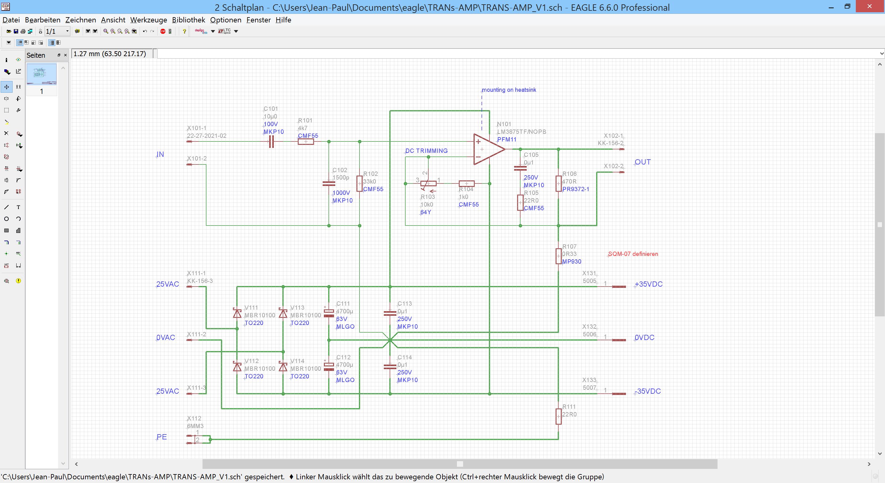

Please, can you design a pcb for this amp? is very interesting:
http://www.diyaudio.com/forums/chip...onductance-current-amplifier.html#post3564061
Yes, a cheap and very good amp.
In te original the common ground is in the two 4700uF, not in the two added 0,1uF.
Thanks a lot
Thanks a lot

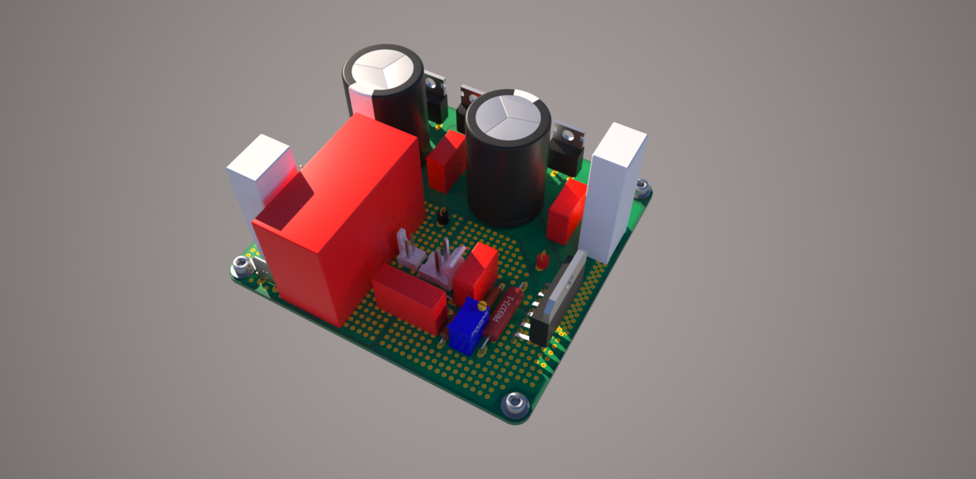

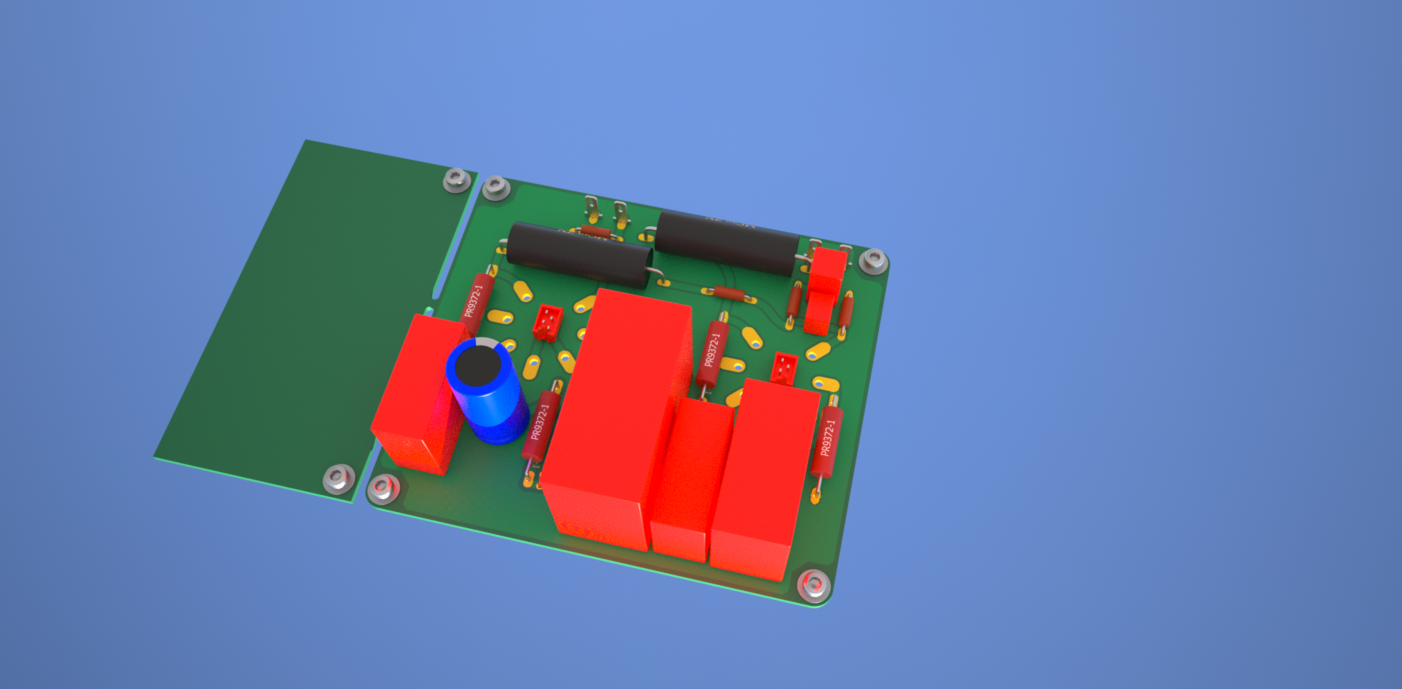

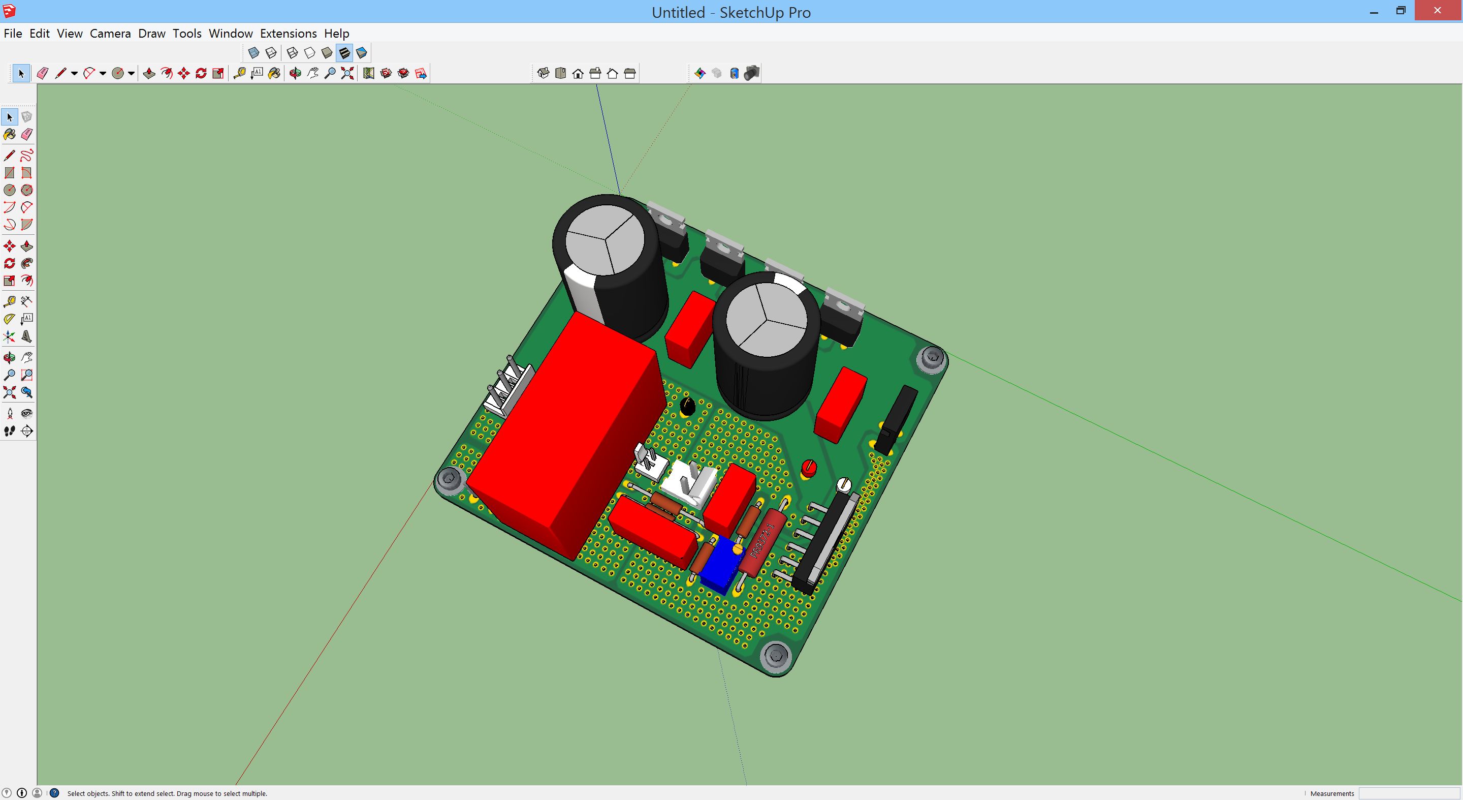

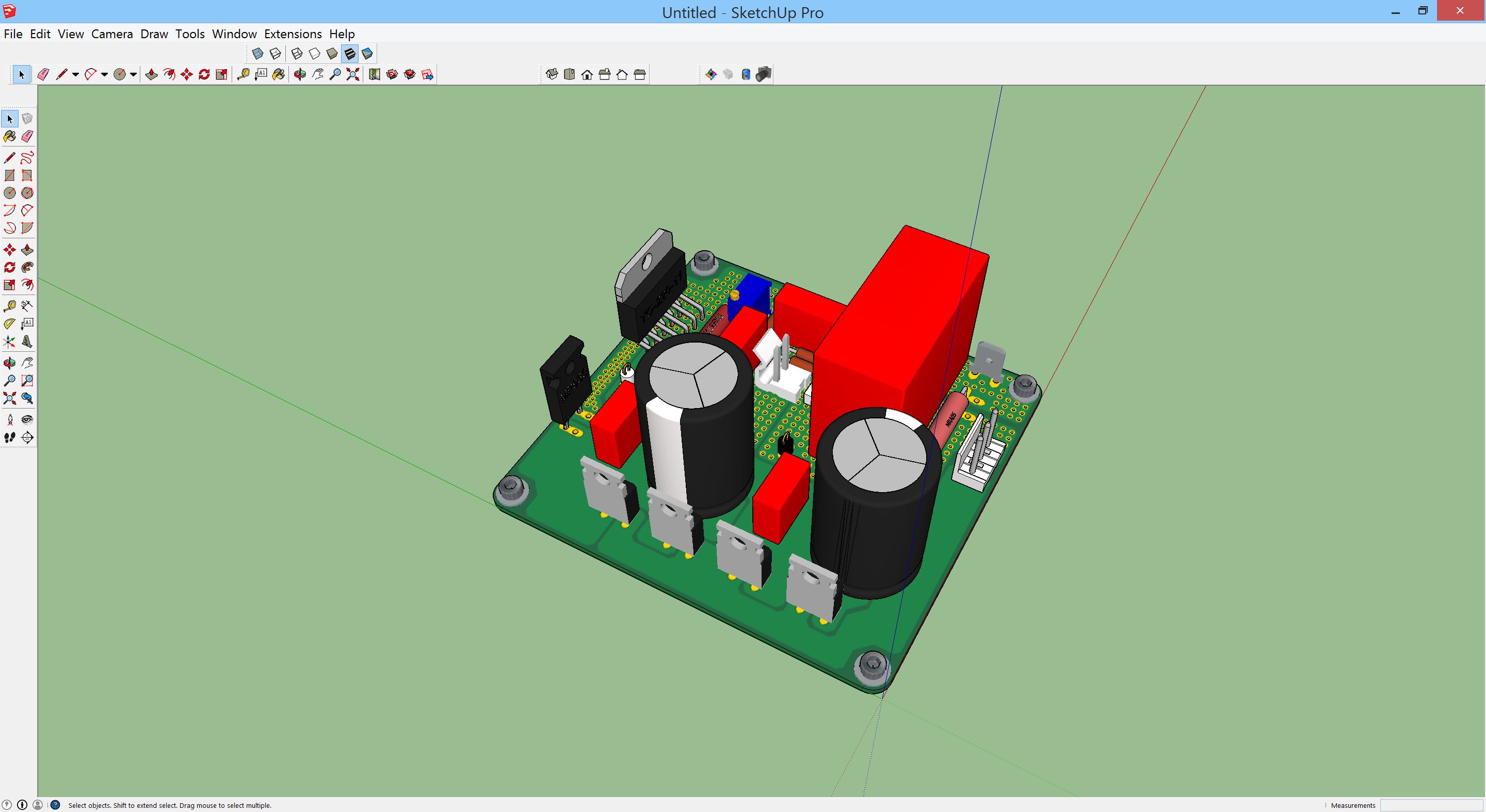

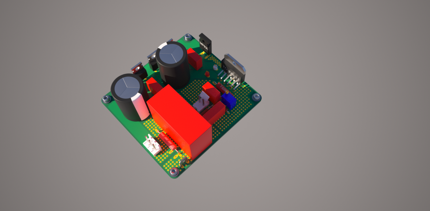

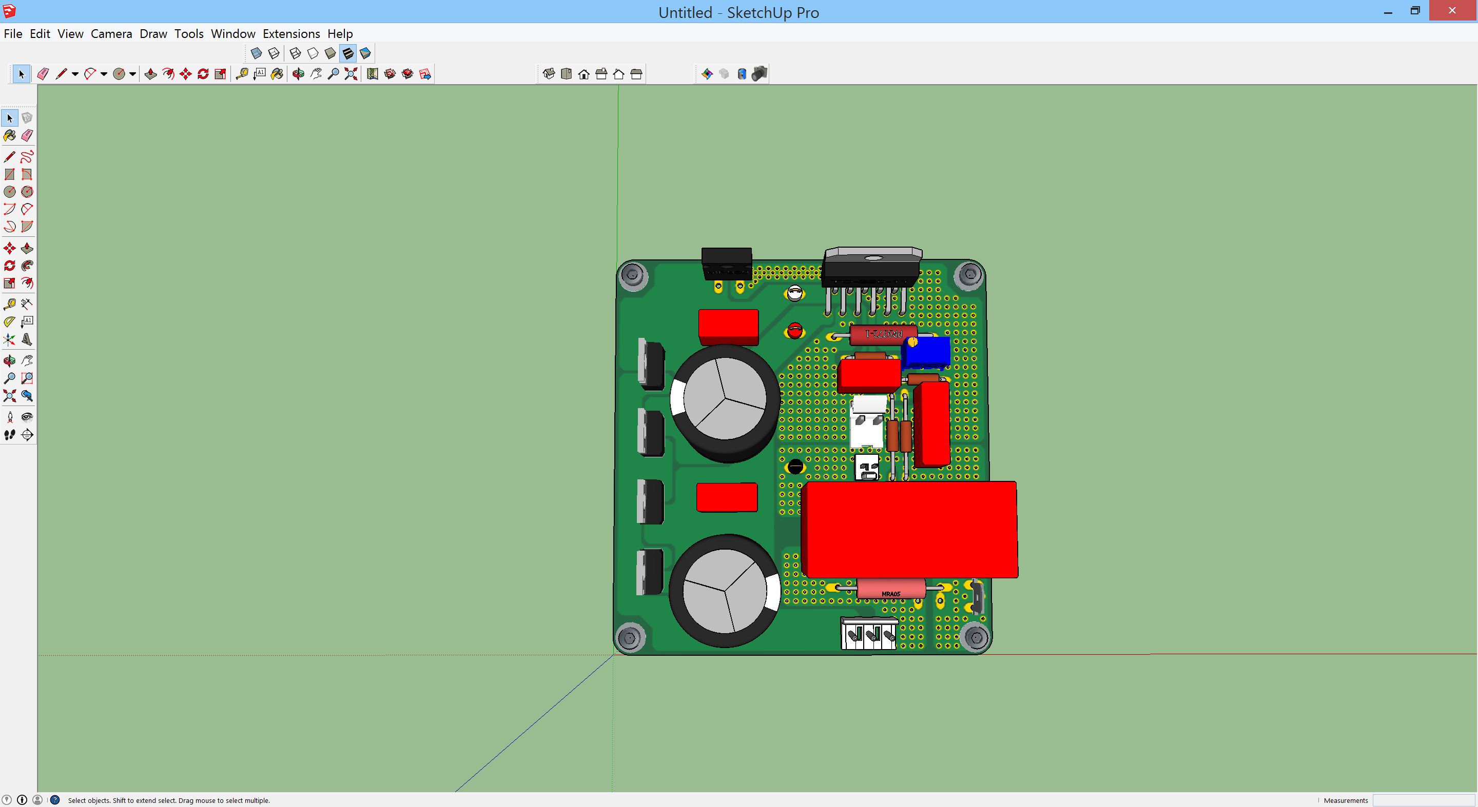

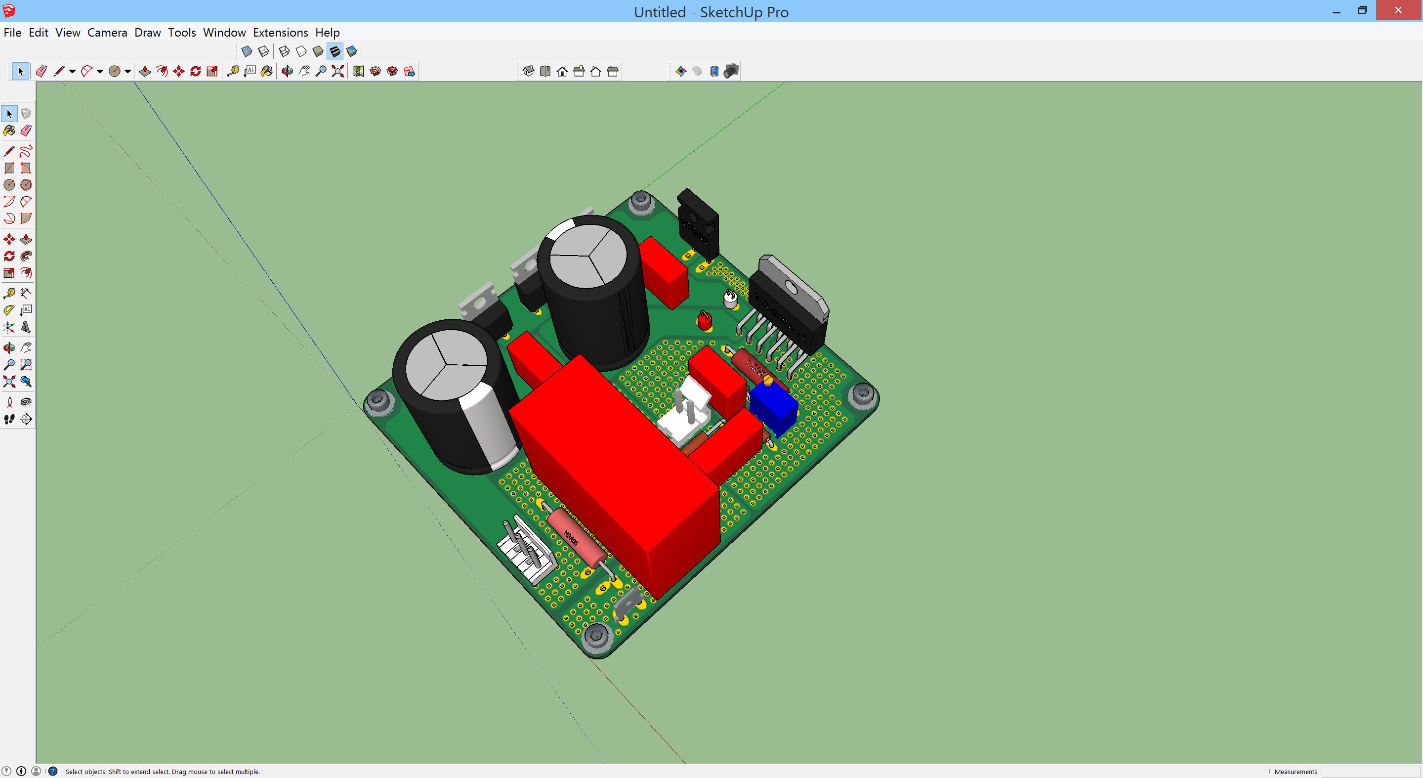

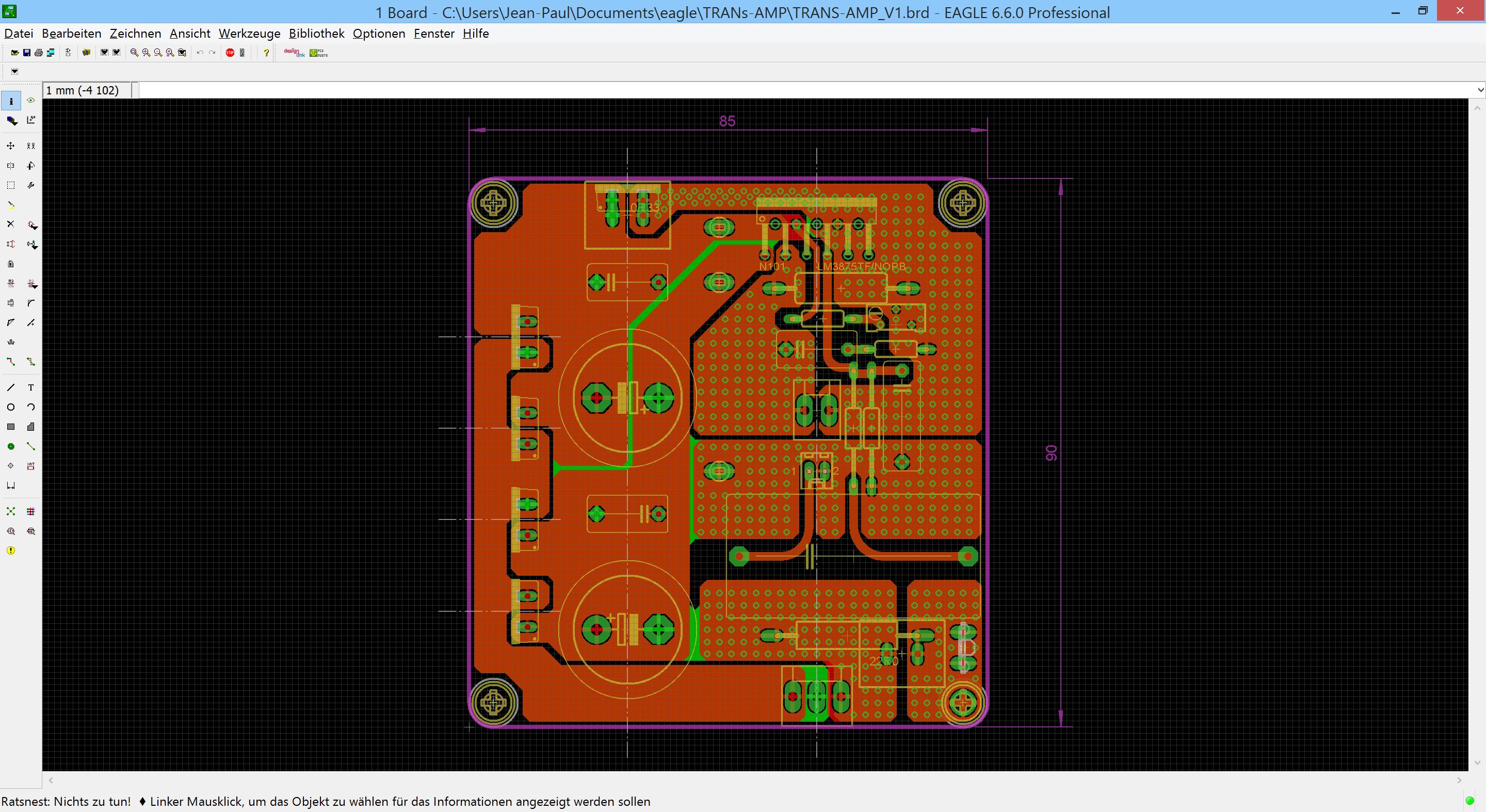

... here the printed board assembly, please check.
A version with MRA05 and MP930 and a version with SQM7 resistors...

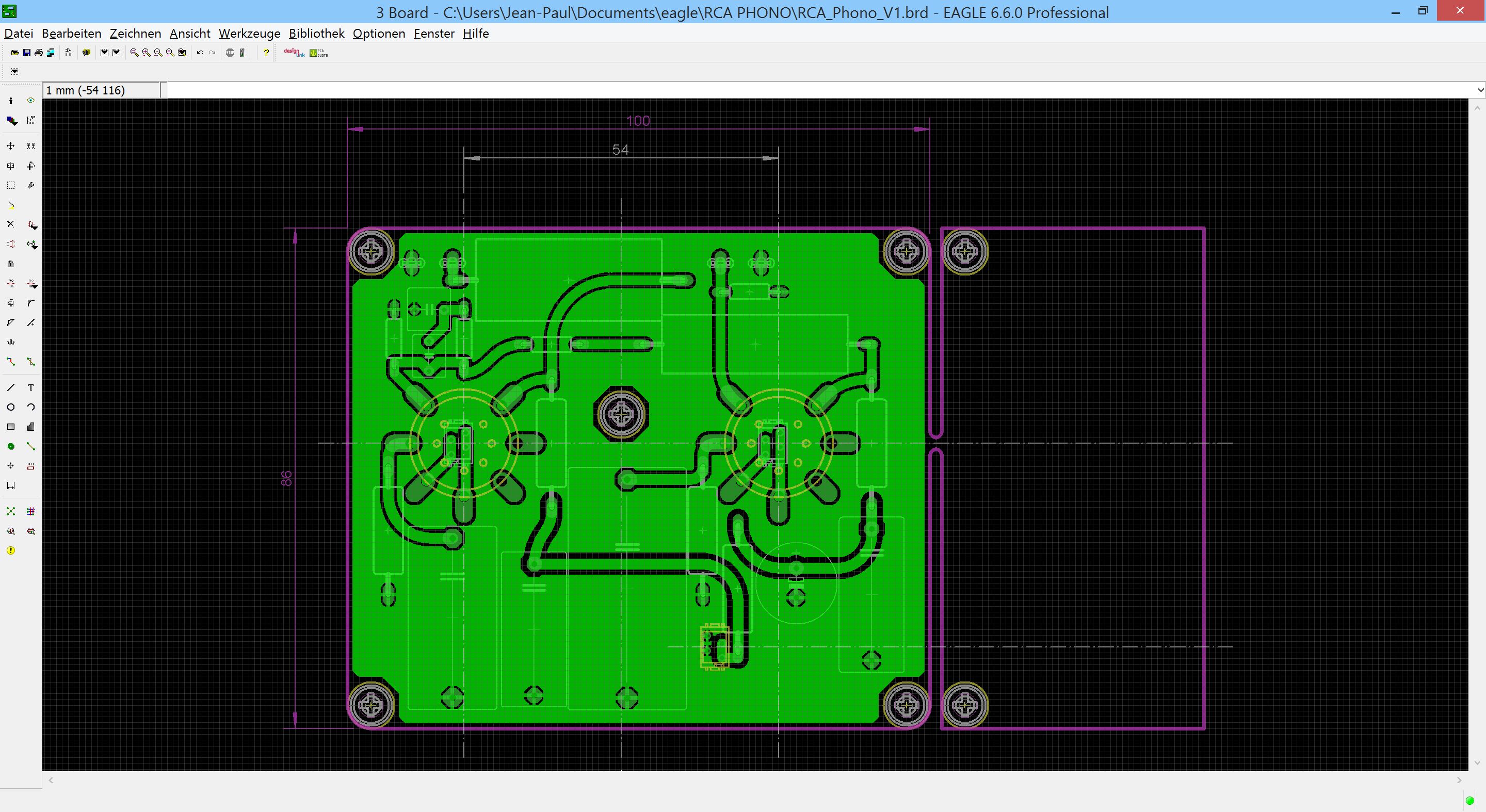

Impressive! Really a great job. But, please, can be single sided?
If not, please, post the drawing of the pcb.
Thanks again.
Thanks again.
Could you post this/these to Dirt Cheap Dirty Boards ? Given OK from any circuit tm, (r) or (c) issues?
I would be tempted to use smaller pitch 0.1uf caps and move them nearer the device...
and the 0.1 μF supply decoupling capacitors as close as possible to the
LM3875 to reduce the effects of PCB
Wouldn't it be better to move the parts that are intended to be mounted to a heatsink more to the board edge?
... please check.
Do you intend to build this amplifier?
I am very impressed from what I have seen.
may I suggest to put a 1MOhm resistor from output to ground, just to make sure that output cap is properly charged.... if you turn this one on as is, and plug your line stage, it might blow the input transistors.....

If you design more layouts, please, can be preferred single sided? So can be hand made in house, best for DIY, I think. The doble layer need to be order to a PCB company.
I have forget say this in my first post, and if you made other interesting layouts is more easy (and cheap) for all of us translate to the reality. All in all, this is a DIY Forum.
Thanks again for your (very) good work.
