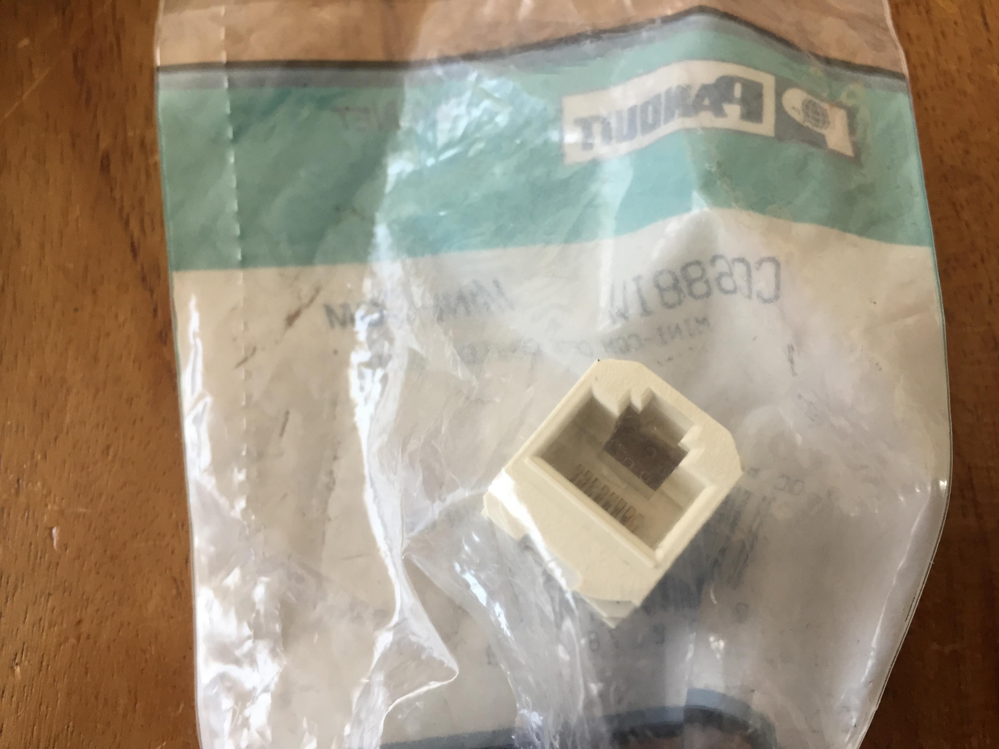

You spoke of using them in the middle of the cables which will always be the case with stuff that is designed to be inserted In such a case network techs always sigh and use "coupler" blocks. It means they made a mistake by using too short cables. They will need to crimp RJ45 connectors themselves which is (sorry) often worse than automated production cables. They won't be proud and their colleagues will not be happy. Best is to have one uninterrupted cable and then test and measure it. This is why the coupler blocks have a different name amongst them which is somewhat pejorative.
