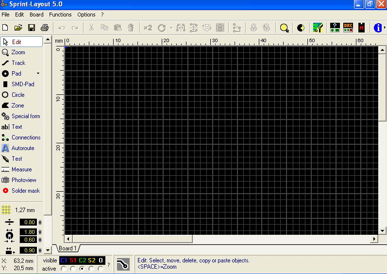

I am still leaning.... reading the manual and tutorial for the
Sprint... it seems very nice.
Will comment this tomorrow, as my daugther arrived home and i will be with here.
I like the interface...the image.... it seems easier and nice.
I will see if i will find problems tomorrow.

Sakis, check if price is low.... if low send me the CD please
This software from Abacom (finally) explain us how to use in a very decent and easy way.... they say side one is upper board.... no one other said that... they go and ask you to click Side one and Side two without explain you that stuff.
They explain us, step by step, each detail, very carefully... very good!
The other think that we will find things like a passing of magic or by osmosis.
Finally a software not made only to software designers to use..not to make to their own creative software designer's communitty.... made to normal user... normal human...to DIY people.
Also Grid system is clever.
The first thing to do is to inform the software the board dimensions...others are a hell to make that...have to click to drag and the board goes triangle!...ahahahahah!
Easy to use...you click into resistance and it goes to the working are...very easy.... wire routing simple...clever...good software...finally!
