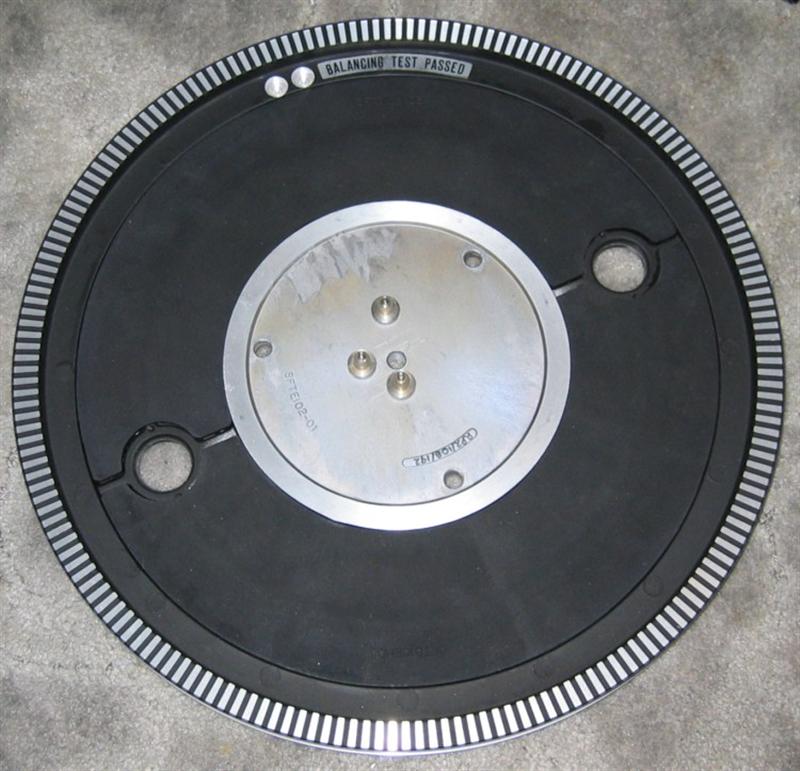

For Jlsem and others,
Everyone seems to be using the stock Sp-10 mark II platter, motor, bearing and aluminium diecast chassis.
Does anyone have any experience with doing Kaneta style mods but taken further?
Ie: cut out the strobe from the platter and making your own heavier, higher quality platter (wood, constrained layer or other) with ERS cloth and mu metal shielding in between to shield cartridge from magnets of the direct drive (and having it in the middle of the constrained layer so the mu metal is far enough away from the cartridge.
Taking out all of the electronic boards (only some of which are in the separate controller). Replacing the aluminium diecast chassis and placing the whole thing in maybe a CLD plinth like Corian and MDF (which null each other out ala Trio L-07) and lead shot or other.
It seems to me that the best part of the SP-10 is the motor and the speed controller/ electronics.
If the SP-10 Jlsem has made for Albert Porter sounds this good and this close to a Walker Prescinium table with these mods, then how good could the SP-10 sound if mods are taken much further?
Couldn't you also as an aside maybe have a ring magnet at the bottom of the new platter and whatever base it is being attached too ala some of the other flagship Japanese direct drives, decreasing pressure on the bearing?
Top it off with a Boston carbon mat and you could have a world beating turntable.

That would be the next step. We are adding the Mu Metal shield and a Funkfirm mat (unfortunately the Boston graphite mat didn't result in an upgrade). We're still looking for the funds for a new platter. The quote from the machinist for a maganese bronze platter was ~$900. Ouch.

To Jlsem - How did the sound of the sp-10 you made for Albert porter compare with the Walker? You mentioned low noise but what about dynamics, speed, bass, size of image etc?
It wasn't possible to make a true comparison of the sound between the two because the Walker had a Koetsu Jade cartridge and the SP-10 sported an Air Tight PC-1, which is a completely different sounding cartridge. But for the record, the SP-10/PC-1 combination had better dynamics, speed, bass and lower distortion. Later on we may try to get another Air Tight to try on the Walker but they are in short supply because they are selling like hotcakes (at $5500 a pop!!!).

The idea behind making the platter from a different material is that the stock platter has no intrinsic damping properties, i.e. it rings like a bell, and it depends on the stock rubber mat to damp any unwanted vibration. Making a platter from a piece of manganese bronze, which damps very well indeed, would give wider latitude for experimenting with different mats, even a copper mat. Replacing the stock rubber mat with the Boston graphite mat may have not worked because the Boston mat didn't have the ability to damp the aluminum platter. I may try a platter made from a ZA127 zinc alloy which self-damps fairly well and is more economical. Meanwhile, I'm in the process of making plinths for my Garrard 301, a friend of mine's 301, and another friend's Thorens TD-124. Thanks for the tip, EC8010!

It's all to do with the servo. The servo continuously compensates for speed variations and must be matched to the inertia of the platter, otherwise it will over/undercompensate.
Mine does not ring..?
Well, maybe "ring like a bell" was a bit of an exaggeration. But nevertheless, aluminum, even with the "rubber" coating doesn't come close to other materials in terms of damping unwanted vibration. Even if you can't hear it yourself, a sensitive moving-coil cartridge probably can.
As far as increasing the inertia of the platter is concerned, it isn't really necessary with the SP-10, since it makes up for a lack of mass with sophisticated electronics. And, as EC8010 points out, changing the rotational inertia of the platter will do more harm than good. What I was proposing was a platter of a high damping factor metal that would preserve the designed-in inertia of the original SP-10 platter/mat combination but would be usable with lighter weight mats such as the Boston graphite mat or the Funkfirm foamed vinyl mat.
None of this is to say that the original SP-10 is defective, but, like a lot of DIY audio efforts, these proposals are academic in nature.
