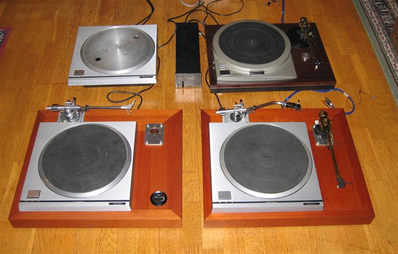

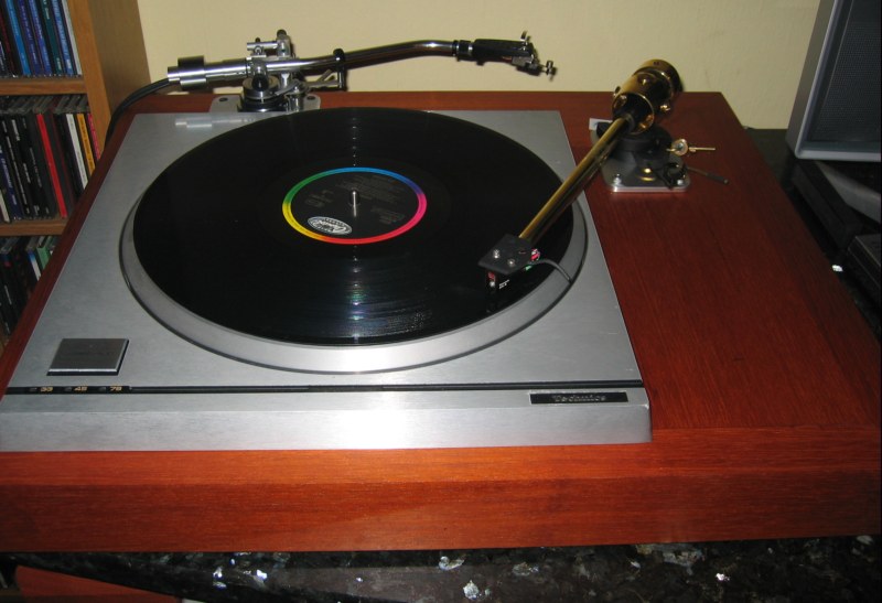

Layered plinth for SP-10
Thanks! The salient feature of that plinth is the grey cast iron block which is coupled by a brass rod to the bottom bearing of the motor and acts as vibration sink. The result was an amazingly quiet turntable - actually more quiet and with blacker backgrounds than the Walker Proscineum. Not at all what we expected.
John
Any electric motor produces some noise, and a direct drive turntable motor is coupled directly to the platter and is not isolated from the rest of the 'table. The moving coil cartridges used have outputs on the order of 200-600 microvolts, so noise is obviously an issue. The grey cast iron block has a very high specific damping factor (highest among commonly available materials) and the brass rod makes a convenient transfer path for noise and vibration to the iron block, where they magically disappear. This base is admittingly a brute-force solution to the problem, but it worked very well.
John

Exactly how did you couple the brass rod to the motor/spindle?
The rubber seal described by EC8010 was carefully cut away from the bottom bearing and the threaded brass rod seen in the pictures was run up through the iron block until it touched the bearing with firm pressure and then locked into place with an eccentric cam. The brass rod where it contacts the bearing is polished with a large radius.
What noise? What problem? "What HiFi"
Unless "What HiFi" measured zero rumble and noise from the SP-10 I'm inclined to believe this plinth represents an improvement. Remember that we were comparing it very favorably to the Walker Proscineum which is a highly regarded TT at this time.
As a side note, installing this set-up on an isolation platform killed every gain made by the plinth alone.
John
P.S. There appears to be some skepticism among Norwegians.:)
