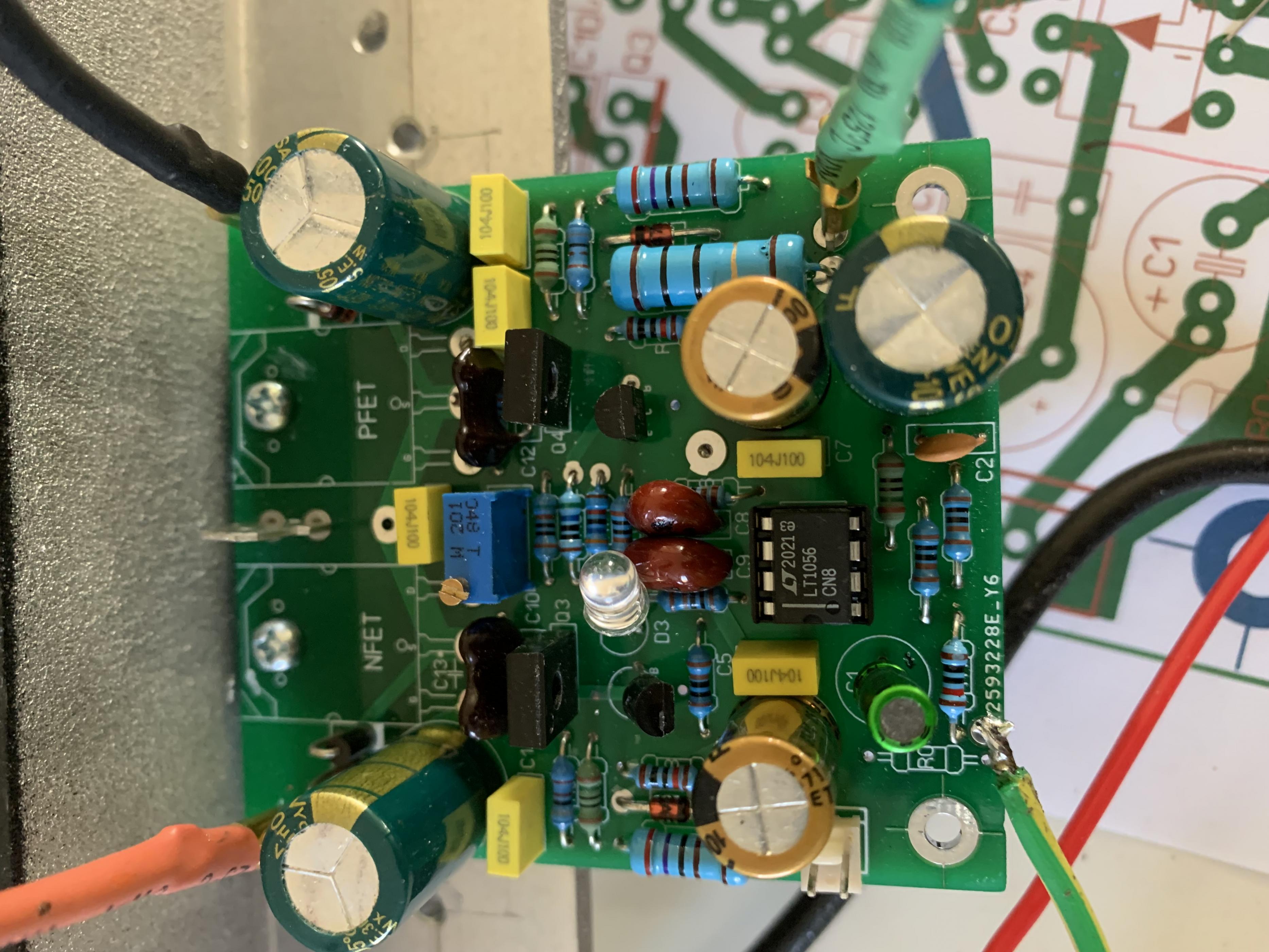

I have finally assembled two of these amps and have taken some voltage measurements on one, with no load and no input. The output inductor was not connected.
The output offset voltage was 0.1mV which I have repeatedly tested and find hard to believe! The transistors are all matched for hfe and the critical caps are all silver mica and resistors are all 1% metal film. The MOSFETS are Exicon single die devices and according to the spec sheets have the same input capacitance so i have not tried to better match them. The 220pF cap across the zener-diode network on the N-channel device was also not used.
I am interested in your comments and recommendations, especially around the bias setting. The driver BJTs get quite warm as expected at these high currents and i will refit the heatsink that I temporarily removed.
Otherwise it sounds Ok when connected to my "ESP P88", DC spkr protection and output inductor and B&W test spkr.

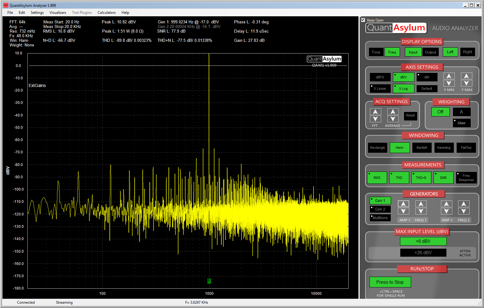

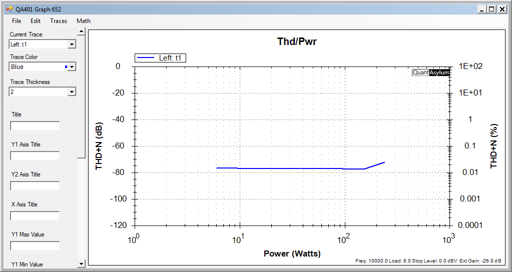

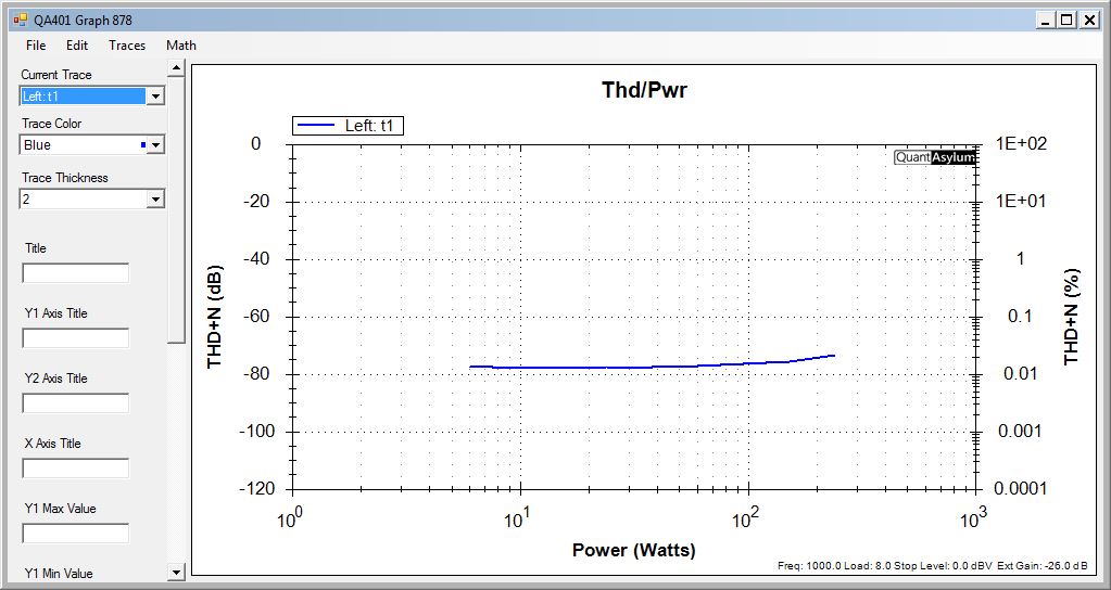

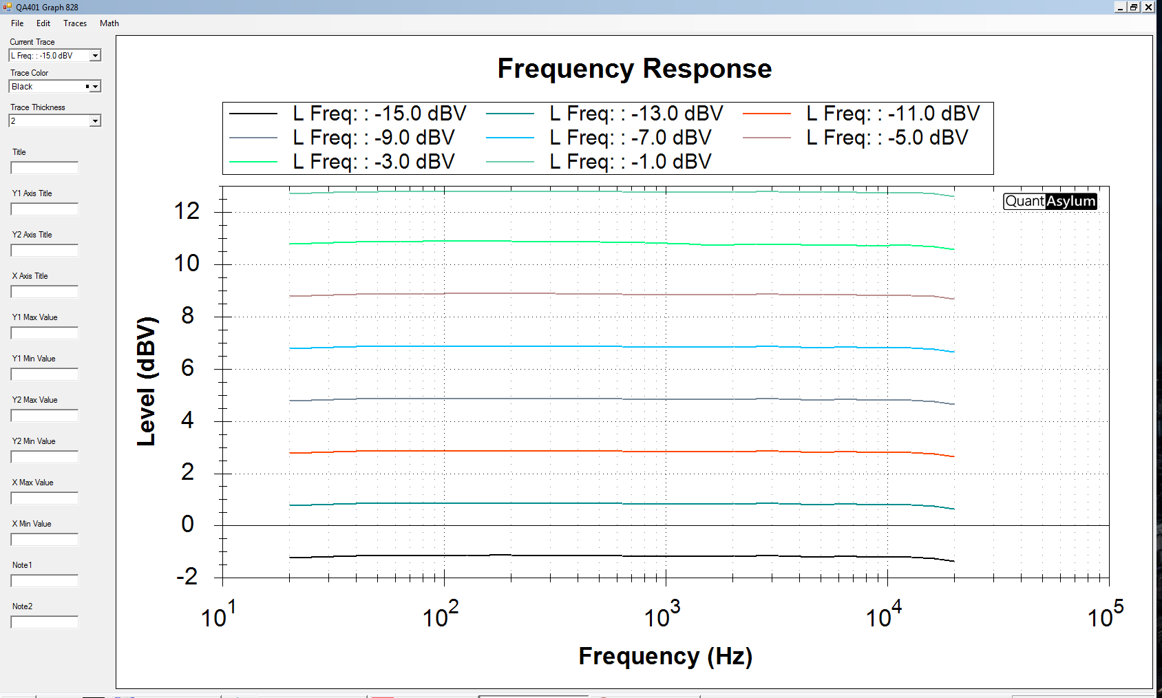

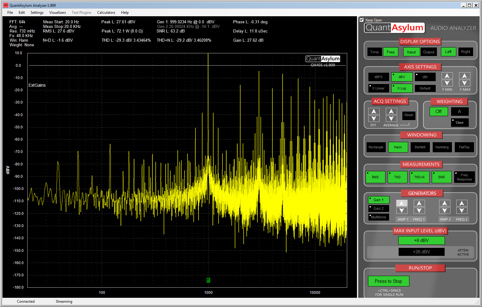

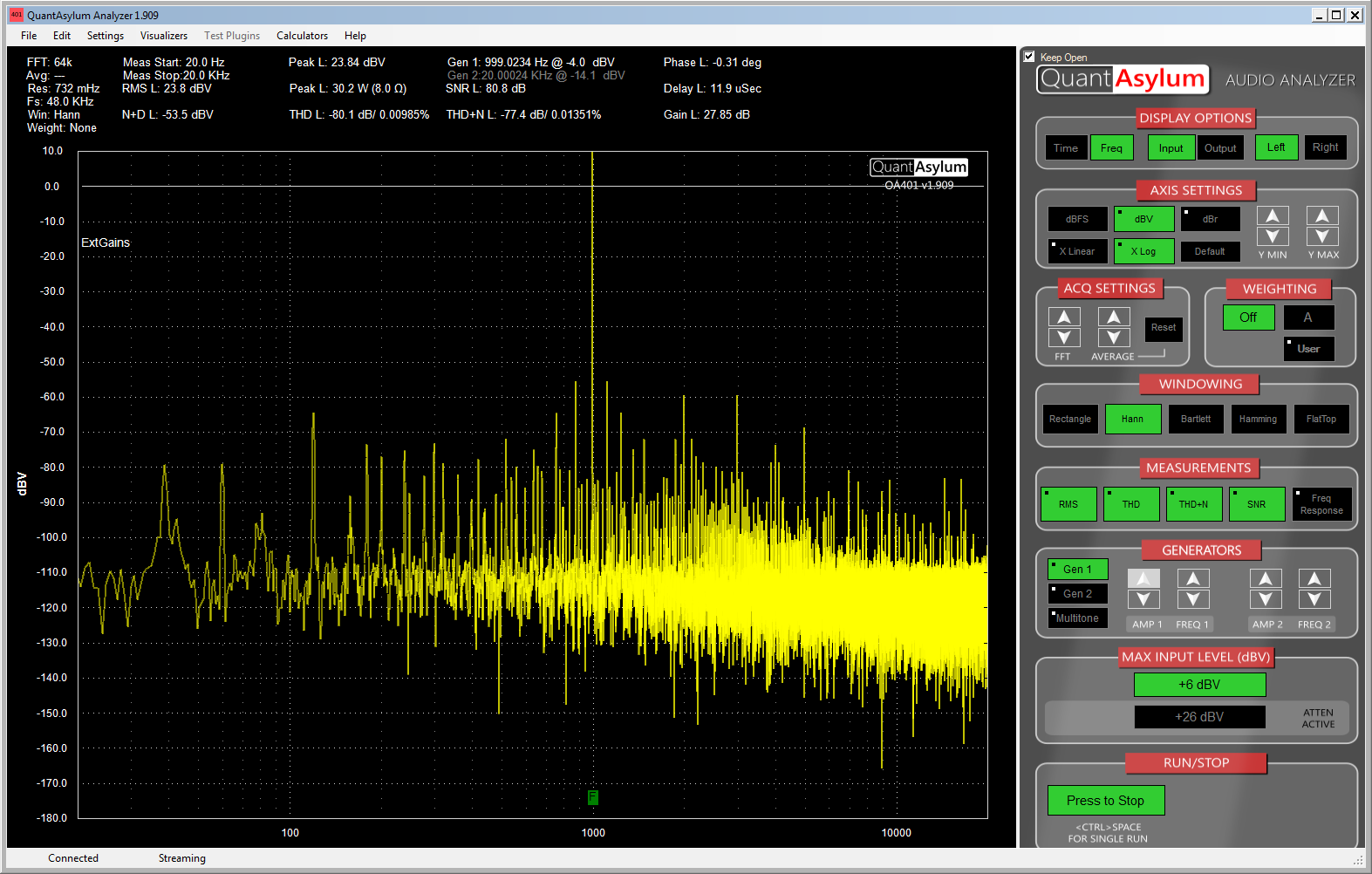

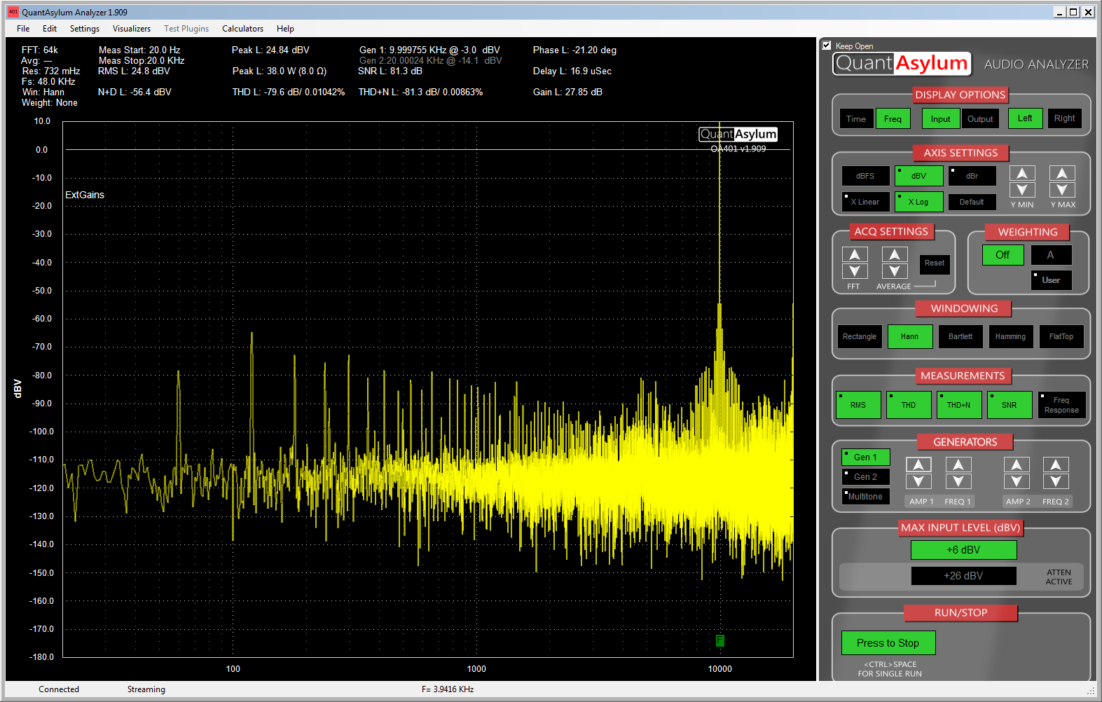

I tried to measure my amp (dual-die fets) with QA401 - again.
This time I have slightly different setup, including new resistor load with different signal pickup for QA401 analyzer.
Screenshots attached.
Thd at higher power level is increasing - it starts clipping too soon.
This was tested with PSU +/- 42V DC (instead of 50V).

42V for double die devices (or two pairs of singles) seems too low and I am not too surprised to see clipping when pushed hard. I would have expected that for 100 - 120W RMS, you would need 56V rails with laterals to be perfectly comfortable and of course, your PSU has to have the grunt to not dip too much (lots of uF and VA).
For my single dies i am aiming for around 50W and using 42.6v rails with a 500VA toroidal transformer that I happen to have available...Not likely to get any PSU droop, esp with 48000uF.

Must admit i would have expected this amp to measure better given how well it simulates. There does seem to be PS / PSRR issues even @ 1.5w. Does the QA401 allow you to average out some of the "grass"?
That does seem high. looks like the averaging function is under ACQ. Dial it up to 10 or so. Having said that it does look like there is grounding issue of some sort. The averaging will just make it clearer.
Grounding?
It looks the same with qa401 not even connected to the amp..
I tried this with my desktop pc, and with battery powered laptop. Same results.
Looks to me like it has 60 and 120 hz spikes and harmonics from there. What if you short the input?

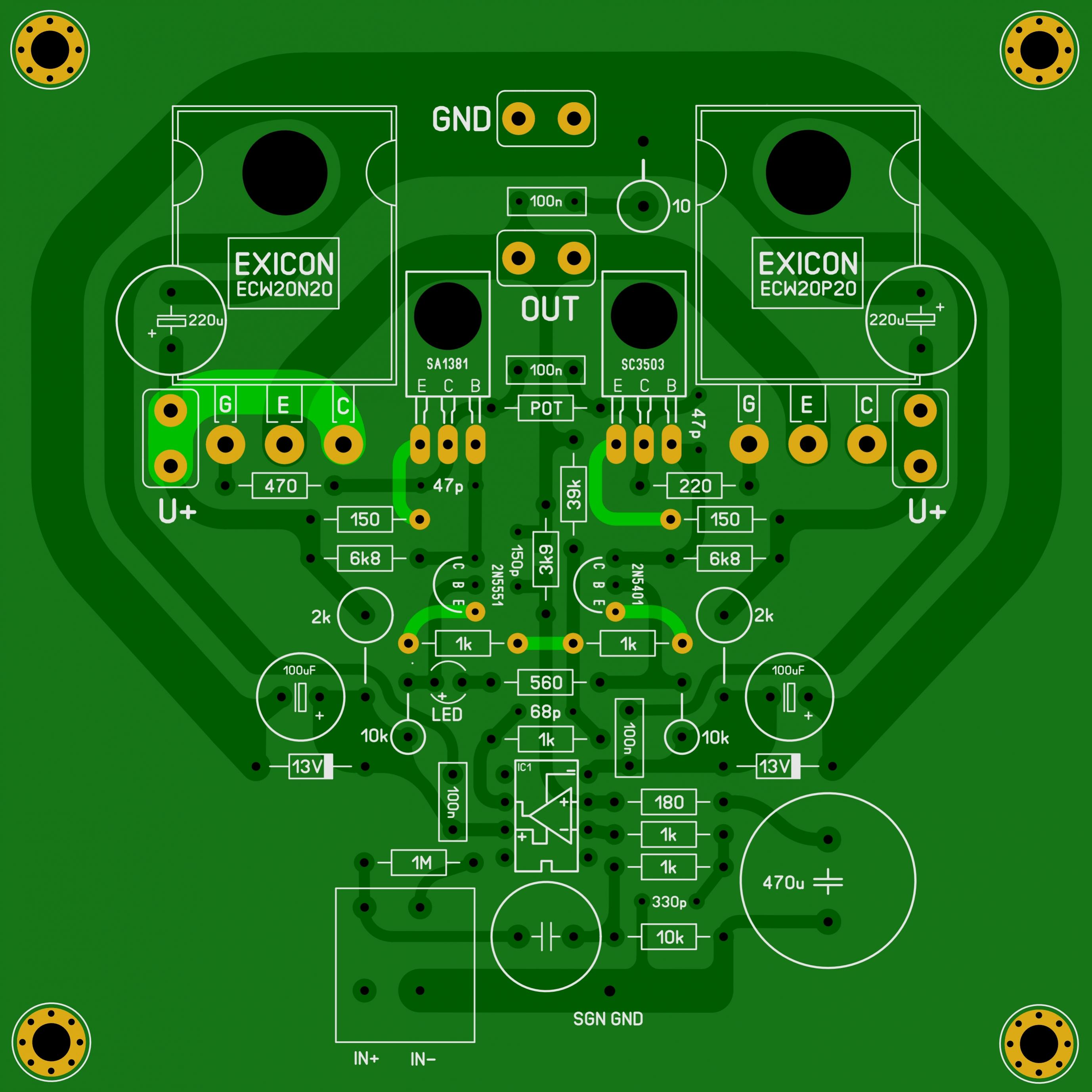

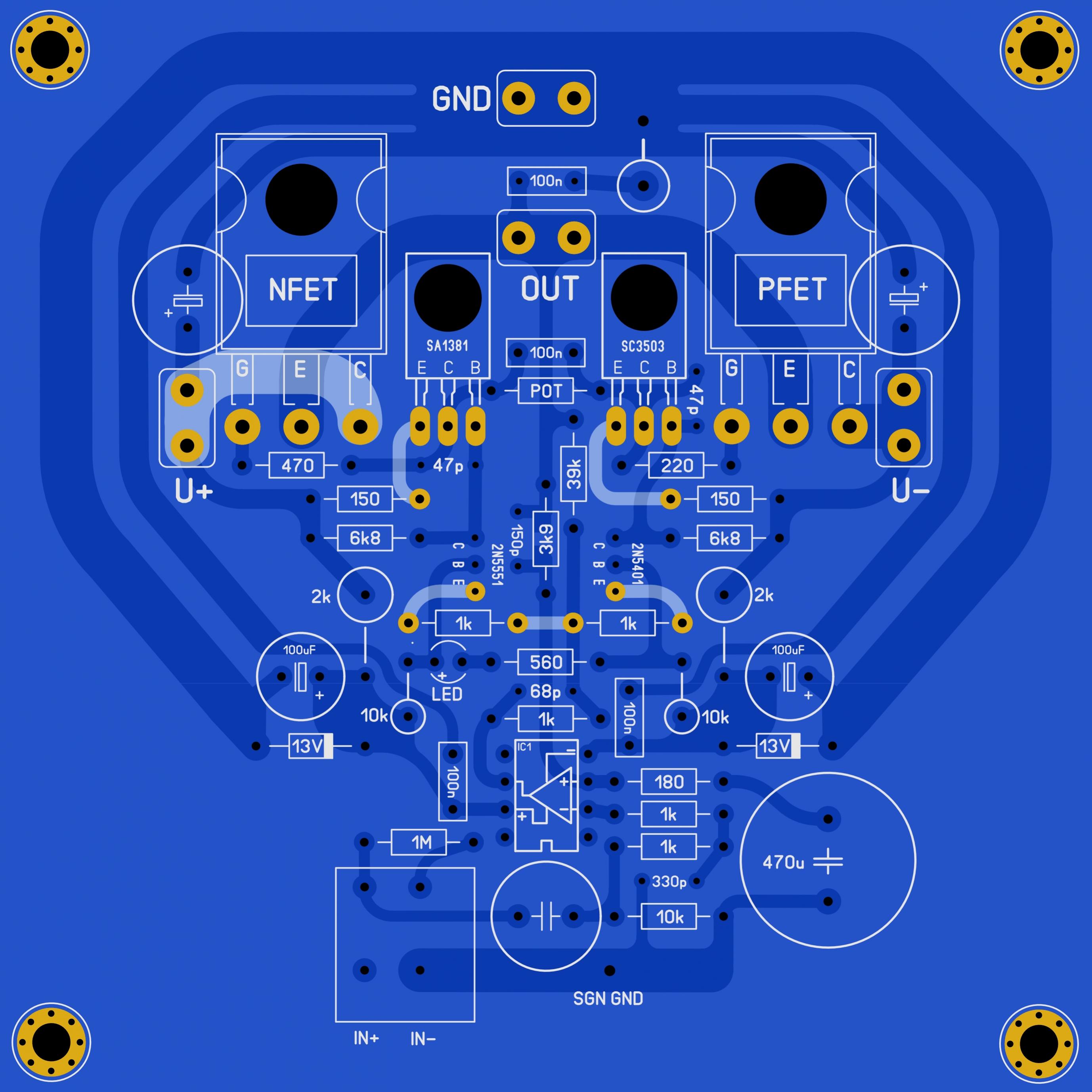

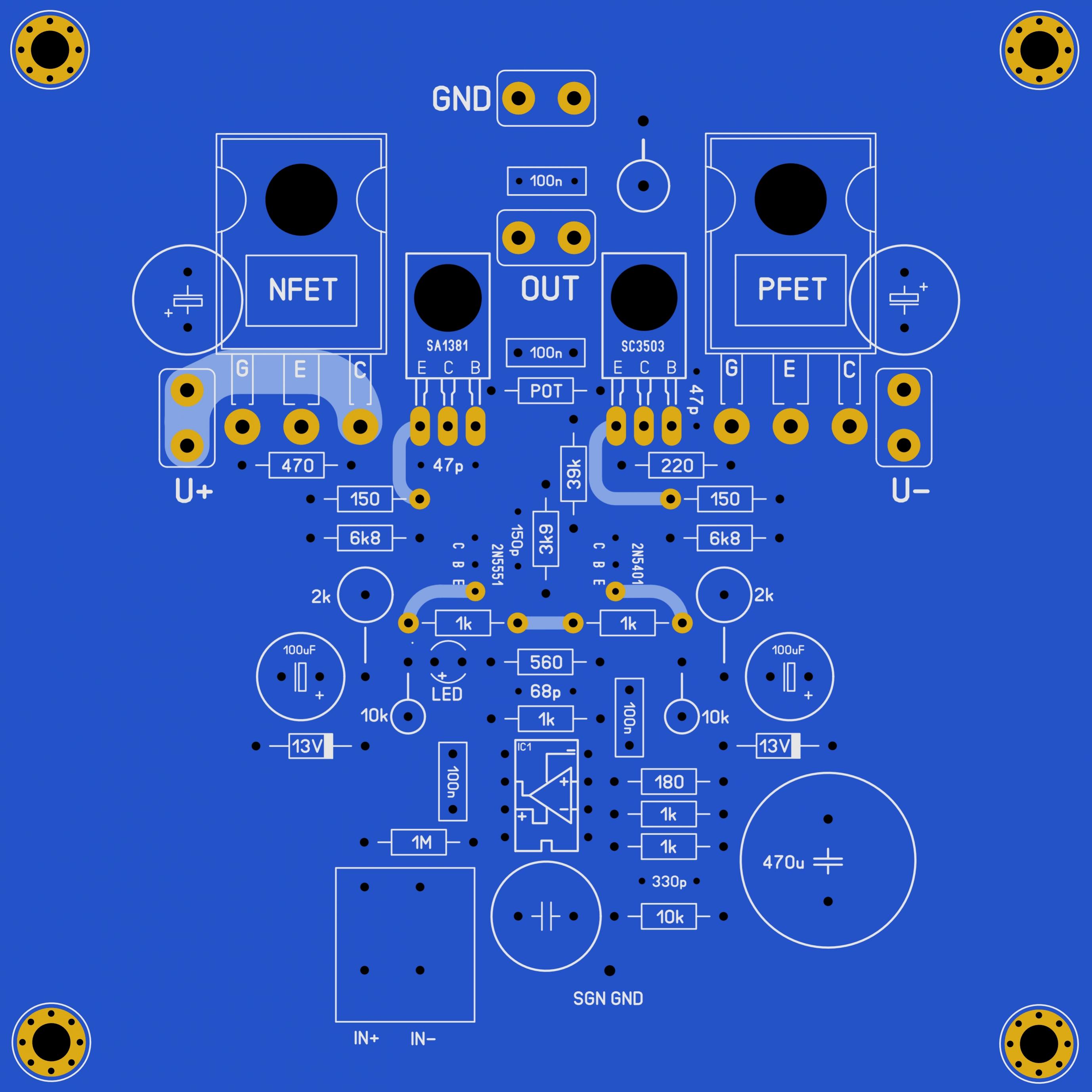

Work in progress. Finally I ordered Exicon ECW20N20/P20 Lateral MOSFETS from Profusion. Minek’s works are really inspiring, so I decided I’ll build the amp on a copper plate with a passive PC cooler. The PCB looks a little funny, reminiscent of a crystal skull 😀, but I hope it will work well.
In the meantime I measured EXICON Fets, they are much bigger than as shown on the original PCB drawing, so I modified my layout. Someone suggested placing 100nF capacitors as close to the opamp supply rails as possible, and using separate ground tracks to the star point. This allows us trying much faster opamps without risk of oscillatiion.
The ECW double-die devices are TO264, not TO247, so are 20mm wide, not 16mm wide.
Since I am not a native English speaker, would you please explain what is meant by "double-die"? I know what "double" and "die" are, but so together .... 🙂 Thank you.
and you can make the gerber
and version with 4x mosfet
You mean 4x LATFET?
PS: Profusion confirmed ECW20N20/P20 have built in gate protection diodes

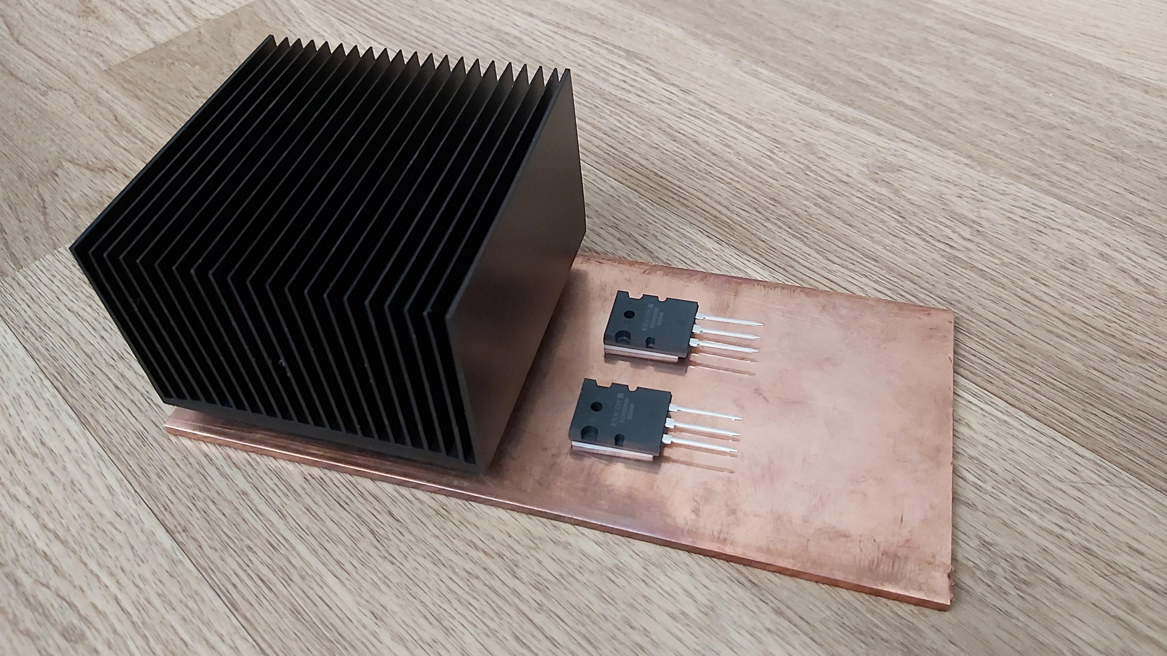

Please note, that S (source/emitter) pins of the fets are connected to the metal pad (different than hexfets (they use collectors)).
Both Fets DO NOT need insulators between them and Hetasink, as long as you keep both channels isolated.
In my build all fets (4 of them) were mounted to the common chassis, so I had to use insulators,
but in the Wiederhold amp, with single-die latfets, I used 2 copper plates, with passive heatsinks, and no insulators used.
Copper plates were mounted on common WOODEN slab.
