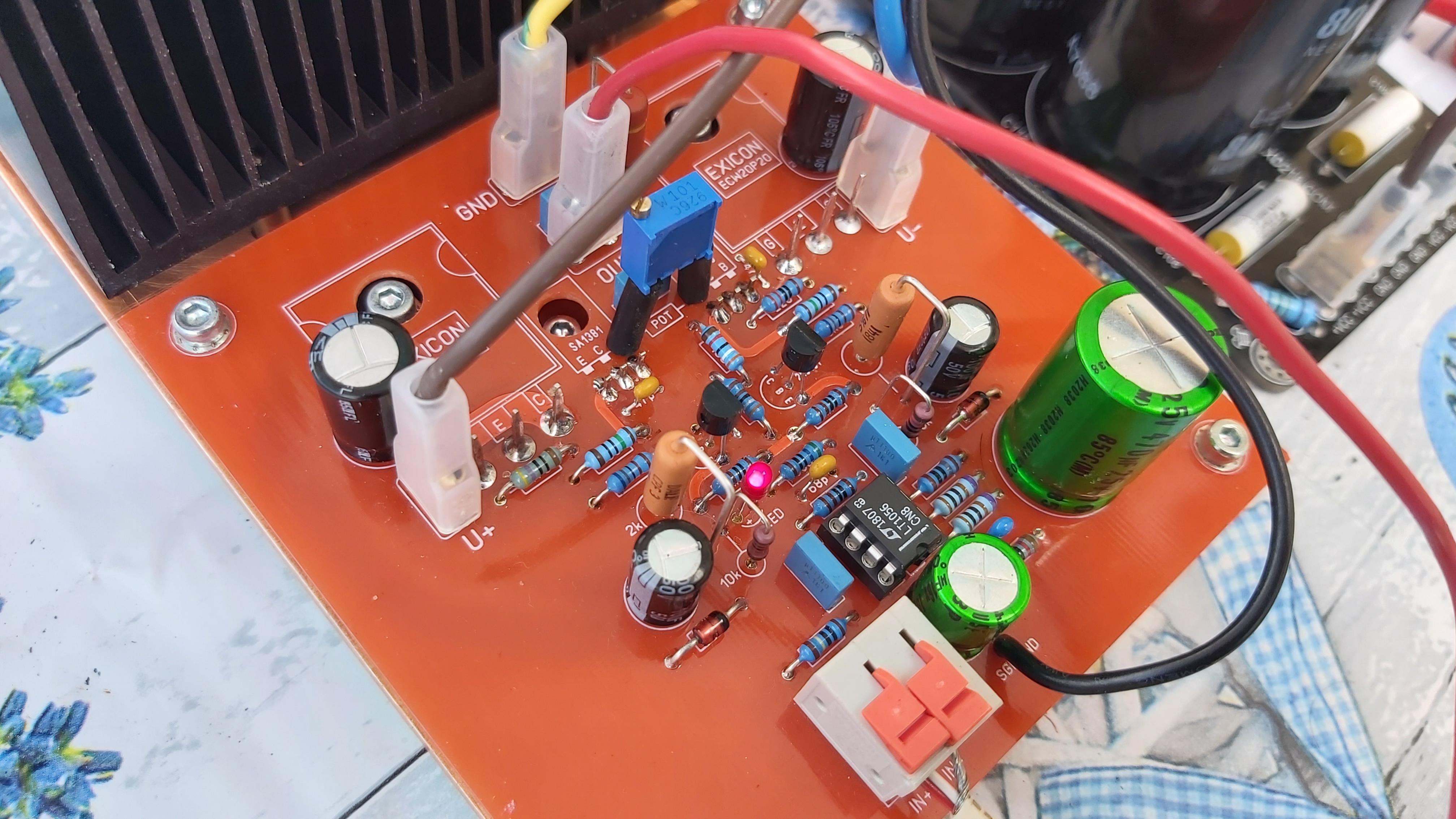

Power supply: 36V -> 300VA toroid, 4x10kuF United Chemicon + 2x10kuF Kemet Slit Foil elkos. Output coil still not installed. Resistors are Yageo 1% 50ppm, Takman Rey and Dale. Elkos are low ESR Panasonic FR and Nichicon Muse BP.
As you recommended I set the quiescent current of the amplifier to 105mA with a 100 ohm trimmer. The trimmer shows 67 ohms. The output offset was 0mV at start-up, I measured it again after an hour of intensive use, the value is 0mV. Maybe the DMM failed? I replaced the battery in it and remeasured again: 0mV. Incredible. The output offset is 0mV in all conditions, ie beyond the measuring limit. I have only selected 2N transistors (Central Semiconductor), they matched to equal hfe: 213. Drivers and fets are not matched. The 150 Ohms, 2K ohms, and heat sinks are moderately warm, as expected, with no special warming issue. The amp is rock stable like the Viktor Orbán's forehead.😀
I experienced only one strange thing. I measure -12.8V on the negative side of the opamp's rail and 13V on the positive side. Why this asymmetry? This is normal? Or could it be the fault of the opamp?
The simplest explanation would be the zeners and/or their resistors.
Check voltage on zener resistors. Is the current equal?

On the lower 2k resistor I measure 22V, on the upper one 21,8V. So on the negative side there is higher current for some reason. I forgot to mention something. 2kOhms are Dale 3W 5% metal film resistors. Maybe the difference of resistors gives this asimmetry?
Lots of people claim this. So I guess there must be something there..
Maybe because of very high bandwidth and slew rate and lack of high frequency cross conduction.
I wouldn't worry about this.. The rail voltage could be slightly uneven, resistor tolerances, Zenere diodes tolerances...

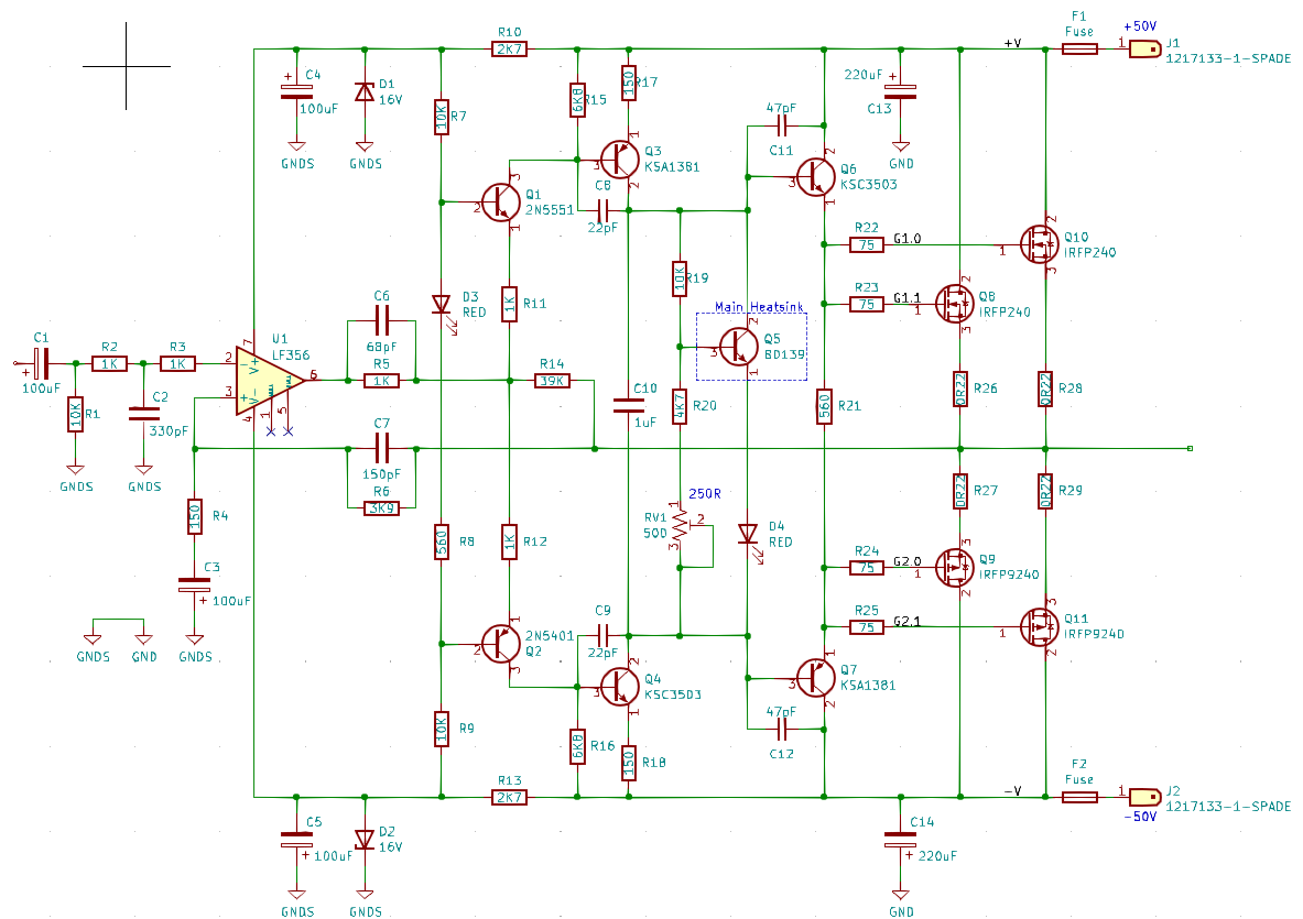

Hi Astaro,
if you resign from 2 pairs and use 1, and delete source resistor you will probably get better sound.
Using no Rs with 2 pairs is risky.

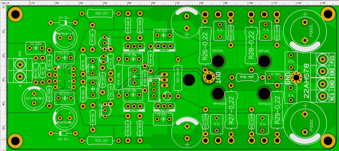

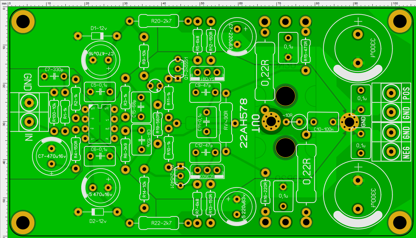

My amplifier boards. Maybe someone will like it....
You need to add sufficient space to attach heatsinks or at least small pieces of aluminium to the driver transistors. On the single pair output board these will get warm and i expect that will also be the case for the dual pair output board.
Otherwise the boards look Ok, despite the components being rather spaciously arranged.
The use of a ground plane is interesting and there are some who would not use that.
