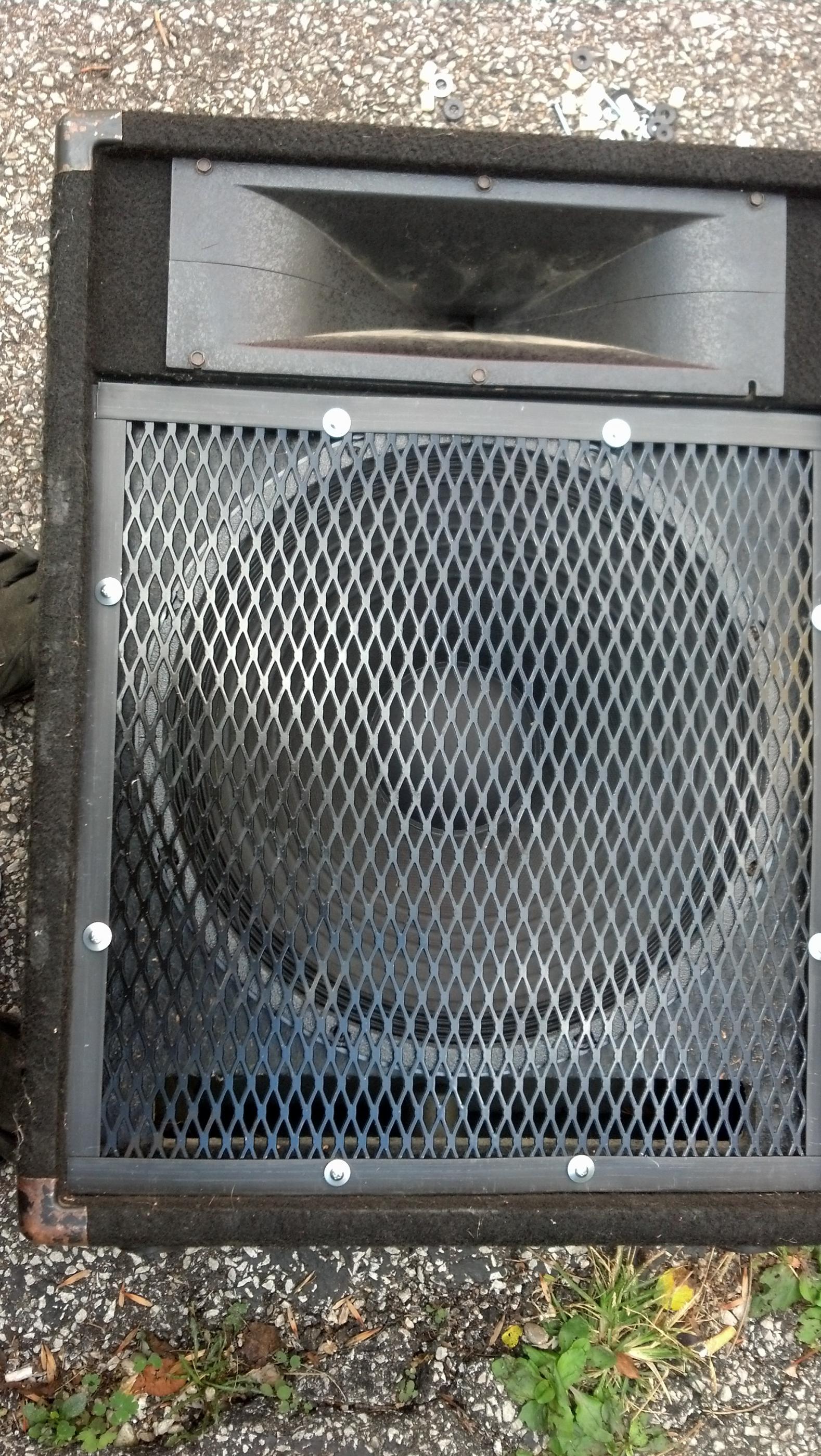

Just curious if you have a picture of the extruded metal you mentioned for your grilles?
I am thinking of making a grille for my subs and wanted to know what others used. My area that would be needed to cover is rather large so I though of going with a thicker material to keep the grille from flapping back and forth. PLUS with the grille area having to be at least 64% or higher flow rate I wondered what you might be using. Just curious.

chrapladm: Attached is a pix of the expanded steel grill I made to replace the missing PV grill for a DJ customer, it is the same stuff I use for most of my projects. A local metal supply shop has it in 4x8 sheets for around $70. I use plastic trim for wallboard to cover the sharp bits & give it a nice clean look with no effort. For some projects I'll also spray the back with R77 & stick acoustic cloth to it before the plastic trim goes on.
