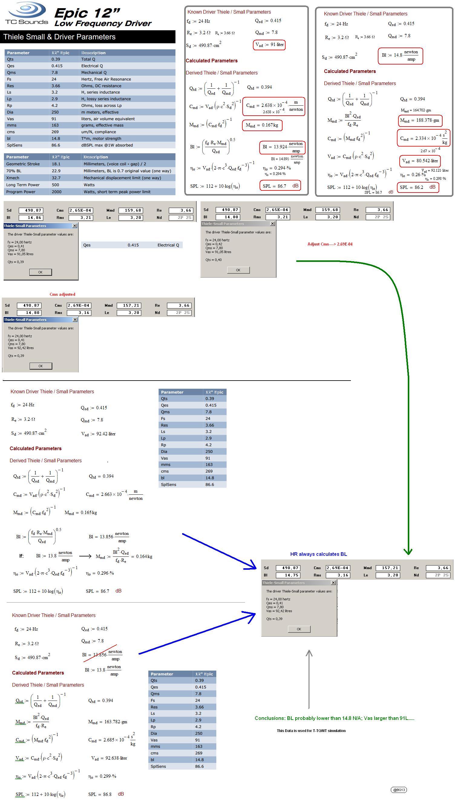

When measured in the reality: A typical TL do not have a negative onset IR slope. HR turns it upside down thus do not depict the 'IR' reality for 99...% of a TL build when in TH screen mode or in OD mode or in 'Nd' too.
The important part here is that TH, Nd and Od are all the same, none of them need polarity reversed (wrt the others) to have the same behavior.
As quoted from post 77:
For the purposes of calculating impulse response, Hornresp assumes the convention that the side of the driver diaphragm facing the horn throat moves towards the throat ...
Like I said, the driver is always facing the same way. I've never checked to see if polarity changes when you use the Vrc and Lrc instead of S1 - S5 and at this point I don't really care, nor do I care about how someone is likely to set up polarity and measure a positive or negative initial spike.
All I care about is that TH, Nd and Od are all the same, the driver is always facing the same way.

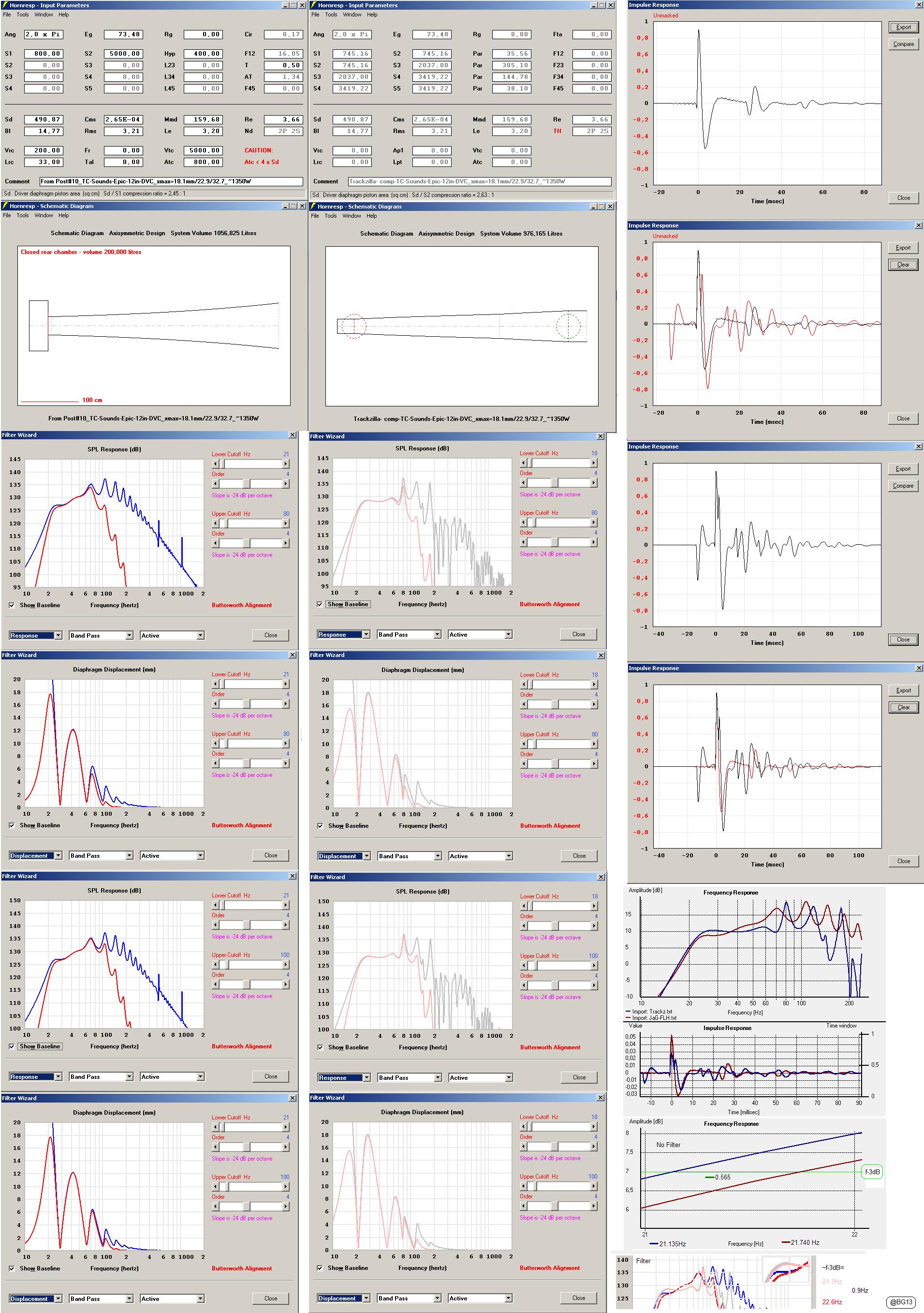

Hi just a guy,
For the purposes of calculating impulse response, Hornresp assumes the convention that the side of the driver diaphragm facing the horn throat moves towards the throat, thus increasing the instantaneous pressure on the throat side. This is why the initial spike is negative for both tapped horns and the combined response of an offset driver horn.
Right, the impulse is initially negative for both TH and TL. My point was that since the driver is nowhere near the mouth in a tl and it ALSO has a negative spike to start, the assumption that there is an initial negative pressure at the TH mouth is flawed.
I'm not saying there won't be a LITTLE BIT of negative pressure but if we look back at the original question:
Cone moves away from magnet (which is next to the mouth, usually), and you get positive pressure at the mouth.
Is this what you're telling us?
Time to rethink how I thought tapped horns work, I suspect.
Apparently Chris thought that tapped horns have reverse polarity compared to an untapped equivalent transmission line. As far as I can tell he still hasn't changed his mind on that, so when you said "Hi Chris - You are quite correct." in post 68, this idea what I was objecting to, not the fact that there might be a tiny bit of negative pressure initially due to cone motion direction.
Rest assured, the initial negative spike shown in my tapped horn impulse response example is definitely being generated by the side of the driver diaphragm facing the horn mouth 🙂.

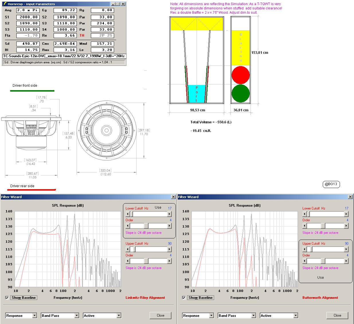

Some forgotten simulations that is a continuation of post #36( My view of comparing the TH and the FLH when preserving BW over SPL) and a new suggestion of an T-TQWT.
b🙂
b🙂

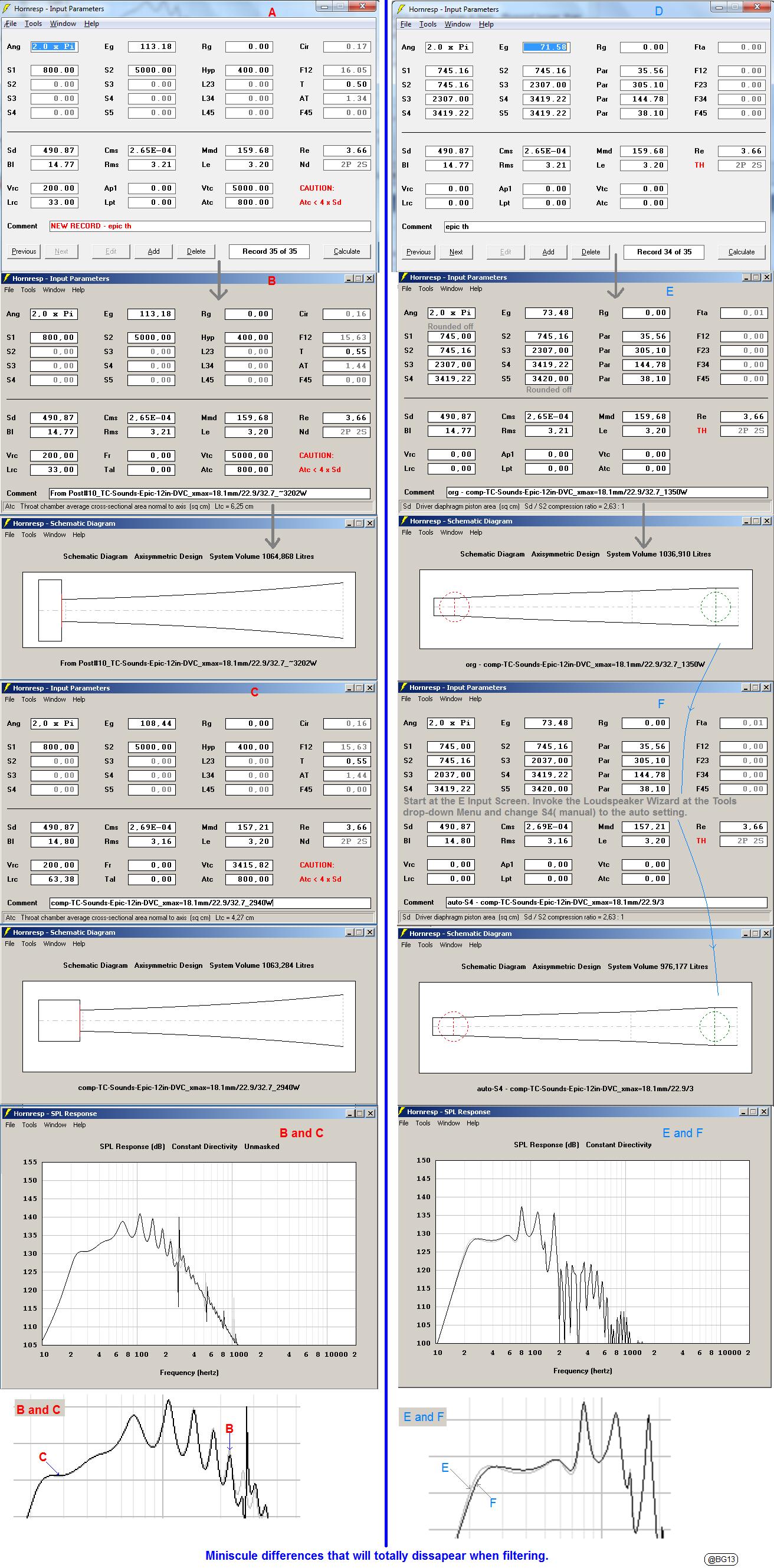

Thanks for explaining post 36, now I have a better idea of what you did there, previously it didn't make any sense to me at all.
Now that I can see what you did, I can see that you castrated my design with inappropriate filters. Both the low and highpass filters were set too low in frequency.
Here's a pic showing our different approaches to filtering this flh. The two pics in the top row show your approach and the two pics in the bottom row show my approach (and I only spent a couple of minutes on this so it could probably be improved a bit). Both shown at xmax. Your approach can only handle 1475 watts while mine can take 3500, the only difference for this discrepancy due to the high pass filter.
My approach gives ~3db more across most of the bandwidth (but only about 2 db more at the very low end) AND more bandwidth on the top end.
As previously mentioned, 3500 watts (across 4 drivers) is more than they are rated for but as I explained previously I don't think that's a problem at all. Excerpt from post 13:
The part in bold should read "more than 100 percent". And if 2 of the drivers were flipped (2 motors in the chamber, 2 motors in the throat), it would be almost 5x larger than the Lab chamber (per chambered motor).
And finally, here's post 15 again, which speaks to the thermal capability of the TC Sounds drivers as measured by data-bass.com:
None of this matters much since the OP doesn't have 3500 watts and doesn't want to upgrade but I do feel that you dramatically misrepresented the capability of my design with odd filter choices.
To address the power concerns head on, I've never burned a sub. Ever. Even when I try to reach pmax and xmax at the same time in my sims it ALWAYS sounds bad long before it burns. Even when I exceed pmax before hitting xmax in my sims it ALWAYS sounds bad before I have thermal issues. In other words, I've always had excursion issues and never thermal problems. Now if you have a clueless dj that keeps turning it up well past the point that it starts to sound bad that's another story completely...
My sim is shown at 3500 watts rms per cab (875 watts per driver). The drivers are rated at 500 rms (2000 peak) and I think they could handle the power I've shown them at with minimal thermal compression. As you pointed out awhile back, assuming fairly dynamic music the drivers only get a fraction of the amp's full output capability most of the time.
Chamber size in this design is 200 liters. This is almost 5x larger than the Labhorn rear chamber. This design has twice as many drivers though, so cut this larger design in half and then driver for driver it's almost 2.5x larger than the Labhorn rear chamber. To be painfully clear, the Lab has about 21 liters per driver and this design has 50 liters per driver. Also, this design is tuned almost an octave lower than the Lab, which means much more cone movement, which equates to a lot more fan action cooling the coils.
The Labhorn is obviously not the best example of a thermally controlled environment but compared to this design they are not even close. You have almost 50 percent more chamber PER DRIVER in this design compared to the Lab and a lot more cone movement to help cool the drivers. So I don't think calling the chamber "tiny" and "an oven" is really fair. Besides, the chamber could be increased by 25 liters without causing any problems but I didn't do that because I was trying to keep it the same size as the tapped horn sim presented in post #1. Also, the design could be tuned even lower than shown, requiring a much larger chamber if that was desired.

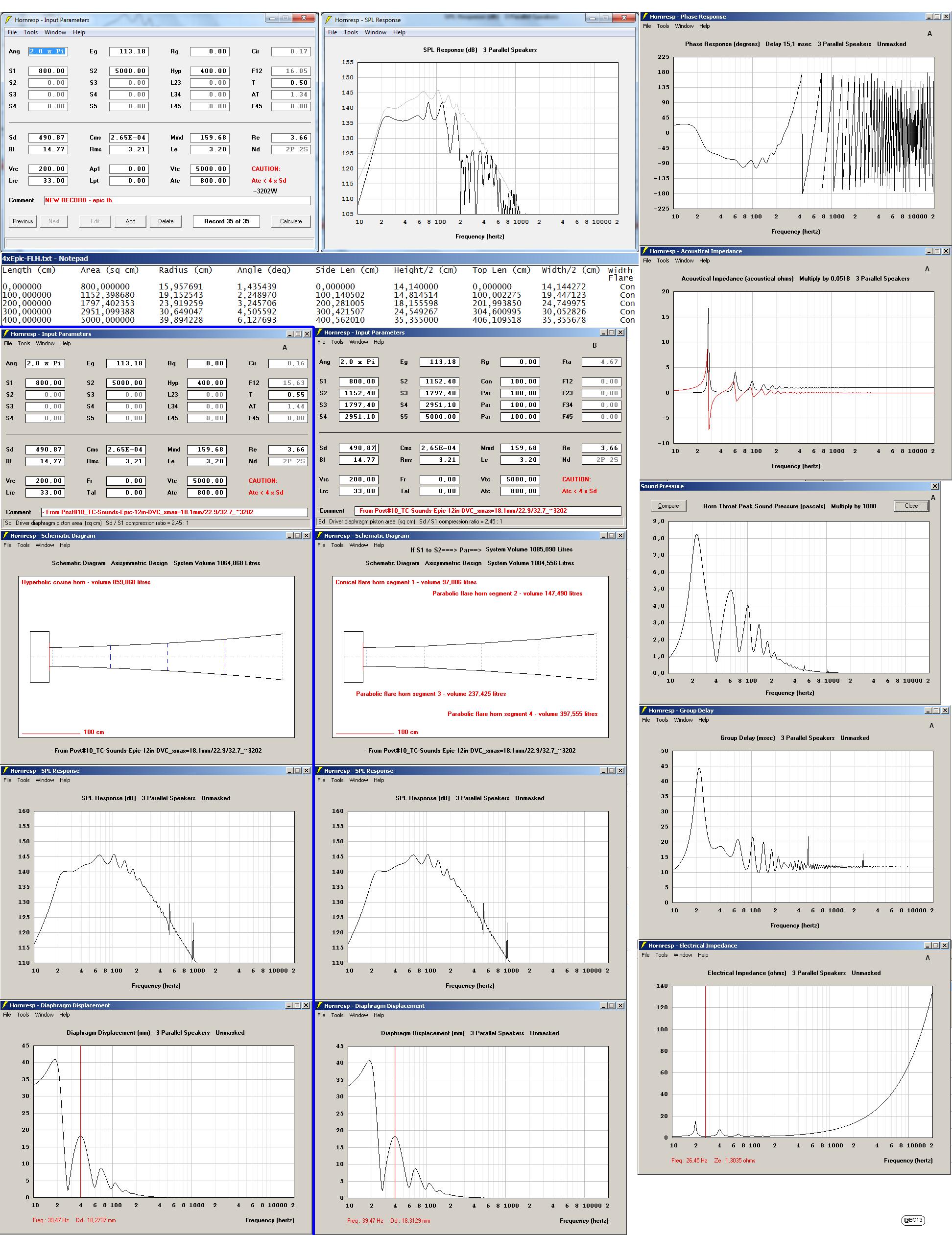

The sim above assume 1 cab and as expected it looks even better with 3 cabs and allows different filters and smoother response. Better low end, smoother response and more usable bandwidth on the top end. Could still raise the low pass filter even higher if desired for more high end bandwidth. 3 cabs shown below, 3500 watts each.
The check came through from my customer, I'm sitting on 10 of the 12 TC Epic 12s (the last 2 are back ordered to beginning of october dammit) and a stack of 3/4" MDF and 3/4" baltic birch.
I settled on the 3 segment tapped horn approach to design and modeling, as per TB46 suggestion, with some final adjustments for the space available & the internal space eaten up by bracing. With a touch of tweaking to the venue (cutting a notch in the bar top on one side) I was able to increase available space dimensions to 98 x 43 x 18 so the cabinet external dimensions will be 96 x 42.5 x 17.5.
I plan to build one out of each material simply to satisfy myself once and for all as to the sonic differences between birch and MDF and then build the remaining 2 for installation out of whatever wins the performance shootout...
started the cuts last night, continuing today. I'll post finals of the design, pix, and performance data when it is done.
Wish me luck 😉
Wish me luck 😉

The problem with all these horrible-looking impulse response plots is that they're theoretically correct but largely irrelevant to a bass horn, tapped or not...
They show what happens when you fire a wideband impulse into the driver -- in other words, a signal with frequency content up to several kHz. Unsurprisingly the result is terrible, with lots of narrow reversing polarity spikes in the time domain and horrible peaks and dips in the frequency response -- which would be relevant if you tried to use the tapped horn up to several kHz, which nobody does. The spikes are narrow only because the signal bandwidth is large.
If you bandlimit the signal -- as would be done in real life with a fast-slope crossover -- the picture changes completely, and both impulse and frequency responses smooth out greatly. If this wasn't the case all tapped horns would sound terrible no matter how well they're set up, which is clearly not the case.
The error being made is the same as people sometimes make when measuring electrical reflections in PCBs/cables, they fire a signal with very fast risetime into it (because the test equipment can) and see horrible results, which are not borne out in actual use with slower risetime signals. The key is that you should always measure with a signal whose bandwidth and risetime matches that of the signal that it will see in real life.
It's exactly the same issue as the discussion about rounded corners or corner reflectors in a bass horn "helping" the sound waves reflect round the bends -- true for high frequencies but not for bass ones.
