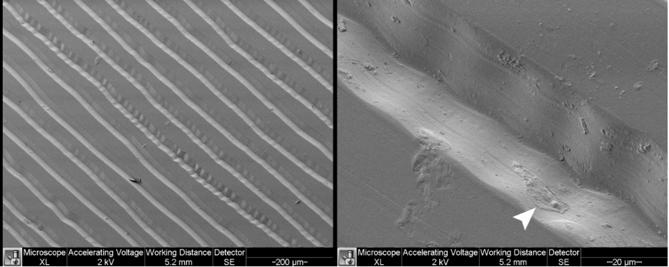

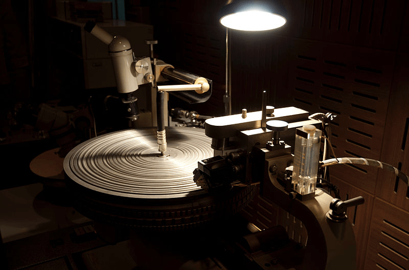

Indeed, the cutting head is driven by mobile coils (MC, but very bigs 😀 ) that cut a "mother" plate, which will serve a limited number of prints in the case of direct cutting discs, and there is a " back up ", a plate "father" to reprint new batches in the case of conventional discs.
But this has nothing to do with the shape of a cartridge's reproduction needle. Check your information on that Neumann cutter, give us the link, if you can. The cutting head is not spherical, elliptical, Shibata, Stereodrhon. etc, none of those geometries designed exclusively for reproduction. I do not know the exact shape, from what I could read in the attachments the material is sapphire and is cooled by helium, even so they can reach 200 degrees Celsius in temperature. .
The complete process is in the attachments, it is interesting to read them carefully.
The discussion here is not whether your TT system is so perfect that you don't listen to the IGD, congratulations on that, but the issue here is whether or not it exists:
"While we're on the curvature subject, it is necessary to explain one more thing. Ever wonder why outside diameter cuts on a record sound clearer and cleaner than inside ones? Unfortunately it's a fact. Why? ....... . "
Time to do homework, read!
Vinyl 101: How to Prepare Your Audio for Vinyl >> Furnace Record Pressing
The Limitation's of Vinyl Records
