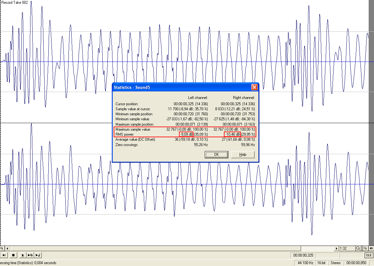

OK, i've checked dubstep. I found this first (UKF Dubstep Mix - August):
UKF Dubstep Mix - August - YouTube
I searched a loud, sustained bass part, low pass filtered (fcorner=100 Hz), renormalised, and made a statistics (attached). On left channel I found -9.09 dB, which means an average power of 0.246*maximal (sinus) power, so it is a lighter load then the burst used for specification. On right channel the value was only -10.46 dB.
As you can see, the waveform contains sustained signal, but not even close to maximal power (because musicians are not insane).

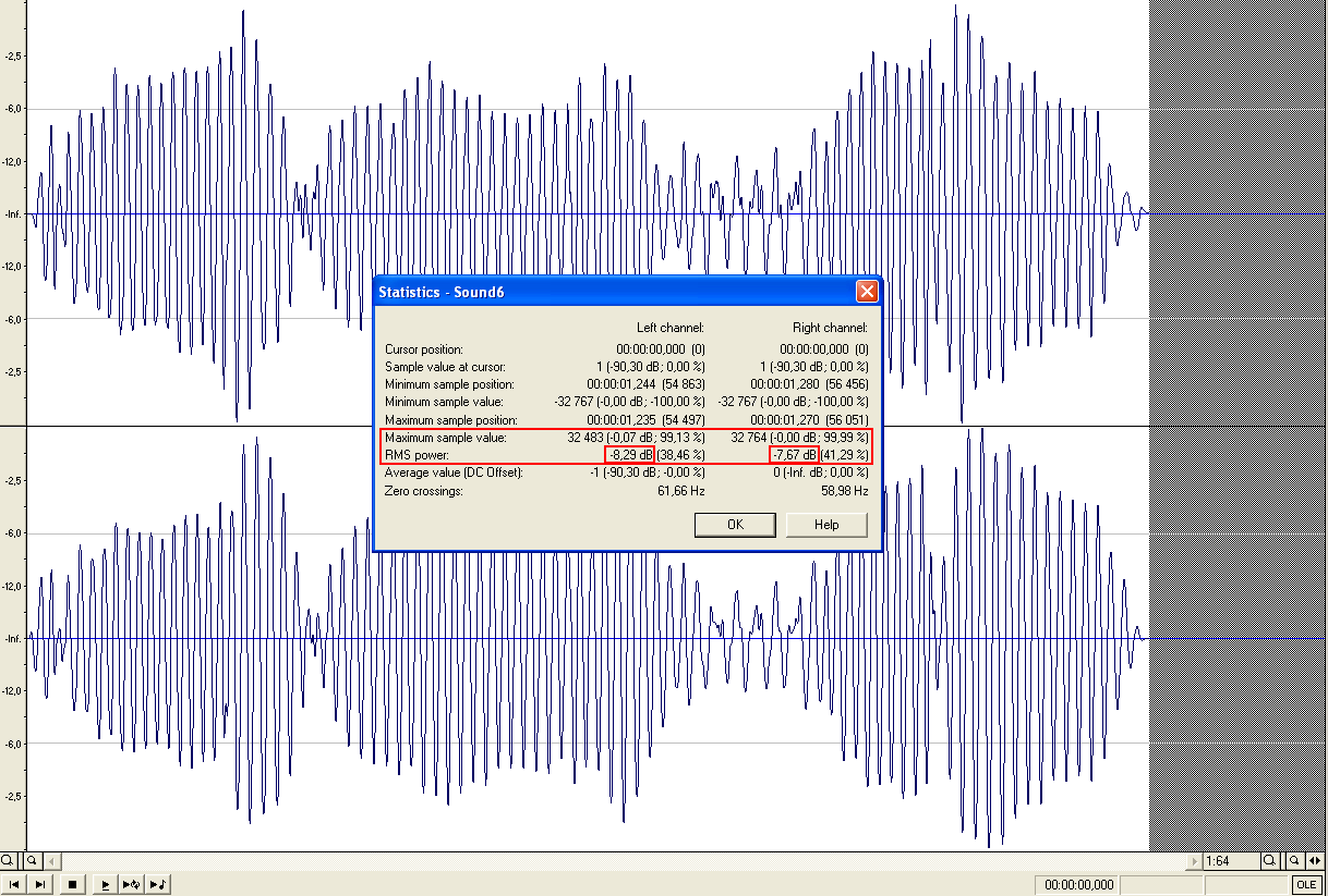

The hardest music I know in this respect is Mr. Oizo Flat Beat:
Mr. Oizo Flat Beat - YouTube
In the loudest segment I found an average power of 0.341*maximal power on right channel (in bass region).
Do you know anything harder?
Of course I know subwoofer test signals with even worse crest factor, but they are not music, and they will kill the speakers if played on maximal power.
