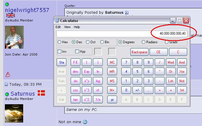

Just ASTOUNDING !!!!!and obviously NOT for DIY, lol.....
Insane, Bizarre, Weird, Amazing, Wonderful, Incredible.....Maybe the highest power amp ever insane 40.000Watts!!!
