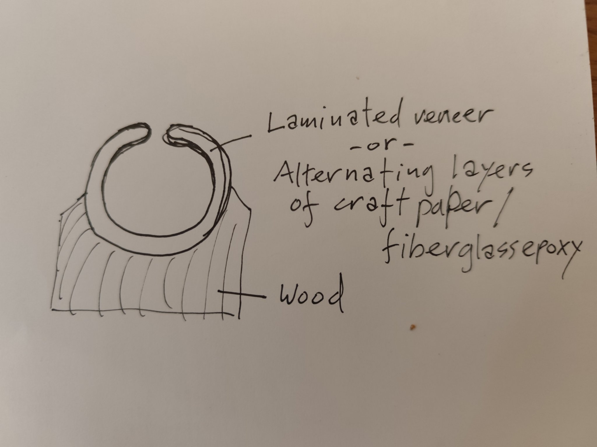

The idea of making the tube thicker closest to the tube slot would seem to help a lot, as it would seem that the pressure wave leaving the slot would apply the greatest stress on the tube at that point. However, if the tube by the slot is stiff and well damped, then the weaker, opposite side of the tube would continue to flex. If we want to reduce resonances as much as possible, and are not concerned about weight, then just make the entire tube thicker, or better damped, or both. Making the tube thicker at the slot would allow you to create a roundover at that point, reducing the resonances created as the sound wave exits from the high pressure to low pressure environment. So not only is the tube itself resonating, the pressure wave itself is resonating due to the design of the tube.
I think that using multiple materials, which resonate/flex at different frequencies, or can damp resonances, can be one means to reduce these resonances. Reinout used the two materials and thought that it was effective to reduce the resonances. Maybe we should ask him what he observed when he used the two materials for his tubes.
Retsel

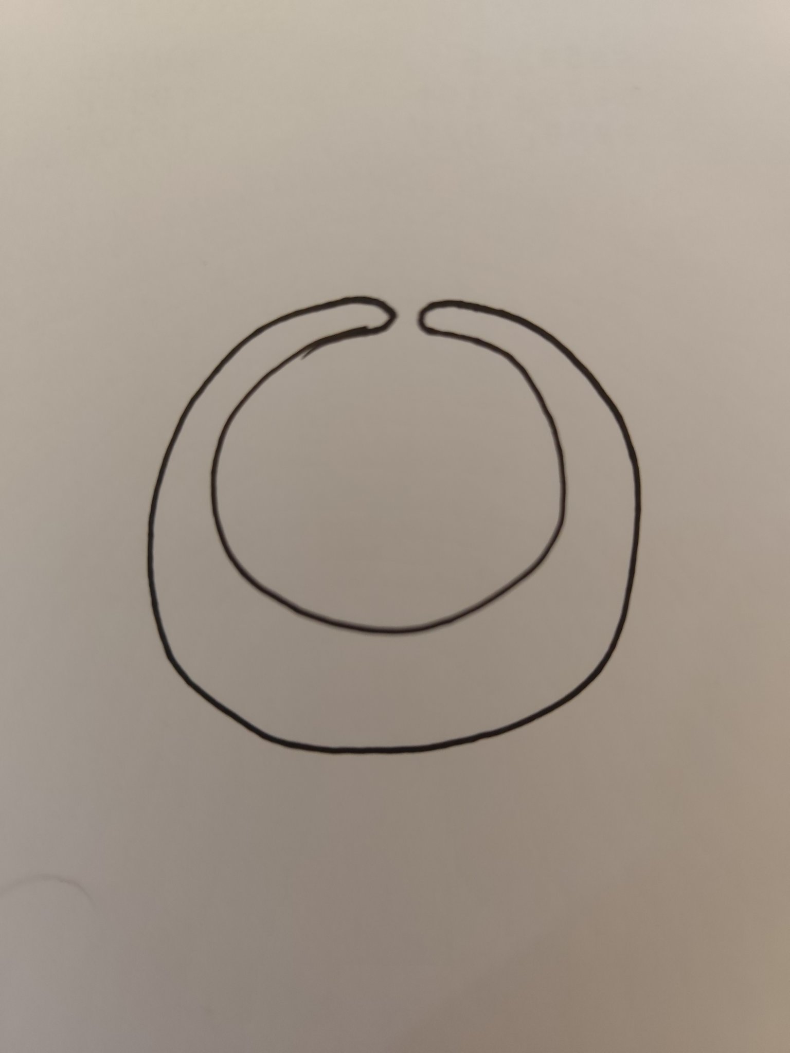

I lack the physics knowledge to judge the effect of a thicker tube (deeper slot). If a thicker wall with roundover works well I would make something like this:
The wood bracing beam in the back halves the cantilever arch distance by half so should also be very effective.
The most elegant solution would be this:
But that would be harder to produce.

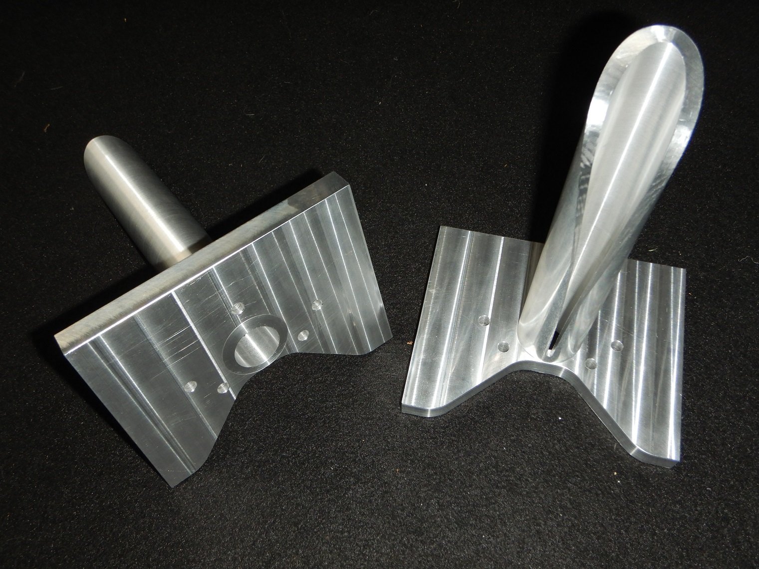

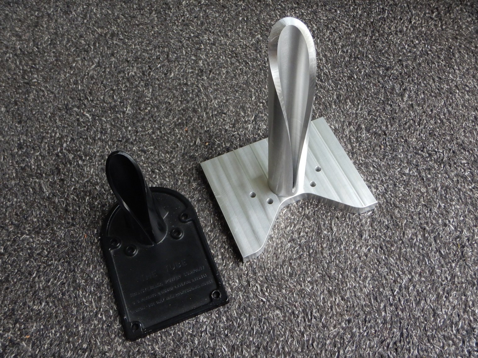

Good evening Erik and Retsel,
both options work (multi-layer or changing wall thickness); as long AS you take tube-resonance into consideration you're good to go.
The original K-tube was not bad as it has some inheritant anti-resonance features because of the production proces (= casting !):
  • the tube had the most minute tapering in order to get the innards clean of the casting-form. This 2 degree angle makes it more difficult for standing waves (= resonance) to travel thru the object.
  • there are some mechanical supports next to the base-plate in order to make the tube more rigid to that base-plate. Perfect resonance control !

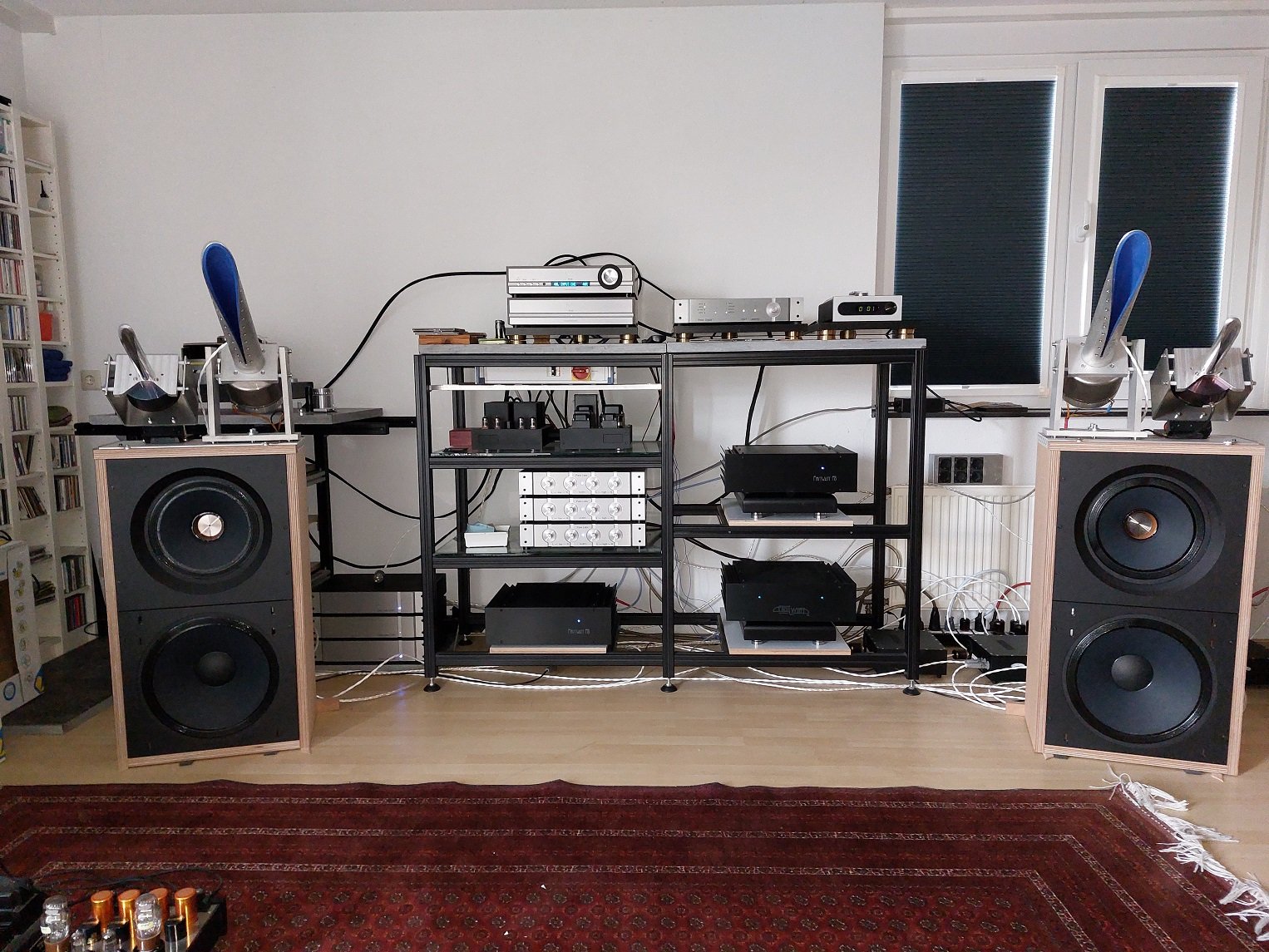

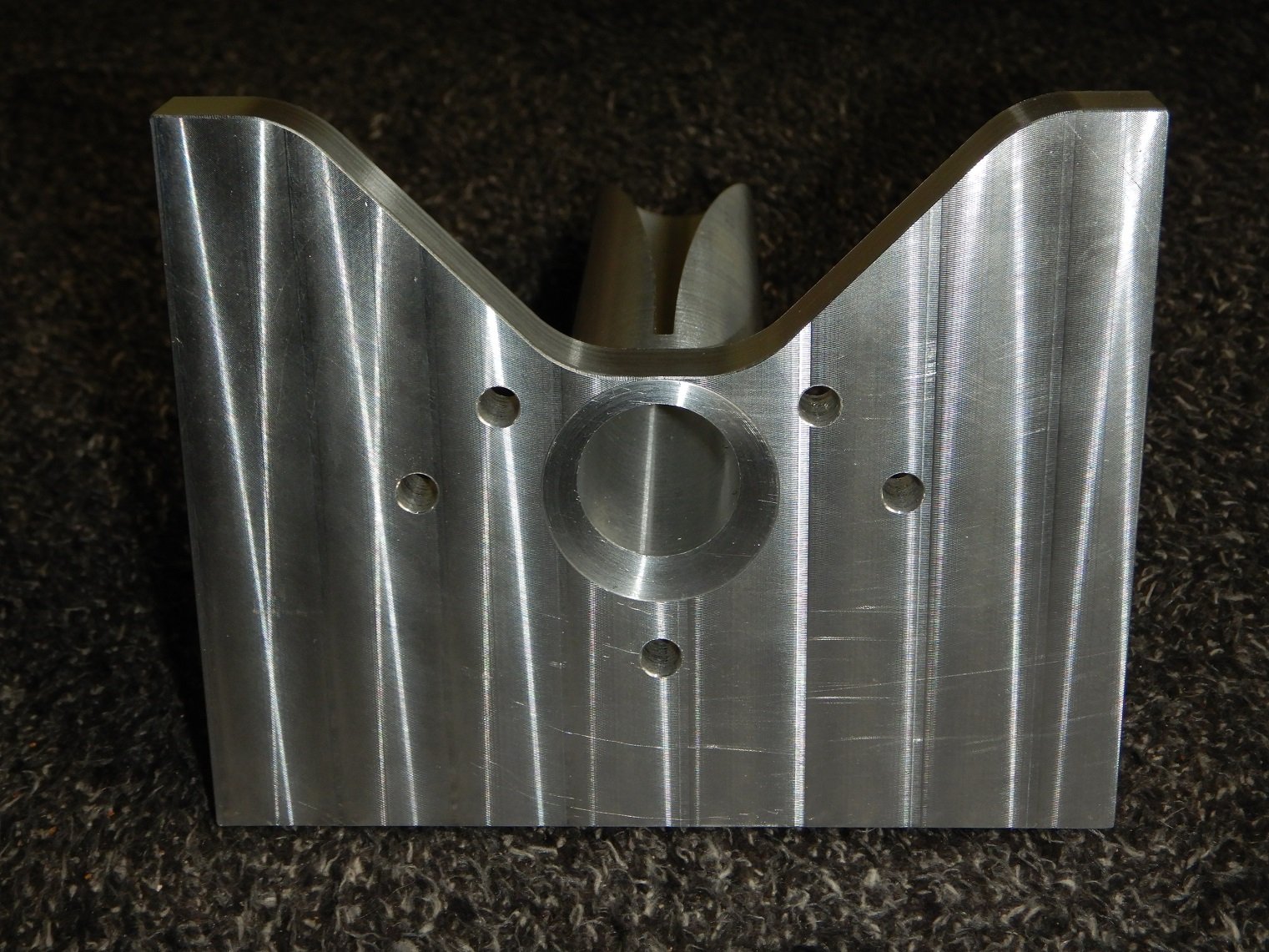

I did numerous resonance tests and finally used 2 versions to get the k-tube under control:
  • for a small tube a use the most technical "advanced" version: different wall thickness ! An incredible old-fashioned but very effective way to supress resonances. I've made the wall thickness at the slot-side the most thin and at the spine the most "thick". Vice versa I do not promote as your radiation pattern will be influenced by that thick transition from solid-to-air. Pictures included. And it is just like Erik's draft.
  • for a big tube the above mentioned system is not the way to go for price reasons and logic. You need a 5 axis CNC machine which must be capable of an exentric hole (ok....), an exponential slot with the sides perpendicular to the axis (ok for a certain price), a 2 degree tapering (slowly but surely the price shall rise...) and that with Erik's ratio 1:10 shall need a CNC-range of 20" for a 2 " driver.......for my that is impossible so i settled for the next best option: combination of layers: a metal and a plastic being the logical combo. You're spoilt by choice.....
(excuse my lousy English)
Reinout

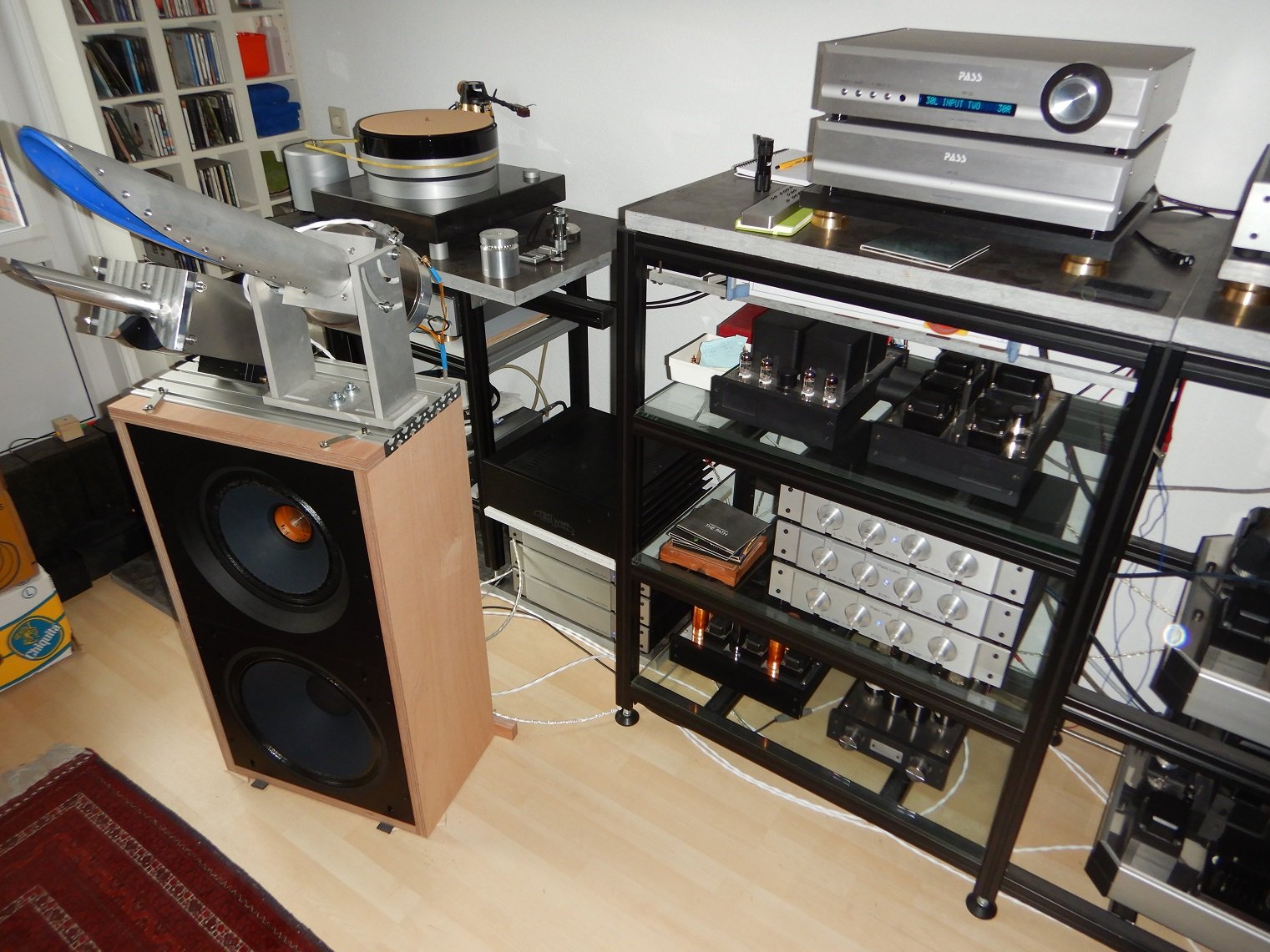

Mid november i'll join the ETF (European Triode Festival and i'm planning to bring along the active 4 way speaker system (bas+bos/mid open bafle; mid and high by compression drivers + K-tubes. ALL drivers fieldcoils.). Will be interesting. Pictures of the speakers enclosed

Thanks Reinhout for your response. It would make sense that different materials, and/or variations in wall thickness, would help in dampening the resonances caused by vibrations in the tubes. Were you able to make any measurements which could document this effectiveness, before and after?
You seem to conclude that the tube vibrations are the only resonances to be concerned with. However, it is well established that abrupt changes in physical surfaces also cause resonances, creating Higher Output Modes (HOMs). The abrupt change in physical boundary (the edge of the slot) will cause a reflection backward towards the sound source, in case of the tube, either to the back side of the tube - opposite of the slot, or all the way back to the driver. Compared to horns, the transylvania tubes have an advantage by having the discontinuity at different distances from the cone, thus, instead of creating such resonances at a single frequency - created at the mouth of the horn - the tube spreads the resonances over the whole range of frequencies. While that would help to reduce the prominence of the resonances, they are still there. If we want to make a better tube, so to speak, we would want to change the design of the tube to prevent these resonances. We know from experiments with horns that a large roundover at the horn mouth prevents these resonances from occurring (the Le Cleac'h horns) smoothing the frequency response. Earl Geddes accomplishes a partial fix by adding open cell foam in the horn throat which helps to attenuate these resonances It may be worth trying this for these tubes. However, another potential fix would be to make the tube wall very thick at the slot, avoiding creating the resonances in the first place. You and Erik seem to discount this option but this would fix both the tube vibrations and the edge discontinuities.
One other source of a resonance is the discontinuity where the tube mates with the compression driver. Compression drivers usually have a fixed exit angle, which is not 90 degrees, and to avoid creating resonances at this point, the tube must be expanding at the same rate as that inside the compression driver: https://www.diyaudio.com/community/...s-to-compression-drivers-a-discussion.397699/
While it could be argued that the tube slot spreads out the resonances over many frequencies caused by the slot, any mismatch of the tube entrance angle to the compression driver exit angle will create a resonance at one specific frequency. I e-mailed B&C to find out what the exit angle is of the DCM420 drivers which I am using, but I did not receive a response. Once I find this out, I will need to figure out a way to account for that.
Retsel
I am not discounting any possibility. I just don't have the knowledge to judge one way or the other. My gut instinct tells me you want the wall thickness at the slot thin but I am aware this gut feeling could be wrong.

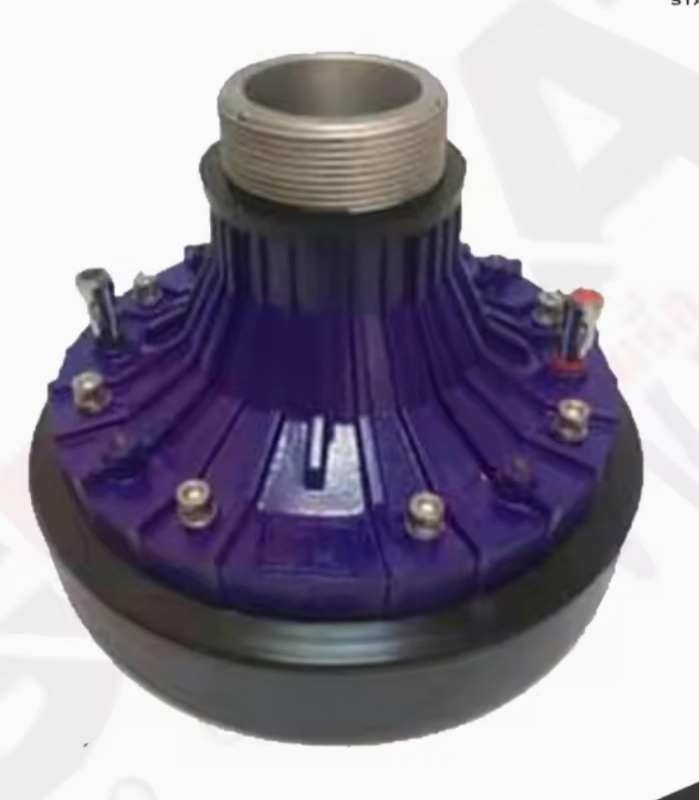

The 2.5" pipe with weak motor fr driver sounds promising but most definitely cannot keep up with the hf compression driver. SO NOW I FOUND THIS:
A 2.5" exit, 650W, 88.9mm voice coil compression driver. I really don't know a thing about these monster long throw outdoor public address drivers but I would like to try. I have a bunch of bills to pay soon......if I have some money left over I may get one just for the heck of it. I can get one for around 90 bucks. I guess the only country where you could get these cheaper is North Korea. I like the look of that diaphragm. Looks like a ring radiator with total diaphragm diameter of almost 15 cm.... that's insane!
I can see a project with a Klipsch Heritage bass horn with a 2.5"/70cm k pipe doing 300-3000hz and a 1"/23cm k pipe with 18sound nd1tp compression driver doing 3000hz and up
I would love to get a pair of these compression drivers where to get them from if you don't mind sharing
As Eric wrote in post #9, Standard Audio Co. LTD "This being Thailand the manufacturer link is not working."
Might find out more on Facebook:
standard audio co.,ltd
https://www.facebook.com/0869860760SA/
I received the 2.5" monster compression driver and was very disappointed. It has many weird and very loud resonances from 100-600hz. Makes the driver totally unusable. Only above 600hz does it get better. So I am returning it.
