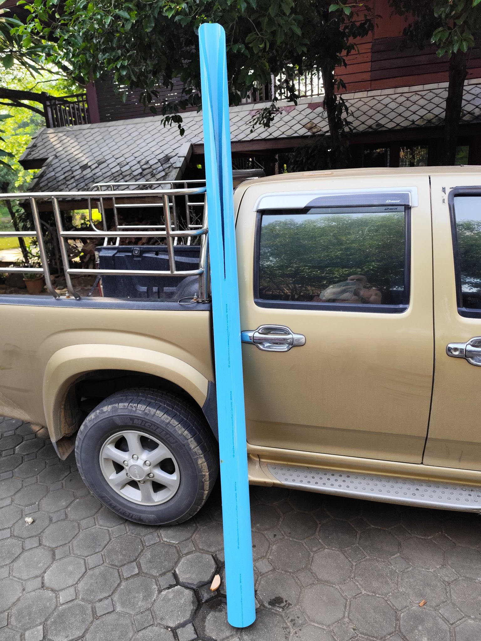

Yesterday I made my first k pipe tweeter from some old piece of 1.5" PVC pipe and a cheap p-audio 2" compression driver. This sounded so promising that I kept on tinkering. I found a larger 2.5" pipe and mounted a 4.7" full range driver with a quickly hand cut foam adapter.
The result was quite bad. When I slowly did a manual frequency sweep there I could hear lots of little resonances and crazy didgeridoo noises..
I almost abandoned the experiment but last minute decided to try stuffing. I put some polyfill in the bottom 1/3 of the pipe the result was stunning. No more resonances and only very smooth sound. It almost seems like you could use stuffing as a crossover so you could forgo a lowpass on your midrange pipe.
I also tried some stuffing in the smaller tube but that killed the high end.
If I have some more time I want to measure to verify what I hear. I also like to experiment with different materials. I have a feeling cardboard tubes may sound better than PVC.

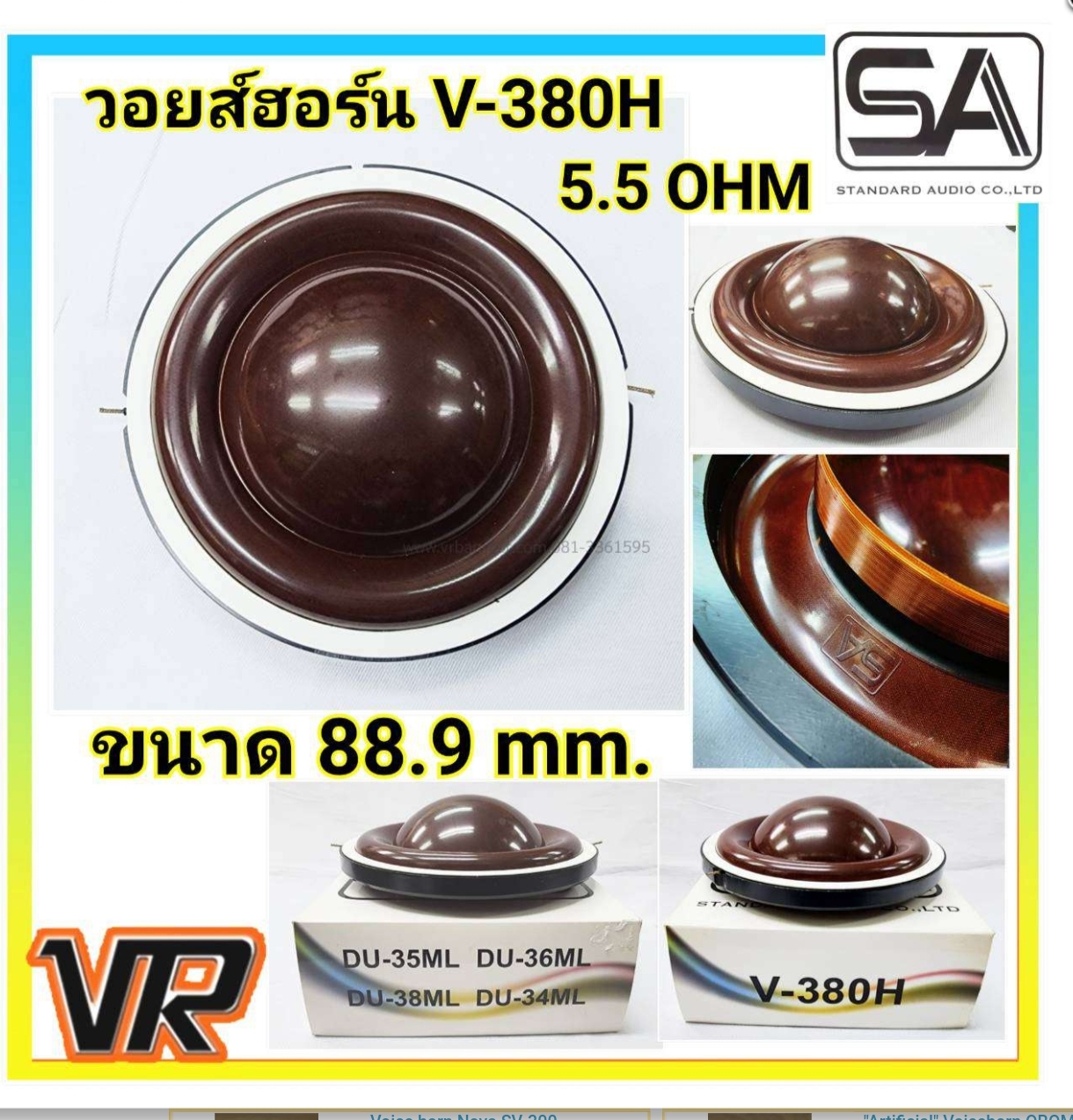

A 2.5" exit, 650W, 88.9mm voice coil compression driver. I really don't know a thing about these monster long throw outdoor public address drivers but I would like to try. I have a bunch of bills to pay soon......if I have some money left over I may get one just for the heck of it. I can get one for around 90 bucks. I guess the only country where you could get these cheaper is North Korea. I like the look of that diaphragm. Looks like a ring radiator with total diaphragm diameter of almost 15 cm.... that's insane!

The standard for thread-on PA drivers is 1 3/8" 18 TPI, the exit typically varies between ~5/8" and 1".
A 2.5" thread-on PA driver would be quite unusual, I haven't found any examples of drivers or horns using that size on line.

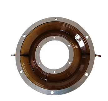

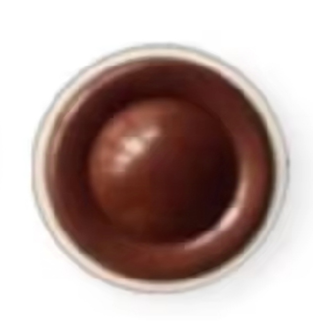

A ring radiator diaphragm is annular, shaped like a ring, the voice coil located between the inner and outer ring portions of the diaphragm:I like the look of that diaphragm. Looks like a ring radiator with total diaphragm diameter of almost 15 cm.... that's insane!
The diaphragm you posted is a dome, not a ring radiator like the one above.
The effective radiating area of a dome diaphragm is only that of the voice coil, it's surround outside the voice coil does not count towards it's displacement.
Probably more likely the domes overall diameter is 89.9 mm, it's voice coil in the 50mm/2" range.
That said, 75mm (3") and 100mm (4") phenolic diaphragms are common, with exits from ~25mm (1 3/8") to 50mm (2"), but not thread on.
Do you have a manufacture link to the driver?

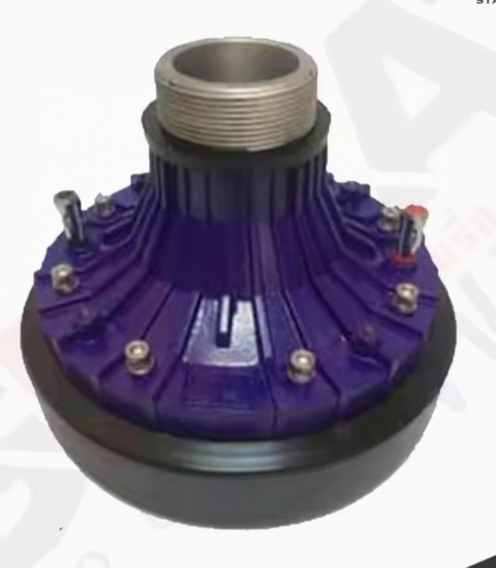

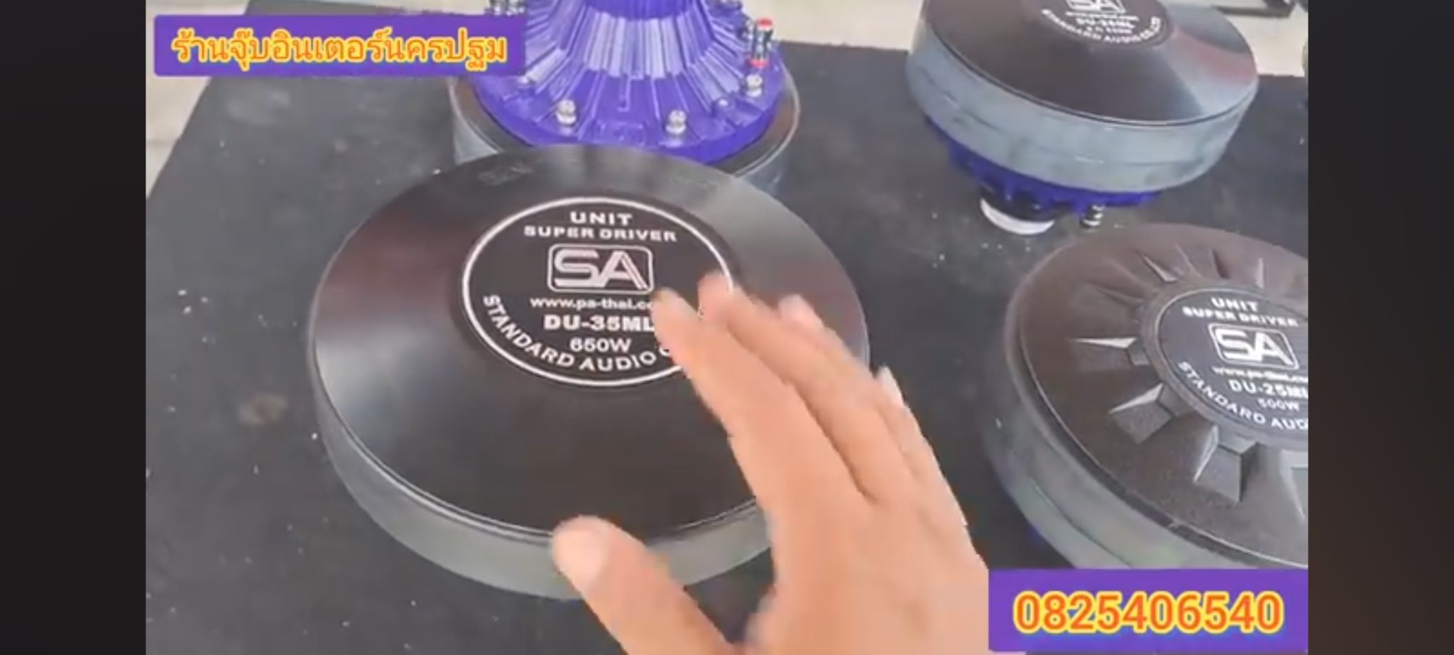

This one most definitely is 2.5". This brand sells them in 1.5", 2." and 2.5". In Thailand every street, every village, every temple has public address horns. There is more variety in drivers and they are unfathomably cheap. Some of the horns are humongous. They use a manifold with 4 drivers or one bigger one.The standard for thread-on PA drivers is 1 3/8" 18 TPI, the exit typically varies between ~5/8" and 1".
As you can see from the picture the surround probably has a larger surface area than the actual dome. So I guess half of it should be counted towards cone area and it probably has a way longer stroke so it can move a lot of air.The effective radiating area of a dome diaphragm is only that of the voice coil, it's surround outside the voice coil does not count towards it's displacement.
It says voice coil 88.9mm......and the cost 15 bucks 😂
This being Thailand the manufacturer link is not working. For most drivers sold locally here it is impossible to find parameters. If you are lucky they give you sensitivity and a frequency range. To get a feel for the size I made screenshots from a YouTube video.Do you have a manufacture link to the driver?
I just realized these are a perfect diyAudio house style purple 💜

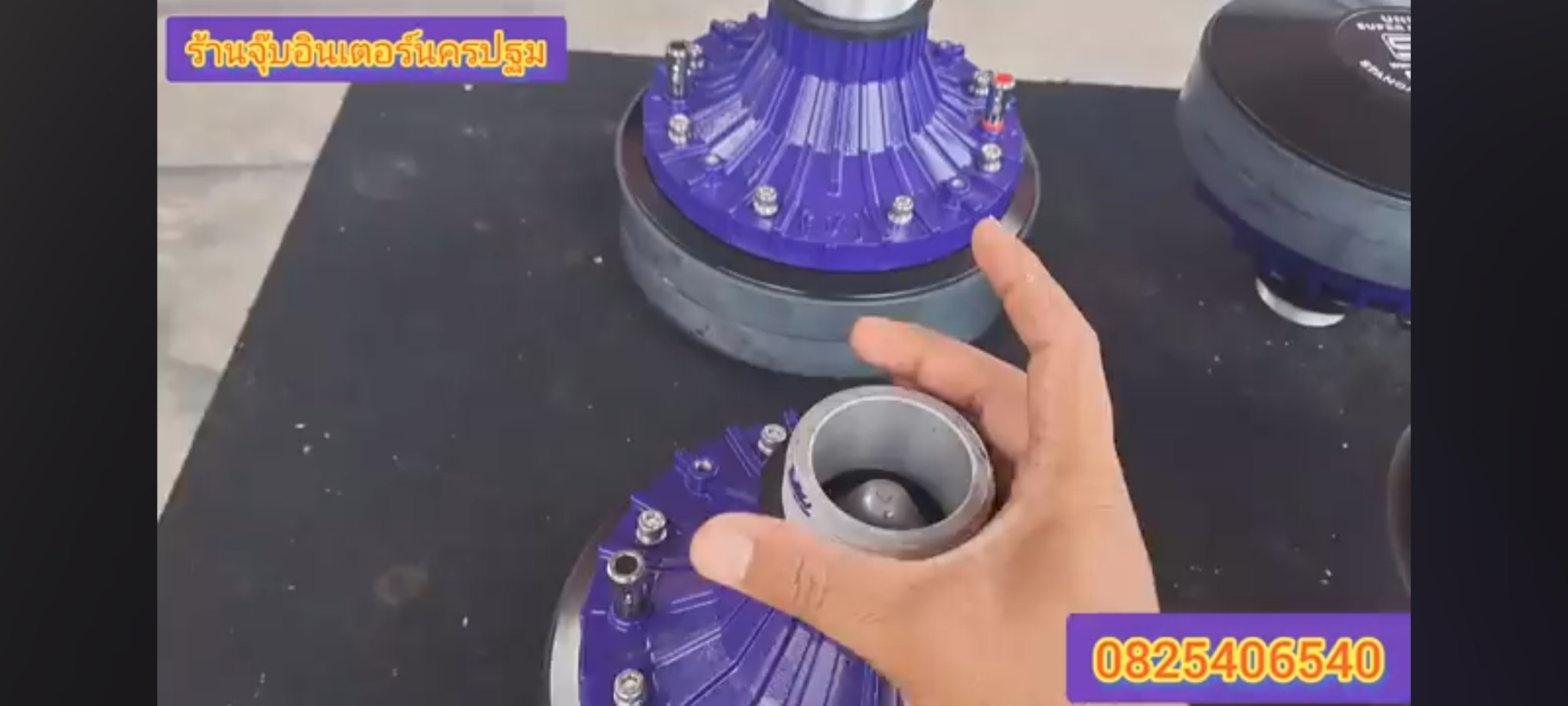

The output contribution of the surround (if any) would be dependent on the phase plug design.As you can see from the picture the surround probably has a larger surface area than the actual dome. So I guess half of it should be counted towards cone area and it probably has a way longer stroke so it can move a lot of air.
The convex side of the diaphragm facing the exit is unusual.
Looks like it's excursion would be far greater than any PA compression driver I've ever seen, Id' be surprised if it could make 3000Hz before it's acoustic band pass.
Looks like it could be fun to experiment with!
Until recently I haven't seen anything like this either. I ordered one (there was a sale, I got it for only 75usd) to test because I have no idea about it's sensitivity or usable frequency range.......or it's weight!Looks like it's excursion would be far greater than any PA compression driver I've ever seen, Id' be surprised if it could make 3000Hz before it's acoustic band pass.
I just saw there is even a more powerful 850w version but that would be killing the overkill.

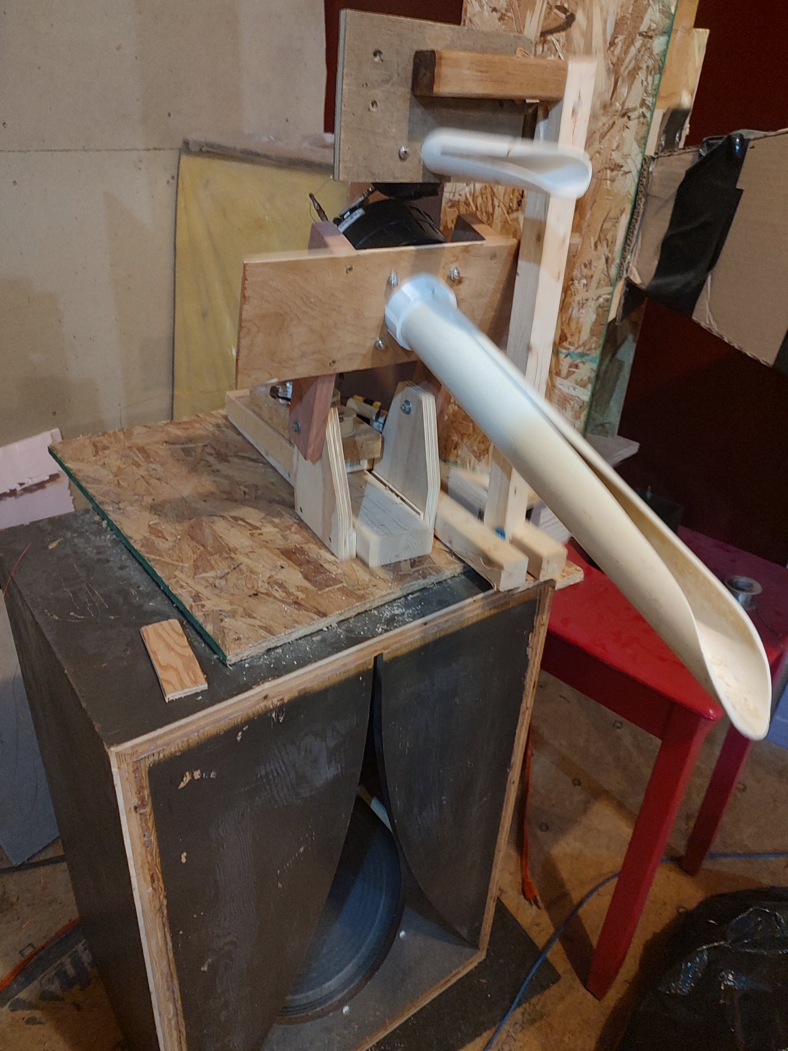

I am currently experimenting with a pair of midrange Transylvania tubes - see the attached photo.
I made the Transylvania tubes out of PVC pipe, but if I decide that I want to pursue this pathway further, I likely will experiment with alternate tube materials and configurations.
