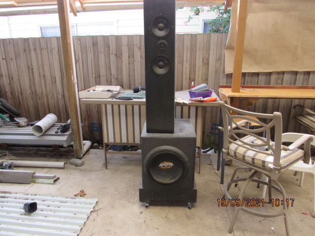

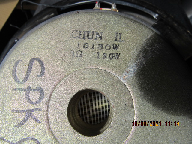

My beloved wife has suggested I make a big party speaker with this.
If I use OB would crossing at 120/150 be too low?

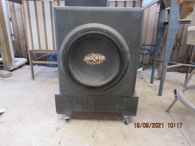

I have the a 5.6mH and a 9mH on the shelf and could find some bloddy great big caps for a 2nd electrical on the mid, I have some cheap tweeters to fill in the top; the woofer would be the old Kicker 15 in the 220 litre sealed box.
OR
Should I run the driver full range and simply add in the Kicker as a .5 driver?
OR

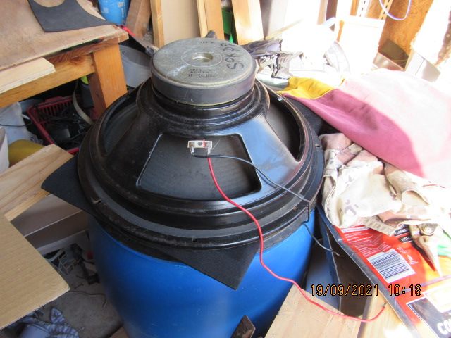

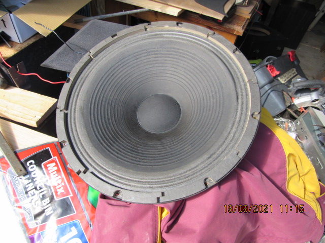

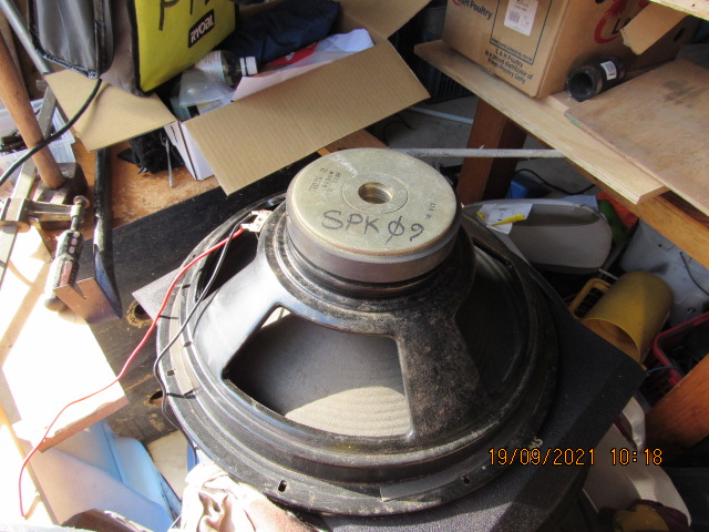

THIS-THREAD-IS-WORTHLESS-WITHOUT-PICTURES 😀

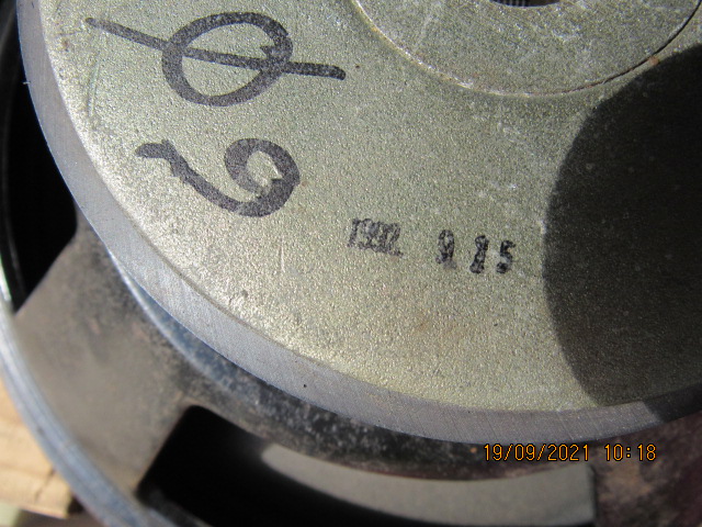

Show front-back-side and any inscription on it, even if a small rubber stamp or written with chalk on the cone, all matter.
As requested some pix
The old tops sitting on the sub box are a pair of old Tandy 8" drivers; sold as a subwoofer but actually a damned good efficient midrange.
Looking serious. Vented pole piece, big magnet.
Have you tested it to get the T/S parameters?
That and the impedance curve will tell you a lot about a probable application.
