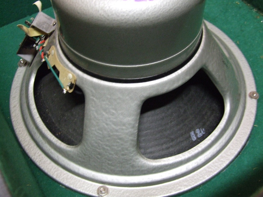

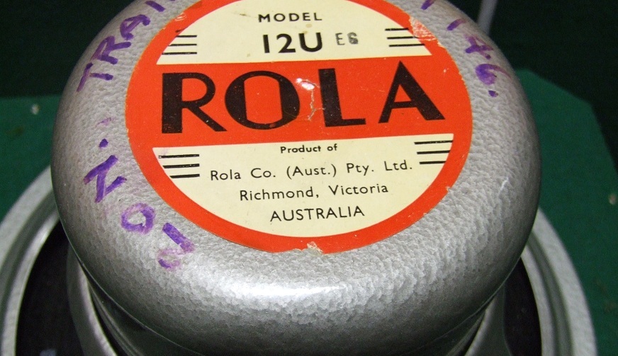

I've just been given a large single speaker by the feller that does amp repairs nearby.
He says it came from an old organ. Sounds OK just sending some music to it sitting on my untidy desk. I just wonder if anybody can help out with some details. Even an approximation of use.
All I can see on the back is "CHUN - IL" 15130w
8R and 130w
1992 and 915 at the bottom
Smallish magnet for the size of the cone but a big vent; bass is reasonable but it seems to have a decent but climbing midrange
Pix if needed. What am I going to do with it?

I'm guessing it's paper, with a surround that doesn't look like it was made for much excursion, with a stiff spider and a number of annular striations?
Would you consider it for bass duty because it's only one? If it has enough excursion I'd probably measure Fs and Q, from here you could see which enclosure type it would prefer.

That's it to a "T" Allen. I have two of the large Jaycar 15" woofers in the shed, they are similar but without the vented voice coil. The Jaycar have deeper bass tho.
If I was into Mono a I would have no trouble with a design, the Jaycars on the bottom side by side with this centred above then in a Wharfedale sand filled baffle OB
