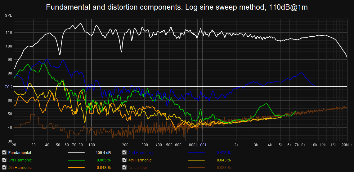

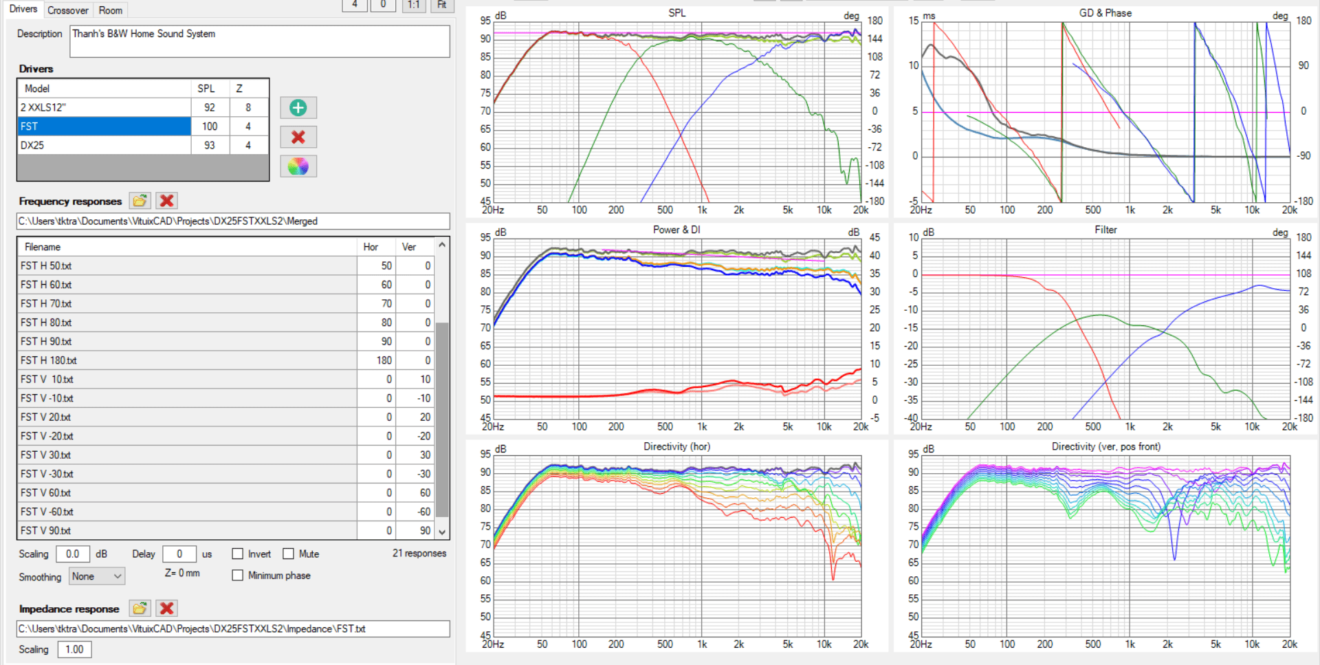

For reference level / concert level dynamics (85dB average SPL at the listening position, with a further 20dB headroom) my system uses twin 12" woofers:

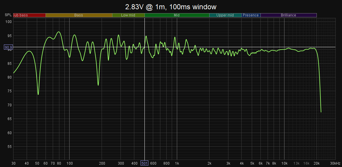

Some old photos and measurements:
Unfortunately, the design is not able to be built by others because the woofers (Peerless XXLS-P830845) are difficult to source, but even worse the midrange is somewhat of a unicorn (B&W LF26611 - a one-off custom FST) and virtually impossible to source- owned by probably only a handful of people in the world...

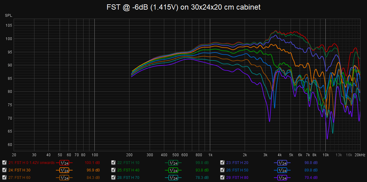

how efficient is the mid?
Depends on the frequency.
On baffle- driven with only 1.415V:
Conservative estimate on an infinite baffle (2pi): 98dB/2.83V

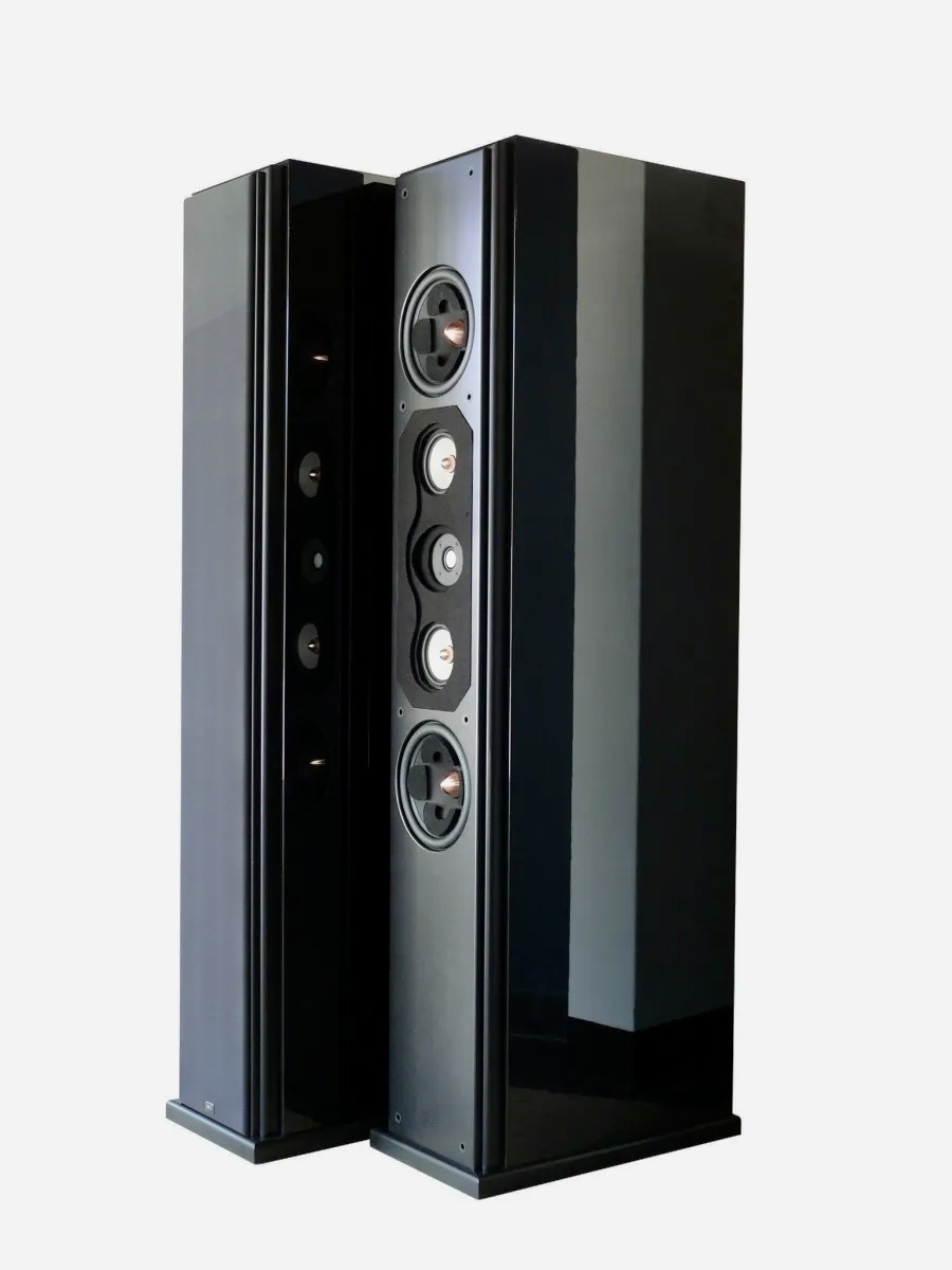

I was Just looking at the Kartesian Mid120_vHE ...It should be on par with that B&W.midrange is somewhat of a unicorn (B&W LF26611 - a one-off custom FST) and virtually impossible to source- owned by probably only a handful of people in the world...

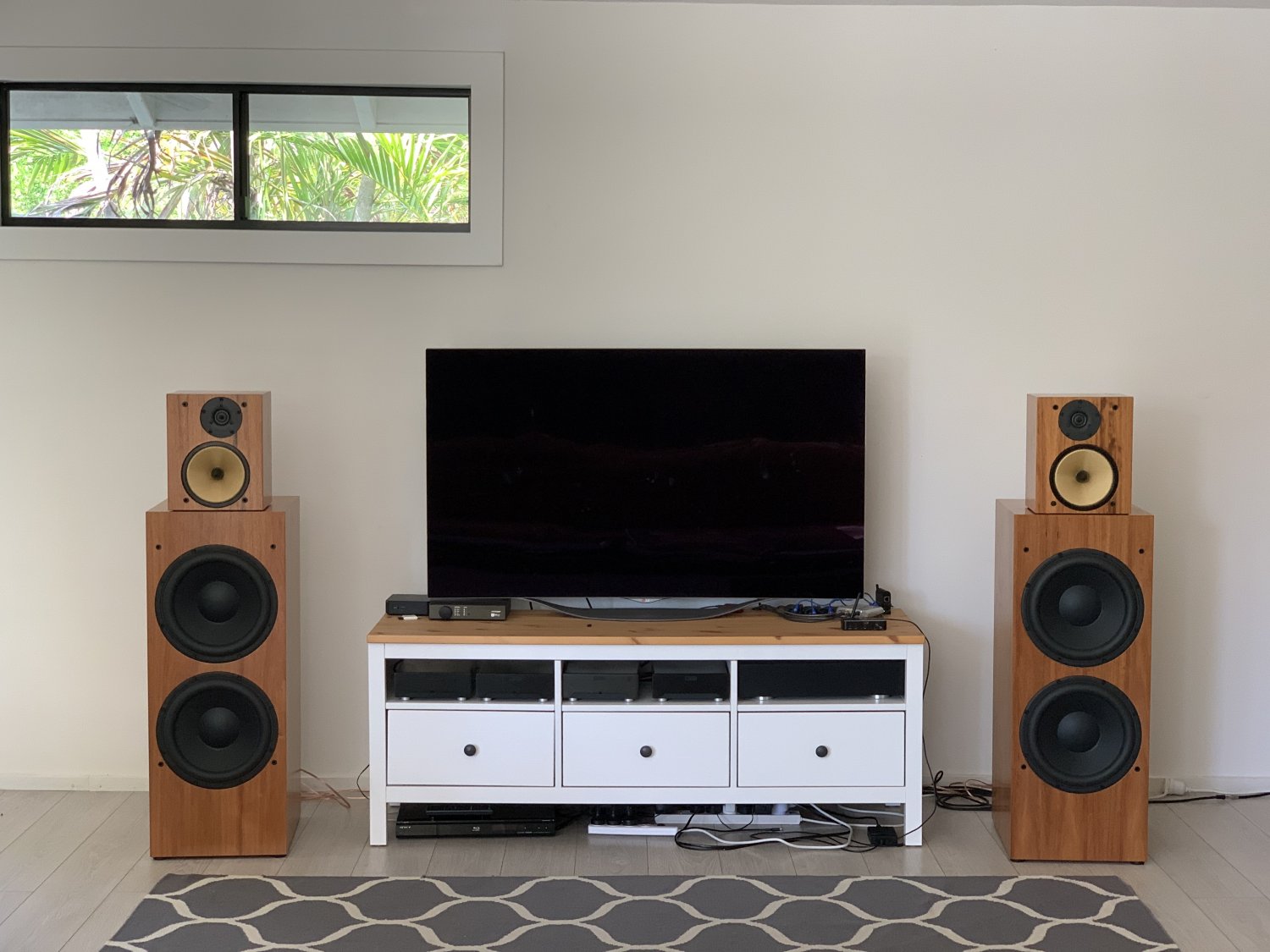

Here’s a photo taken with the least parallax error to compare sizes:View attachment 1110690
Top:
SB17NAC
Middle- “ 6” FST”
Bottom- NE180W
Right- PTT6.5
