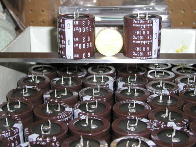

I saw some 3,300 uF 63 VDC caps, that look exactly like yours Hpotter $1.25 ea. I was thinking of putting 50 together as a Capacitor bank.

Is this a fact? I have been told that there is a rapidly diminishing return on parallelizing smaller capacitors to decrease ESR impedence. The other problem with having too many parallel caps is the increasing parasitic inductance. Has anyone in here done a study on the optimal number of caps to put in parallel for optimal ESR?How you like those? Only $1.5 ea. Smaller caps are apparently better sounding.
Coulomb said:I was thinking of making a PCB to mount them all on.
One like that?😉 I bought hem from Sayal and used in Aleph5 and that board goes into SOZ.
nania said:Has anyone in here done a study on the optimal number of caps to put in parallel for optimal ESR?
I didn't.😉 But in one of the posts gnomus said that he experimented with caps in his SOZ and smaller sounded better. He also recommended lower value than 10k uF for parallel caps. Since I can't refuse deal like that, I decided to use those Nichicons. They 105 deg C and make nice sound when you knock one another.😉

There is no design. I just drilled the holes and cut spaces with a blade.😉 As I said before, I'm not doing PCBs anymore.
Joined 2002
Pluses in one row, minuses in another, spaces in between. Eight rows altogether. If you smart, you'll put two minus rows beside ea other, the same for pluses, so instead of 7 spaces you'll need only 5.
