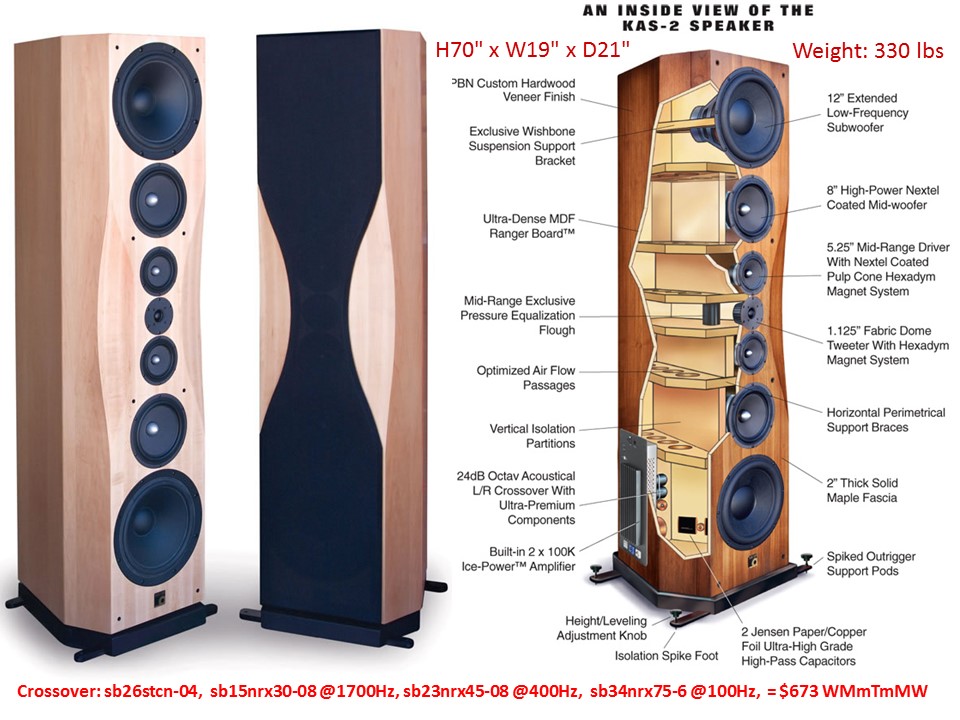

Build one large low diffraction cabinet like PBN KAS-2 to reduce vibration and share woofer volume. CNC the complex beveled baffle.
Use SB Acoustics (1", 5", 8", 12" ) 7-speaker set WMmTmMW =$673
1" dome tweeter R3=3.2 92.5db LR4@1700Hz to balance: manage lobing; max tweeter power
sb26stcn-04 @$33
-LR4@1700Hz to balance: manage lobing; and max tweeter power
5" midrange. Re=5.7 88db sealed
sb15nrx30-08 @$56 *2 = $112
-LR4@1700Hz and LR4@400Hz for easy max power
8" woofer. Re= 5.6-ohms 88.5db sealed
sb23nrx45-08 @$92 *2 = $184
12" woofer. Re=4.2-ohms 90db
sb34nrx75-6 @$172 * 2 = $344
purchase two miniDSP 2x4 HD
---Digital inputs, USB streaming, advanced plug-ins
Purchase suitable amplifiers
===============OR===THIS============

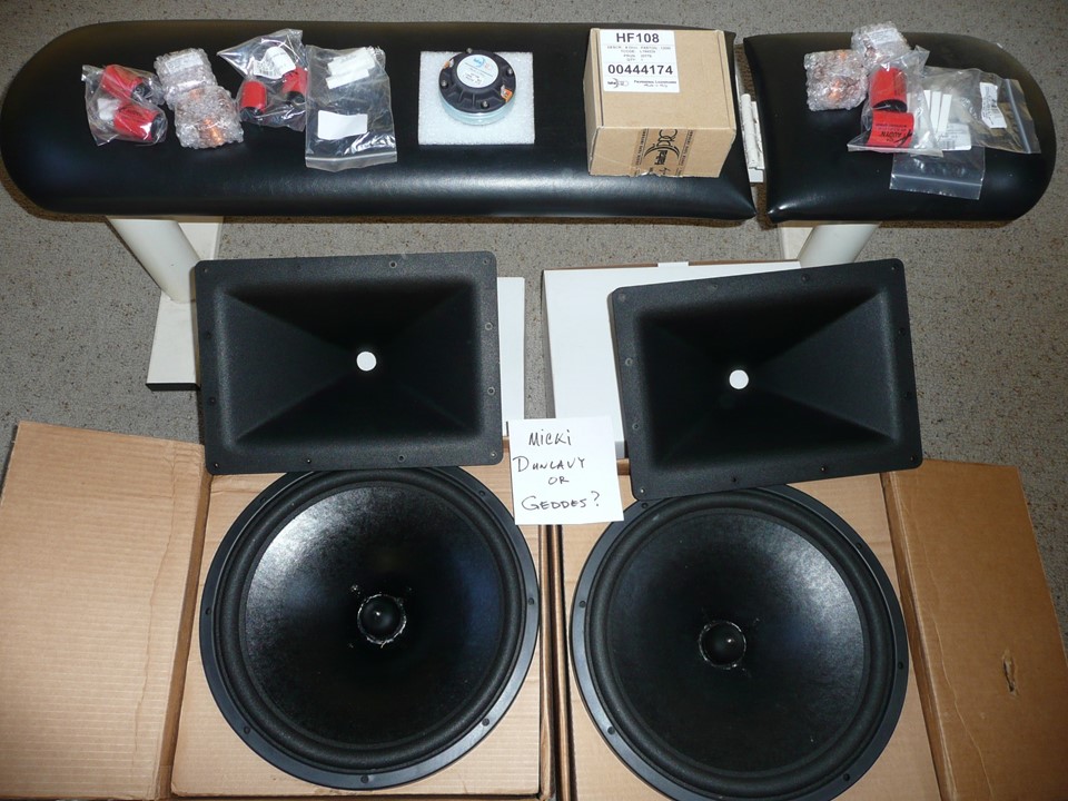

GEDDES CONTROLLED DIRECTIVITY IS BETTER SCIENCE!
Study the Geddes paper, and Red Spade audio in Australia.
horn tweeter
or
horn mid+tweet
plus
a couple support speakers like in early pictures

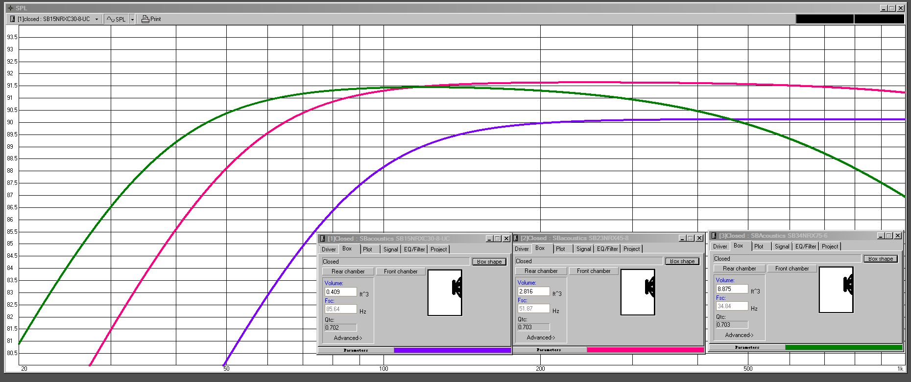

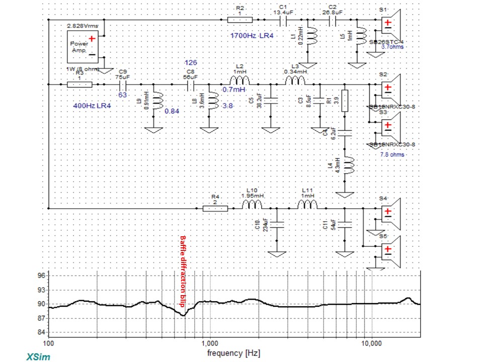

--If you continue to work on a Dunlavy inspired PBN KAS-2 clone, I attached a quick Xsim of the SB-Acoustics MmTmM drivers just to illustrate the SPL balance of this driver combination. The baffle diffraction blip on the SPL plot is partially due to the simple baffle simulation tool/model I used. The PBN engineers were very smart when they used a smooth circular arc shaped bevel around the MmTmM instead of the trapezoid shaped bevel cuts allowed in the simulator. A passive crossover for this MmTmM on a PBN KAS-2 copied baffle, plus a plate amp with a built in LR4 crossover for the pair of 12" woofers should sound decent until 4-amps + DSP perfection is completed.
Dunlavy vs. Geddes Directivity

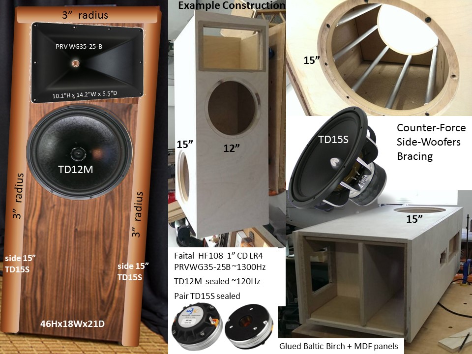

If you are now considering smaller cabinets.
https://www.pinterest.com/localhifishop/tweek-geeks-bmf-speaker-in-the-making/
My next build uses a horn tweeter to control directivity from 20kHz --> 1.3kHz.
Goal: Build a low diffraction variation of the BMF-1 cabinet construction.
-Tweet = Faital HF108 driver on PRV WG35-25-B waveguide
-Midbass = sealed Acoustic Elegance TD12M
-Woofs = side-side pair sealed Acoustic Elegance TD15S
Passive TM crossover, with active analog Xover between TM and woofs.
Plan is to experiment with black high density fiberboard for the thick stacked baffle required for 3" radius edges.

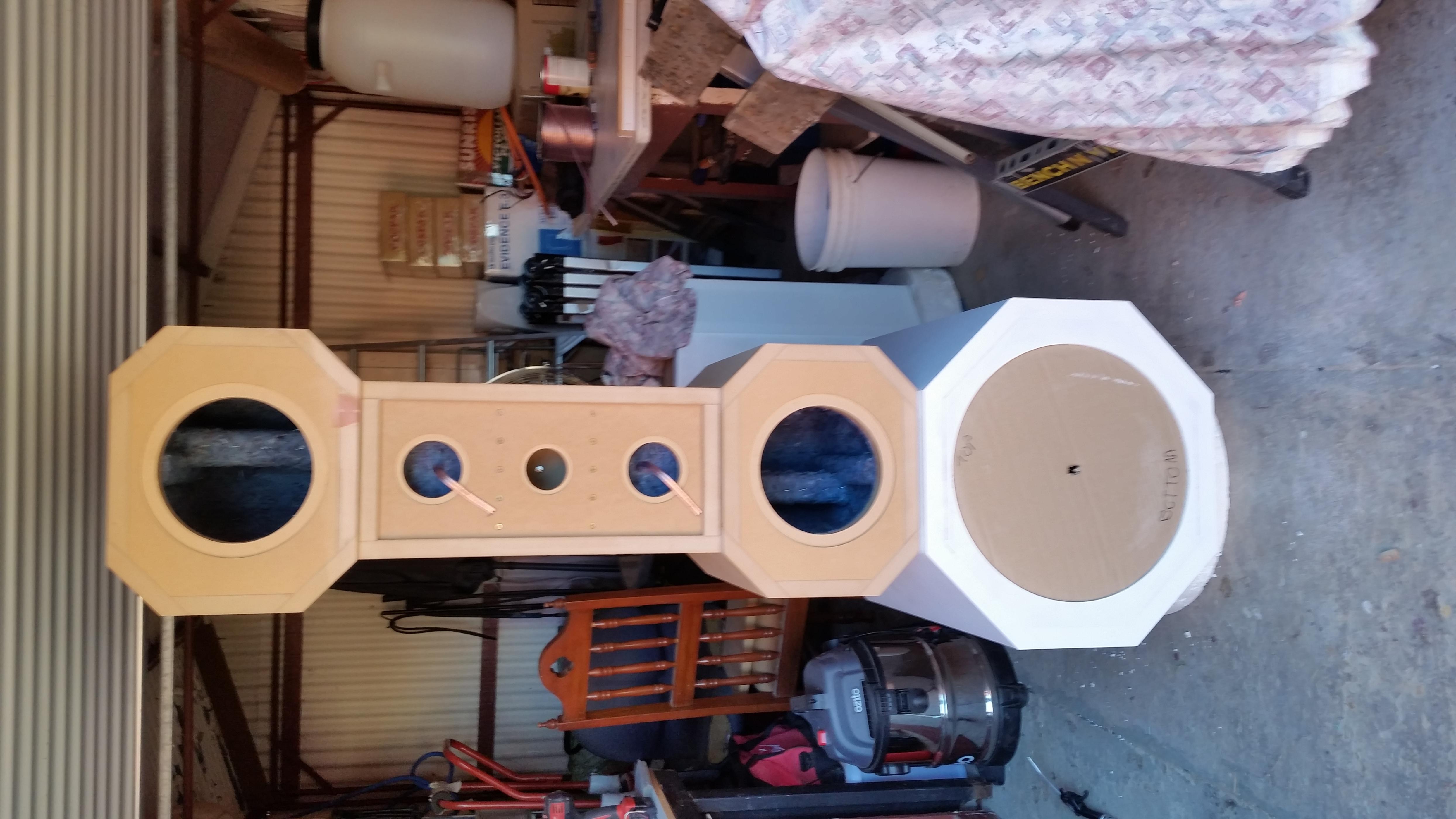

Latest update.
Lots of work has been done. Labour of love making speakers. I have had lots of help from diy members offline from here and have made some really great friends in the process, without their help I would never have progressed this far.
Ended up going 4 way-6 drivers with octo baffles for the woofer and bass. All individual enclosures for the woofer, bass and mtm so 4 enclosures for each speaker. ScanSpeak and SB Acoustics.
Construction is 32 and 25mm MDF constrained layer on all enclosures.
As for the crossover, I have purchased the Ultimate Preamp which is the subject of another thread on here. Fully active, 4 amps per speaker, 750w class D stereo for the woofer and bass and 250 class AB stereo for the MTM.
The digital source is Daphile running from a purpose built PC streamer.
They enclosures are being finished now and I will post some pictures when they come back. Woofer and bass units will be semi gloss black and the mtm is a satin black/silver 25%. They look awesome.

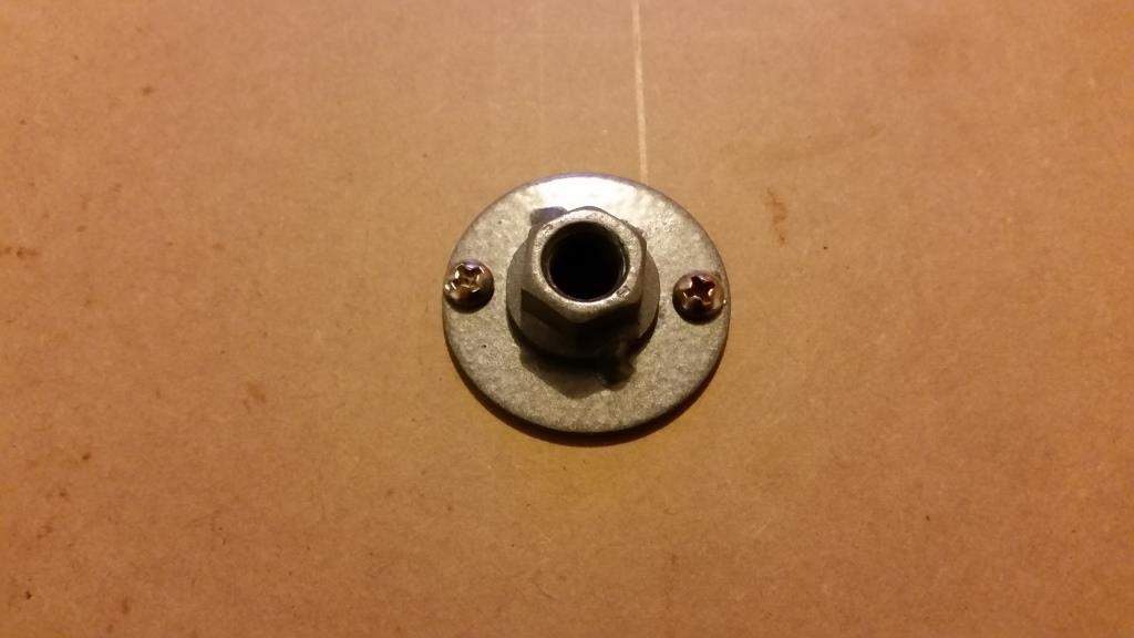

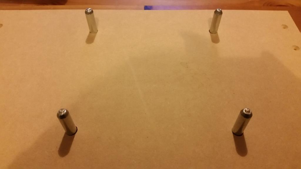

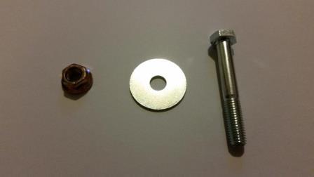

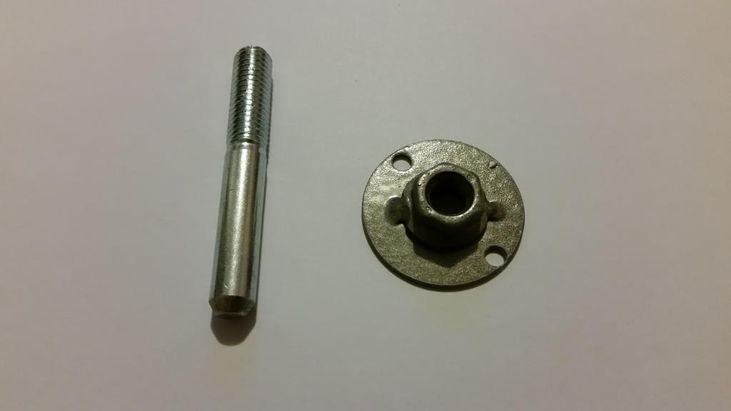

The enclosures are secured together using the following method.
Started out with a nut, bolt and washer. Chopped the heads off the bolts in the bench drill with the angle grinder and ground a 45deg edge on them. TIG Welded the nut to the washer, drilled 2 holes in the washer. This is a blind nut that will never come off.
Four of these are used on each surface of the bass enclosure as placement guides. There are holes in the woofer and mtm enclosure that line up with these steel pegs. The enclosures are then secured at the rear using the same blind nut method on bass and woofer but with machine head screws. I will post some pictures of that when I get them back from painting.

Nice to see how you progressed. Congrats!
I am also considering MTM. What is your crossover frequency between midrange and tweeter, and what is the Center to center distance between midranges? One typical concern is lobbying, which affected by that distance so generally efforts are made to keep it as small as possible.
Yes, those two midranges look far too apart.
I am building 4 way (for home, not pa) with hivi planar tweeter, two 2" dayton domes (only $30 each now), two 6" dayton midbass, and 15" woofer (one per side for now).
I have even removed front plates of the domes to be able to mount them closer to tweeter.
My cross fr will be 150, 800, 4k.
Good luck with build.
Thanks guys.
All distances remain true to the original Sovereign's/SC-IV and John Dunlavy's principles of time alignment. I know they look to far apart but they are spot on. As the original drivers were not available substitutions have been made with far superior drivers than were available at the time they were made 1987-2002. Mid to tweeter is 150mm which is only 5mm less than the Sovereign. I have all the original measurements and plans of both sets of speakers and the mid to mid is 310mm.
Good luck with your builds guys.
Are you going active or passive?
Thanks guys.
What is the crossover frequency M to T?
I'm using the Ultimate Preamp which is also an 8 channel active crossover. Final cover frequency will depend on testing. That's the beauty of active. I don't have to go building swapping soldering passive components and do endless amounts of measuring. I can measure change measure on the fly. So nothing is set in stone.
Right. I also use active. Nevertheless the physics aren't affected and if your xo frequency is such that the corresponding half of a wavelength is larger than the MTM center to center distance, generally lobbying becomes an issue. Hence all the questions. But you don't seem very interested in hearing that.
To answer your question the crossover point from mid to tweeter is 3khz. I know you are going to say its all wrong and for that xover frequency it should be a distance of 5cm or there abouts. However I am building a clone of the original Duntech Sovereign or Dunlavy SC-IV. And those are the measurements. And thats what I am building. It worked fine in the originals. Point source at 10 feet. There are plenty of articles around that explain John Dunlavy's work.
