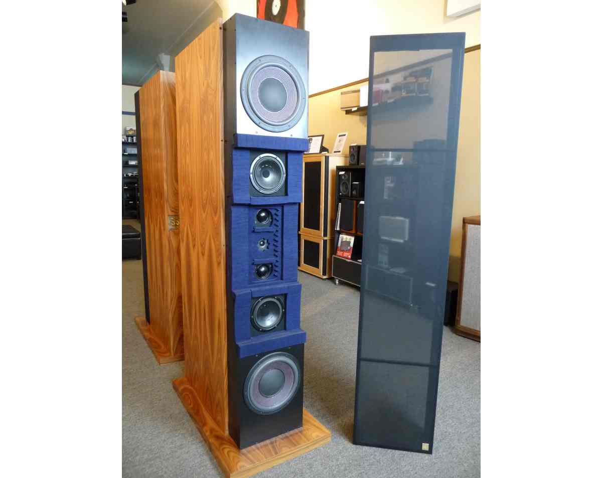

Dunlavy 4-way designs with 1st order crossovers required small diameter(2"-3") upper midrange drivers next to the tweeter, and then added lower midrange drivers.
Dunlavy designs used:
-1st order crossovers for phase control
-Symmetric point source directivity generated with symmetric drivers WMmTmMW
-Drivers sized to keep Center-to-Center distances close to a quarter wavelength of the crossover frequency, which requires WMmTmMW
-Constructing stepped baffles to produce time alignment among all drivers
-THICK absorption material to control stepped baffle edge diffraction, and also to restrict the off-axis SPL to provide a more constant directivity. The felt in the cavity provides no significant horn-loading, but it does help restrict the off-axis SPL and provide a more constant directivity.
Today, most MTM designs use steeper slopes(3rd-4th order) with crossovers around 1.6kHz - 1.8kHz for acceptable lobing control. MiniDSP performs time delay correction. For your 4-way WMmTmMW goal with MiniDSP you might consider flat baffle boxes W--MmTmM--W with:

I'm also making a 4 way active speaker, Dunlavy style
I would encourage you to pick your favorite Dunlavy-design speaker & adhere as close as possible to his principles of low-Q sealed enclosures, time-aligned symmetrical driver array, 1st order crossovers, F13 felt around the drivers, modifying box depth (volume) to suit your driver choices requirements. Go with miniDSP 2x4HD for sure & amps of your choice. They can be much lower-powered than for passive speakers, even SET tube amps or class A's for the highs with Class Ds for the woofers. Just my opinion...
About a year ago, I followed John Dunlavy's design methodologies & built clone SC-IVs, but using inexpensive drivers from Parts Express, miniDSP 2x4 & multiple LM3886 amps for these "prototypes" for proof-of-concept. I used the Umic & REW to dial them in & was surprised when I ended up with +/-2db from 40-20K from the seated location. The 10" drivers I chose (I later discovered) were best suited for vented enclosures, but I consider Dunlavy a genius regarding the details, so I'm just getting the most I can from a sealed enclosure for these drivers, hence the 40 hz. I'm using a Linkwitz Transform biquad in the MiniDSP to bring them down to about 25 Hz, but I run out of xmax at very high volumes. I am shocked at how great they sound! I've had some great speakers in my past, AR-3s, Altec VOT, & some higher end DIYs. These are better. It could just be because with active xovers, each driver voice coil is better controlled by the amplifier with no passive components in between, or because I calibrated them to the room with the miniDSP. Probably both! I've had some musician friends listen to them & they agreed that what they liked was that they don't sound like speakers! They claim to be hearing things in familiar music that they never heard before. The pianist shouted, "I can hear the hammers hitting the wire"!
Now, I'm planning some SC-V clones, using somewhat better drivers, with 2-GRS 12", 2- Peerless 6.5", 2-Peerless 3.5", Peerless Dome or dual ring concentric tweeter. With this 4-way design, the 3.5" drivers will handle from 320 hz to 4000 hz. so they'll handle most of the voice & instrument range. Dunlavy always felt the SC-V was the most accurate speaker he ever built, even though the SC-IVs were the most popular.
