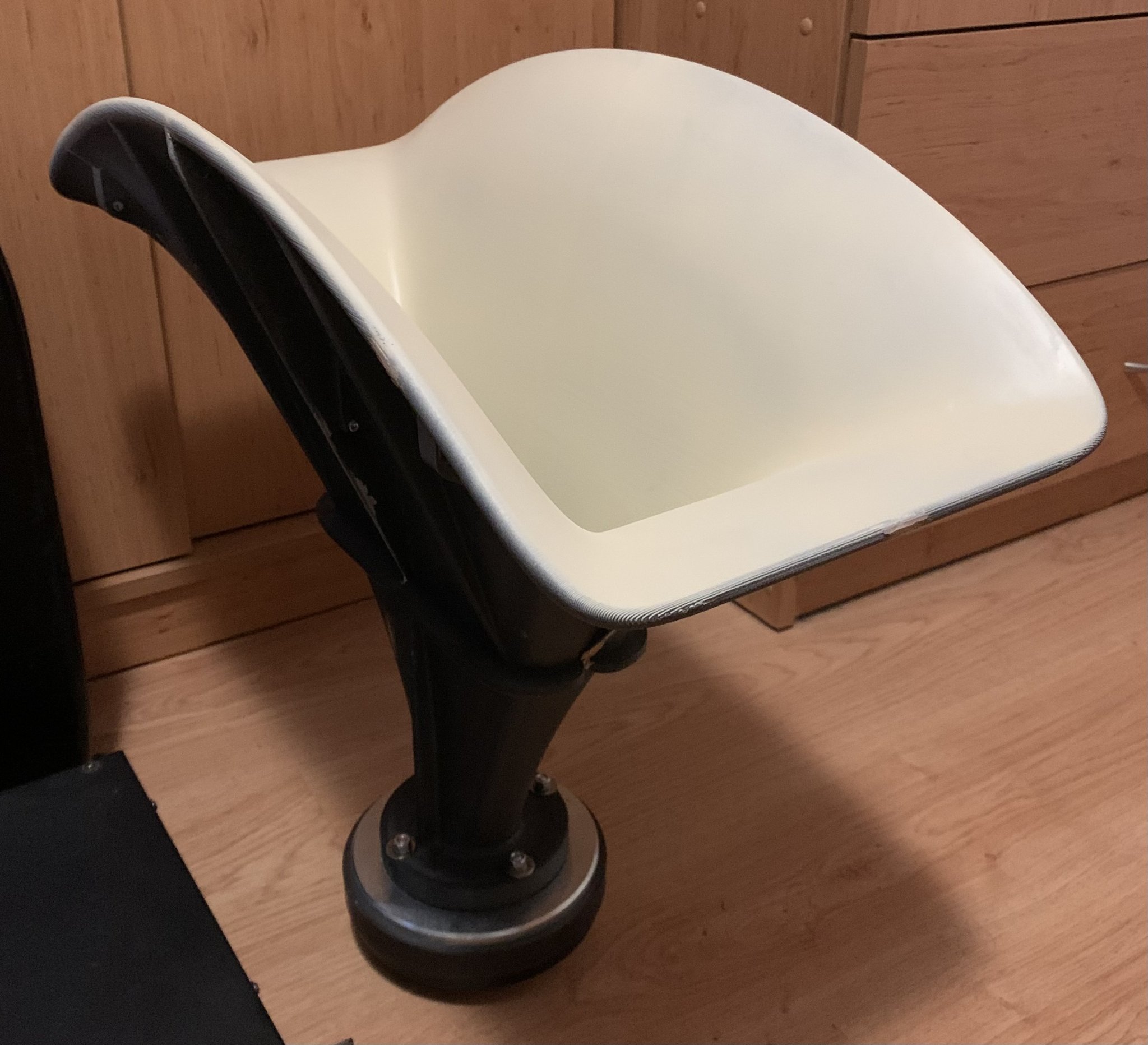

Just first impressions while filling today - it feels quite a bit stiffer than the first one thanks to the additional ribs. It also feels heavier although it really is not. The pre-work with the file on the edges and coating with putty will most probably pay back, the inside looks already much better now.
I thought there had been second (improved) version.

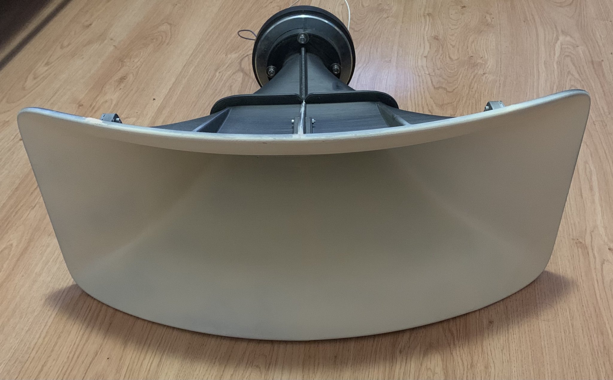

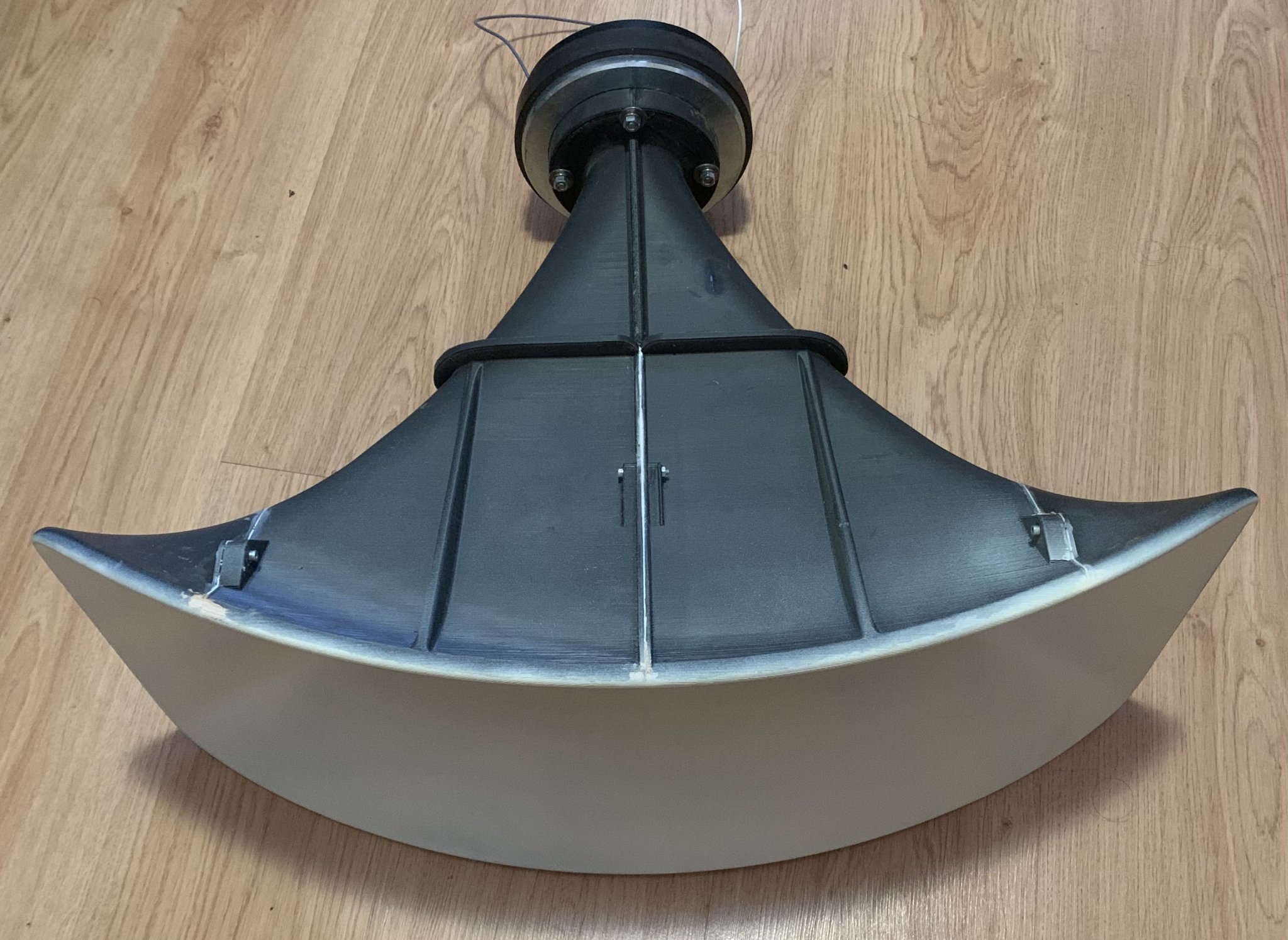

I have realized I have this horn unfinished. The inner surface was filled with acrylic putty and just one layer of acrylic spray paint, the walls are stil hollow (infill only). DE72 driver is mounted now. A knock test suggests, that the extra ribs were worth adding. Might still need some modeling clay around the mouth for ultimate damping though. I think I have found my favorite color combination for my horns.
Definitely not as nice or damped as the wooden ones, but should be enjoyable, too.
