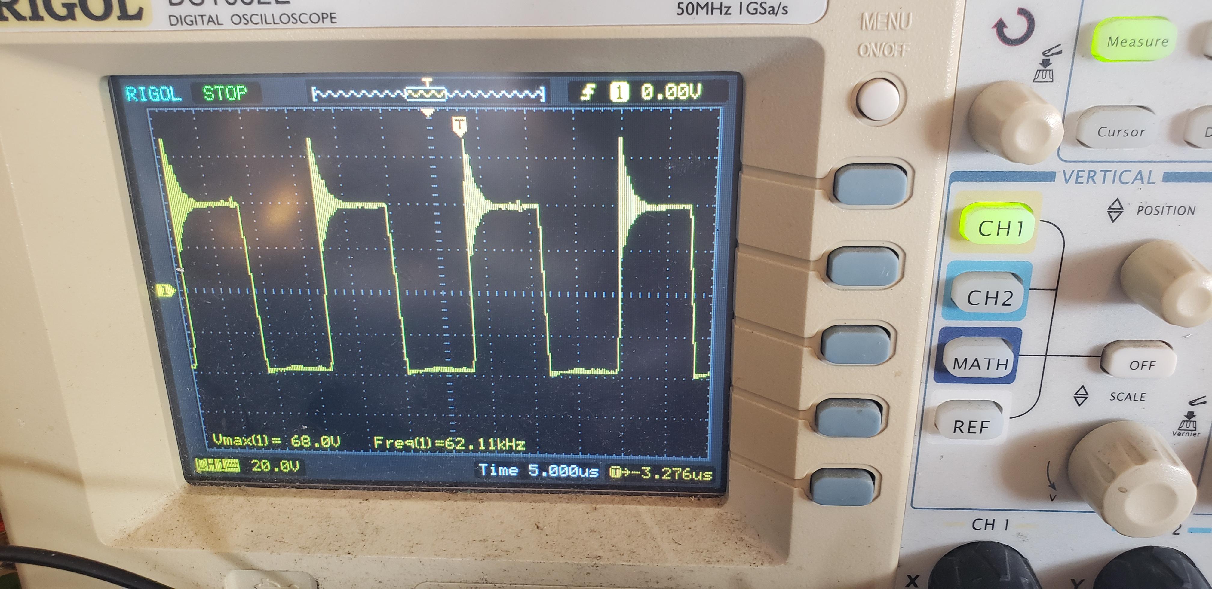

I tried to use 1.5k as CCS resistor. Then amp remain at 1.4amps but no drive signals at all. Then as soon I gave input it start to pull current and fets start to get hot.
I have RIGOL DS1052E.
I dont know much about differential settings. But I think I know we have to use math function.
It have good drive signals.
It's difficult to tell but I think that's OK. Differential mode would make it easier to see the drive signal alone with DC (important).

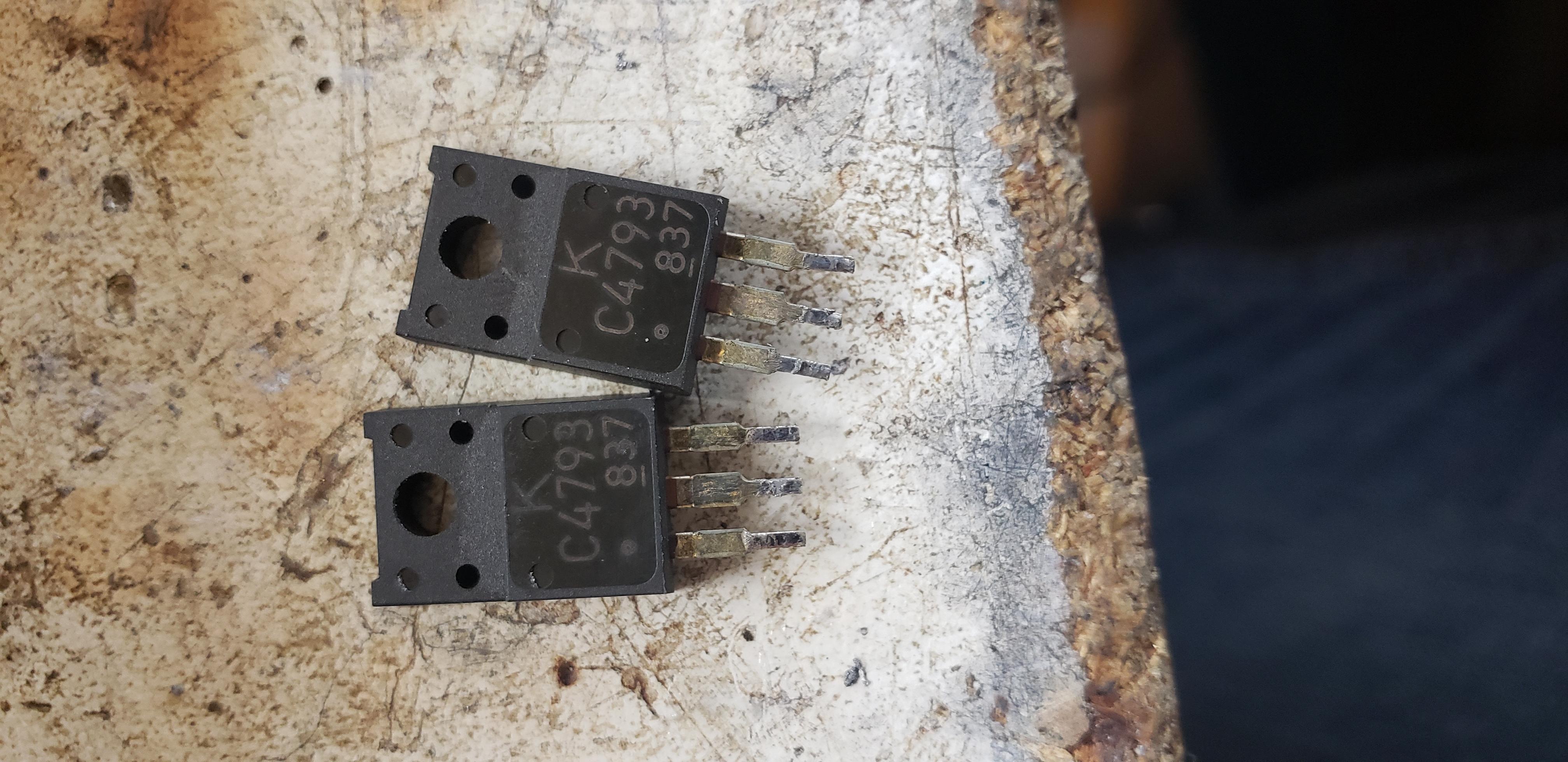

Is there any where I can buy smaller transistor version driver board. I have two amps with bigger version transistors and both doing the same thing. Dont know what to modify in the board and what causing it.
Install the smaller transistors in place of the larger final drivers, legs twisted and insulated to match the pin configuration. Try one first. You may have to make a few other minor changes.
I will change all to smaller ones and try it as it is. Then u will help me do the necessary changes. Thank you.

Yes I have the board. I compared the resistors and all matching good. Only thing I found is small board oscillating at 85khz frequency but this board is oscillating at only 65khz frequency.
But after changing big transistors to small transistors current draw reduced alot from 3.3amps to 2.5amps where as with small board it is only 2.1A.
