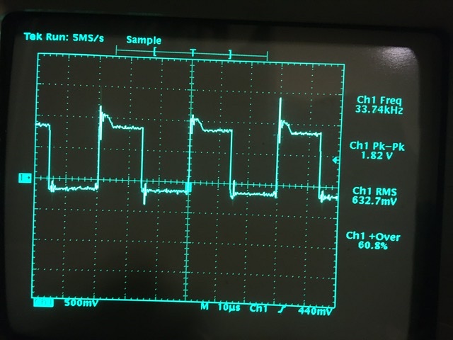

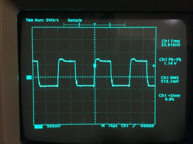

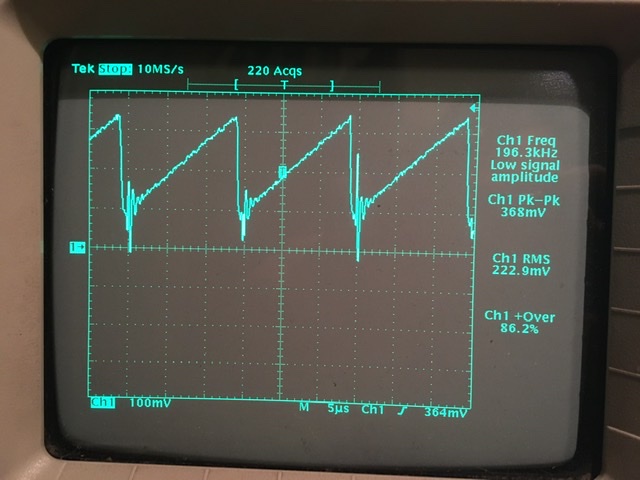

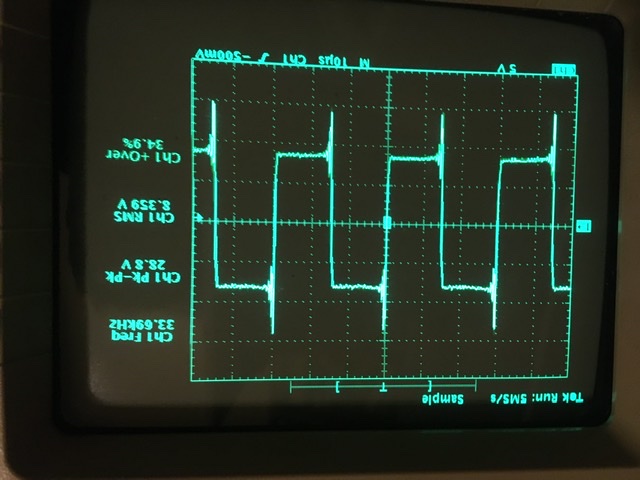

I tested the removed IRFZ46Ns in the transistor checker and only one is blown, with the rest re-installed in the board it powers up and the protection LED extinguishes after a few seconds.
It is producing rail voltage at the rectifier pads but exhibits terrible ringing, to the extent that the transformers and mosfets become warm after a few minutes of power up.
Tracing the drive signals back to the 3525A PWM controller and found that both the sawtooth wave on pin 5 and the square waves on pins 11 &14 exhibited ringing.
Is this a sign of a failing IC or could downstream components be causing it?
It could be Perry, I'm grounding on the Ground terminal block with a short probe lead though.
Is there some way I could check whether it is the ground or not, I've tried taking a measurement without the scope ground connected at all ( oscilloscope not isolated ) and with an there was no difference in the waveform.
The first image is the output from pin 5 of the IC.
The second image is the output from pins 11 & 14.
The third image is the from the leg of the MOSFET.
The fourth image is from the rectifier pad.

In my humble opinion, those waveforms are too normal.
Consider that this type of amplifier does not enjoy excellent cleaning and shielding, and sometimes even the transformers themselves, when they oscillate at high frequencies, radiate high-frequency noise in the surrounding area that can "disturb" your oscilloscope.
If I were you, I would replace all power mosfets with IRF3205 with 47 ohm r-gate and I would replace all drivers, even if they are ok.
The old ones might be enough, but since the irf3205 are a bit heavier to drive, a more robust driver could be a must.
The whistle of the transformers may be due to the defective drivers.
SG3525 hardly breaks, but it is not impossible.
Your signals, however, seem to me OK.
