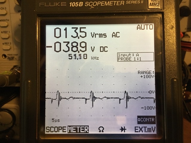

The waveform of the DC coming from the rectifier doesn't look very nice at all. (first picture)

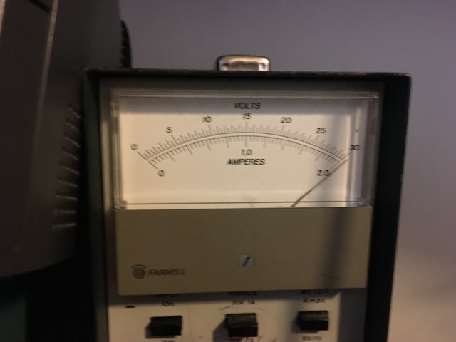

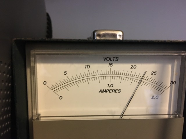

The second is that sometimes it starts up and draws 1.3 amps at idle and other times it starts up draws up to the 2 amp limit of the supply.
Wiggling components doesn't seem to make it go from one state to another.

The amp will idle at slightly less current if the output stage hasn't yet started to oscillate and sometimes it takes a bit of encouragement via an input signal to make it start oscillating.
Thanks Perry, this is more of an intermittent thing, sometimes it idles happily at ~1.5 amps and at others it draws as much as the supply will put out with seemingly little difference between the two in terms of voltages taken around the amp.😕
I'm getting rail voltage of ~ +-75 volts on the output section MOSFETS, it looks much smoother on the output side than it did on the PS side! 😱
I'm not getting much in terms of drive signal, I i understand correctly I am expecting a high frequency square wave of varying duty cycle, instead I'm getting all sorts of rubbish.
Moving the transistors on the driver board change the shape of the random waveforms I'm getting and so I think your advice to replace every transistor on that board anyway is the way forward here rather than fault finding.

Are you saying that you're not getting a rail-rail oscillation on the output transistors when driving a signal into the amp?
Others may have had other experience but Q124 and Q125 are the only transistors that commonly fail. I repaired literally hundreds of this type amp and they have a lot of issues but the driver board typically has problems with those 2 transistors.

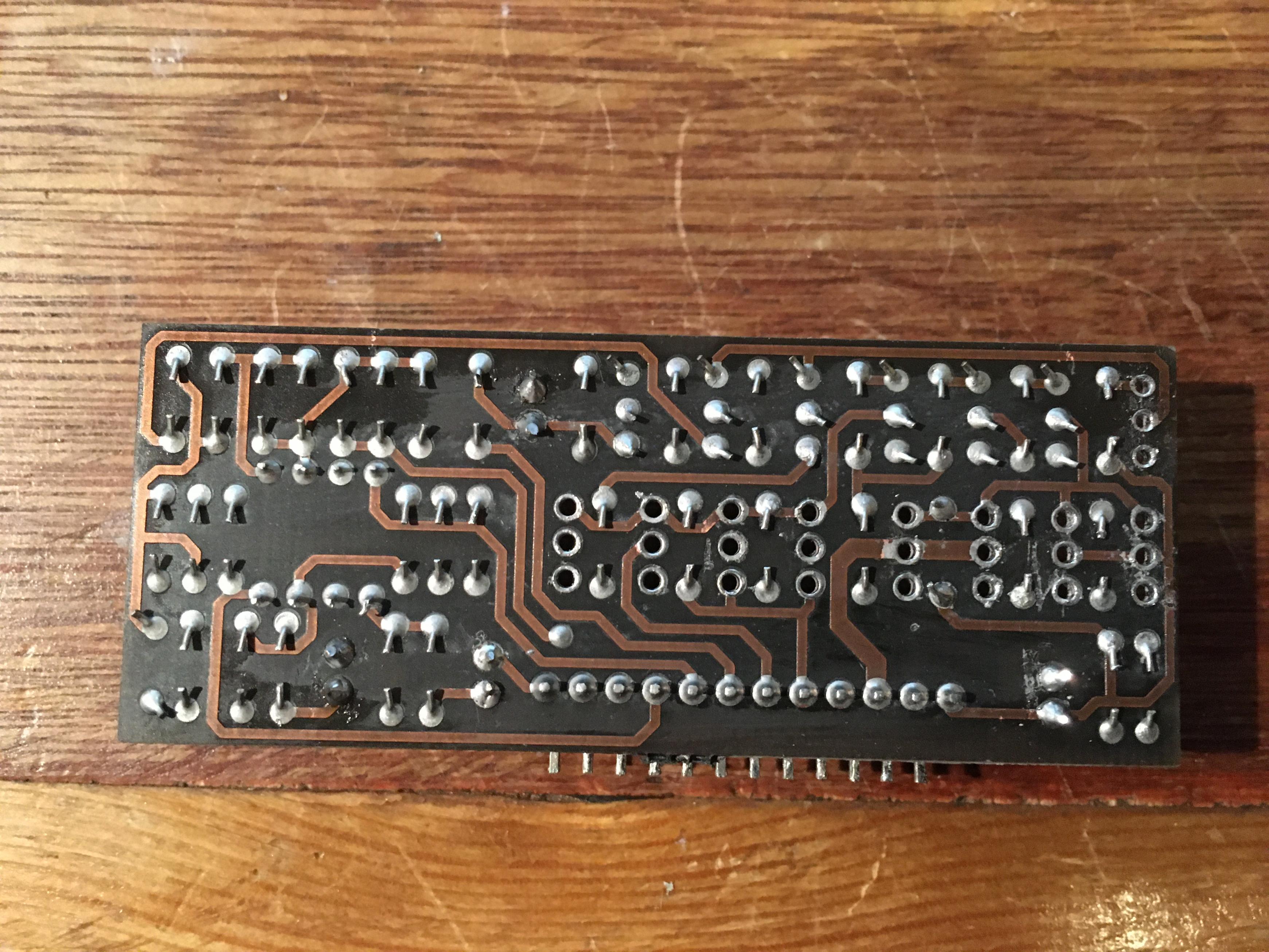

Success!
I found a dry solder joint on the back of the driver board, it was covered by some black gloop until I removed it, soldering it up and driving a signal into the amp at startup results in a drive wave on the gate pads of the output MOSFETs.
EDIT: Only the High Side has drive, the low side shows rail voltage - 7 v where the drive wave ought to be...

I've taken the driver board out and checked it over. The capacitors were 85C rated ones from "Kelna" and were quite bulged so I replaced them with low ESR 105C jobs.

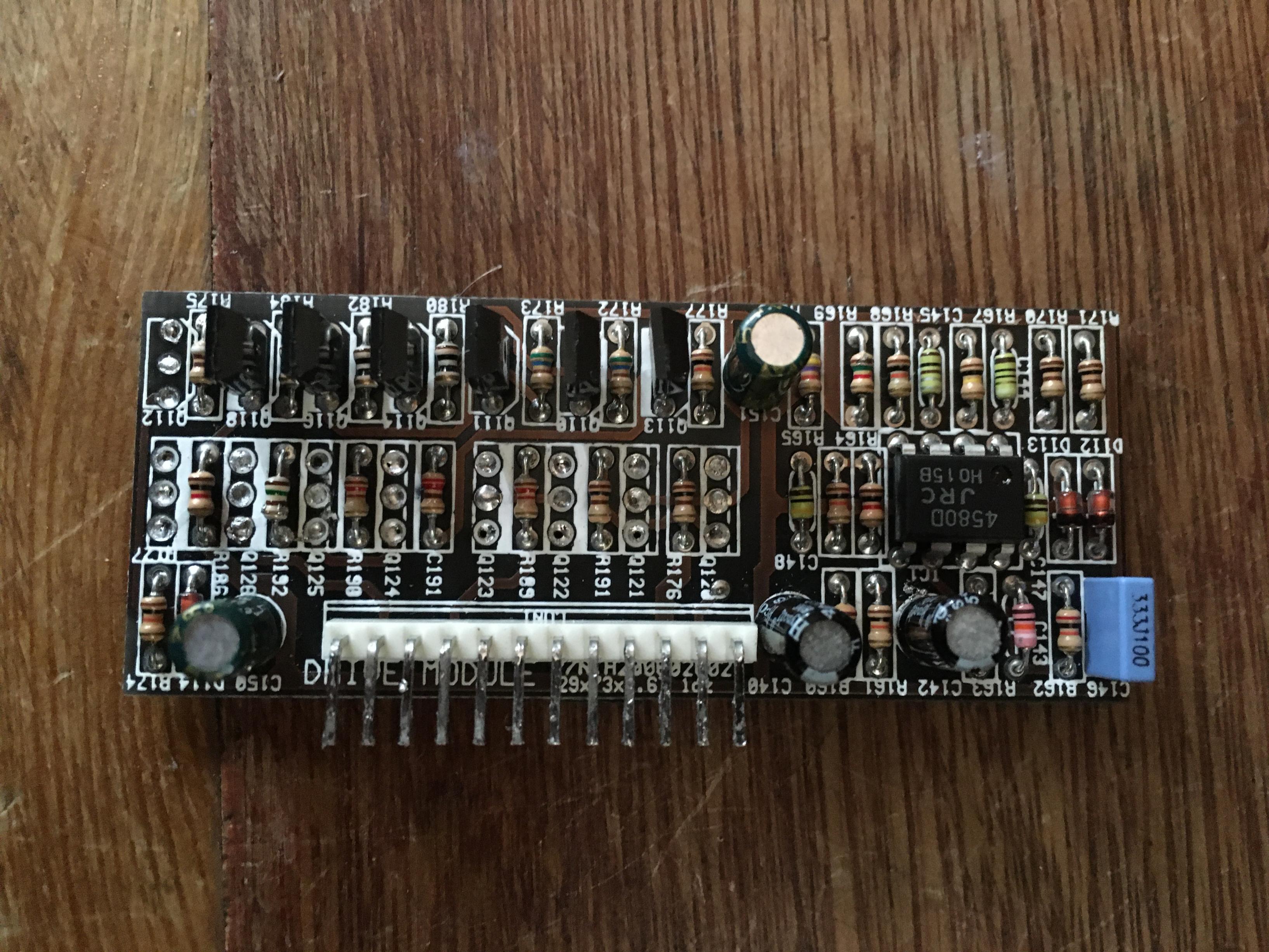

Hi Perry,
Apologies, I should have realised there would be multiple revisions of the board.

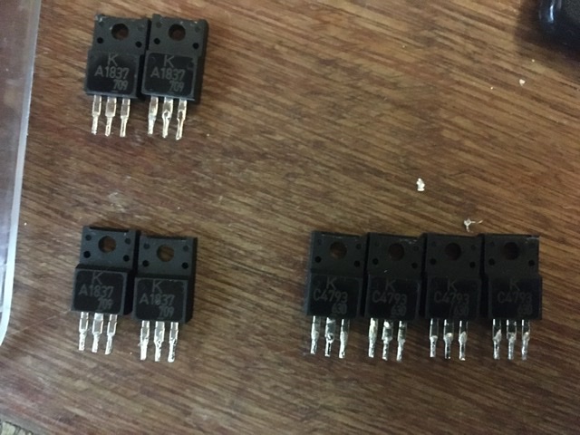

The board I have is as per the first photograph.As you predicted Q125 and Q 124 (KA1837 I think) tested weirdly as compared to Q126 and Q127 on the transistor tester, showing about half the Hfe whereas the four KC4793 transistors seemed very well matched.
Q112 was dead, I have removed it and am trying to find a replacement.
The small transistors Q110-Q1114, Q116,Q118 and Q110 were running extremely hot before I took the drive board out.
I am minded to replace the lot but it seems the 2SC3228 transistor of Q112 is hard to get hold of?
Should I replace them all and are there any easy to get hold of substitutions or upgrades that don't run so hot?
The bulged caps were C150 and C151, I have a box of capacitors and the spares tested better than the old ones which showed high leakage current and ESR.

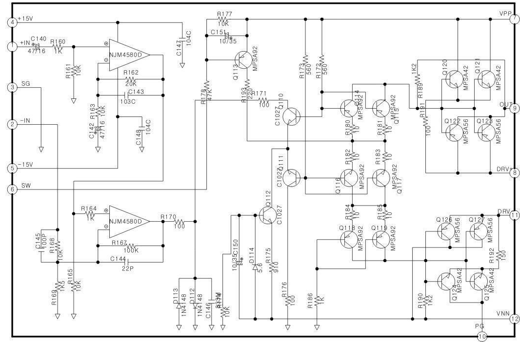

I don't remember seeing any of the large drivers fail but they do get bad connections.
Is Q112 in parallel with Q118?
I don't think so, it seems to drive Q110 and Q111, which are in parallel.
They appeared to rearrange the components in this version. It appears that the base of Q112 goes to the Zener D114. If so, it's not a critical part. Something like the KSC2690A should be a good sub.
See attached.The components are different but the circuit is similar.

If you have problems, I have a complete and functioning driver board in the laboratory (identical to yours), so if you need it I can help you.
I think I have the right order given the schematic Perry kindly posted above, I basically substituted the transistors on there with the transistors I have on the basis of NPN for NPN and visa versa with the transistors I had.
thank you for your offer, its very much appreciated and I may be bothering you for it my own effort ends in clouds of smoke... 😀
I have ordered two transistors to replace Q124 and Q125 as advised.
