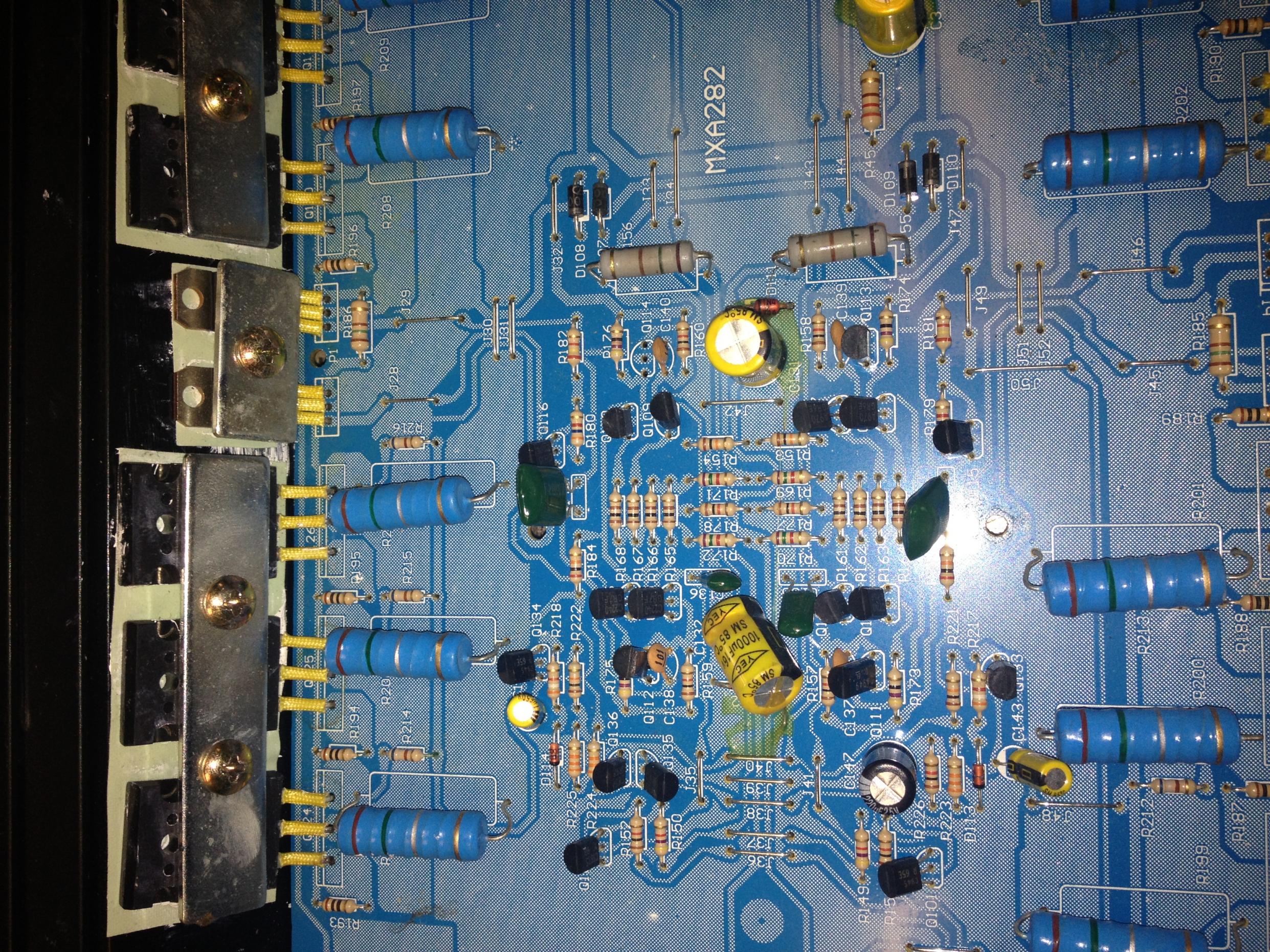

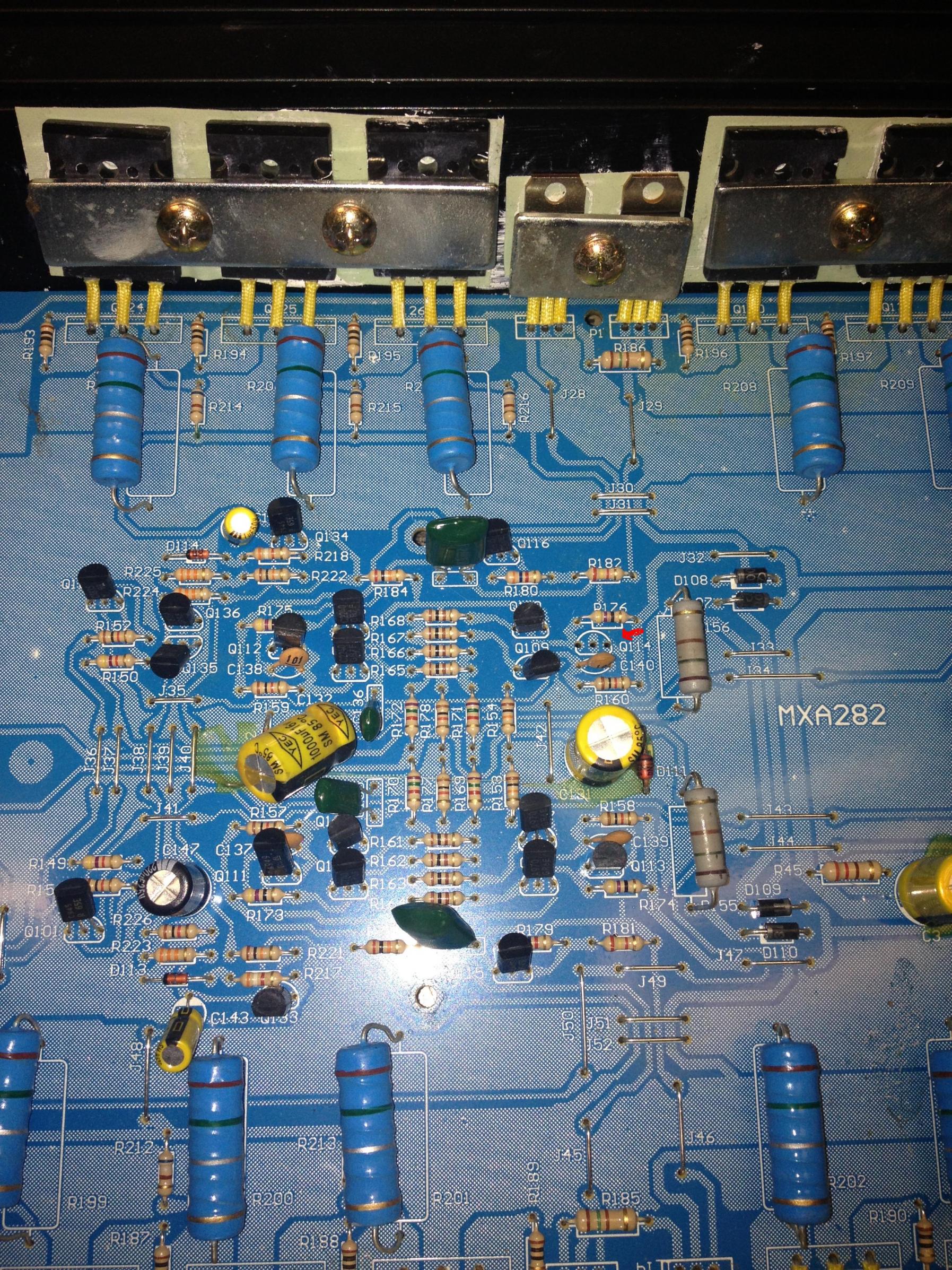

Post a good quality photo of the defective channel where all of the circuit board designations are legible.
heres a pic of the board..
If i remove transistor Q114 (red arrow pointin to it) The voltages will go back to normal on the drivers in the right channel and it will play clean audio but the audio is muted..
I replaced it with a new one and the voltage comes back..
Remove the transistor just below the circuit board designation R224 in the photo. Does that eliminate the DC on that jumper?
