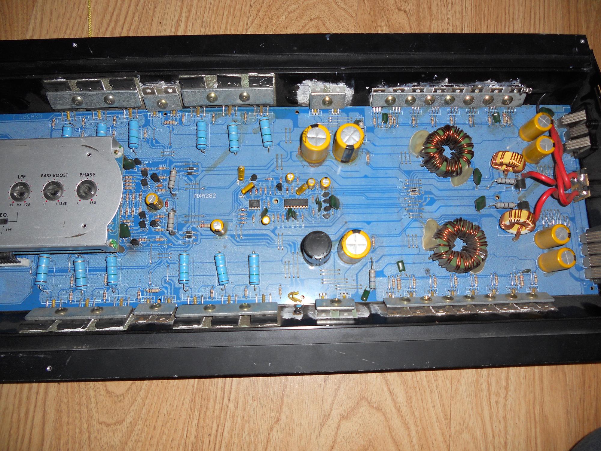

And as of right now, do you have the rest of the parts in the board and still have -rail on the output?
Is R176 within tolerance?
All of the parts are in the amp..
R176 measures 4.65 ohms
I have 51 volts of rail on the right channel outputs The voltage is positive rail..
Post the DC voltage on all 3 legs of the 4 differential amp transistors. You may end up needing to post the voltage on virtually all of the transistors but we need to start with these.
The 4 with their emitters connected to the 4 100 ohm resistors in the middle of the channel.

A970
Leg 1:-2.98
Leg 2:-4.26
Leg 3:-3.59
A970
Leg 1:-3.11
Leg 2:-52.1
Leg 3:-3.71
C2240
Leg 1:-4.27
Leg 2:-4.27
Leg 3:-3.60
C2240
Leg 1:-4.34
Leg 2:-4.33
Leg 3:-3.72

The center legs of those transistors should be near rail voltage. Follow the traces back. You likely have a bad solder connection on a jumper. Don't just resolder them. If you have a bad solder connection, you need to remove the jumper, scrape it until you have clean copper then replace it. If it's easier to use new wire, do that.
